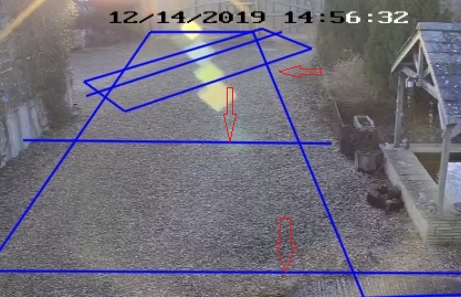

N nesswill Active Member Messages 40 Points 8 Dec 14, 2019 #1 Hide smart event area markers (in blue) is there any way so you don't see them?? Thanks Attachments smart event.jpg 57 KB · Views: 272
N nesswill Active Member Messages 40 Points 8 Dec 15, 2019 Thread starter #2 Sorry did I ask a silly question? its just I can not see how you do this. Thanks.

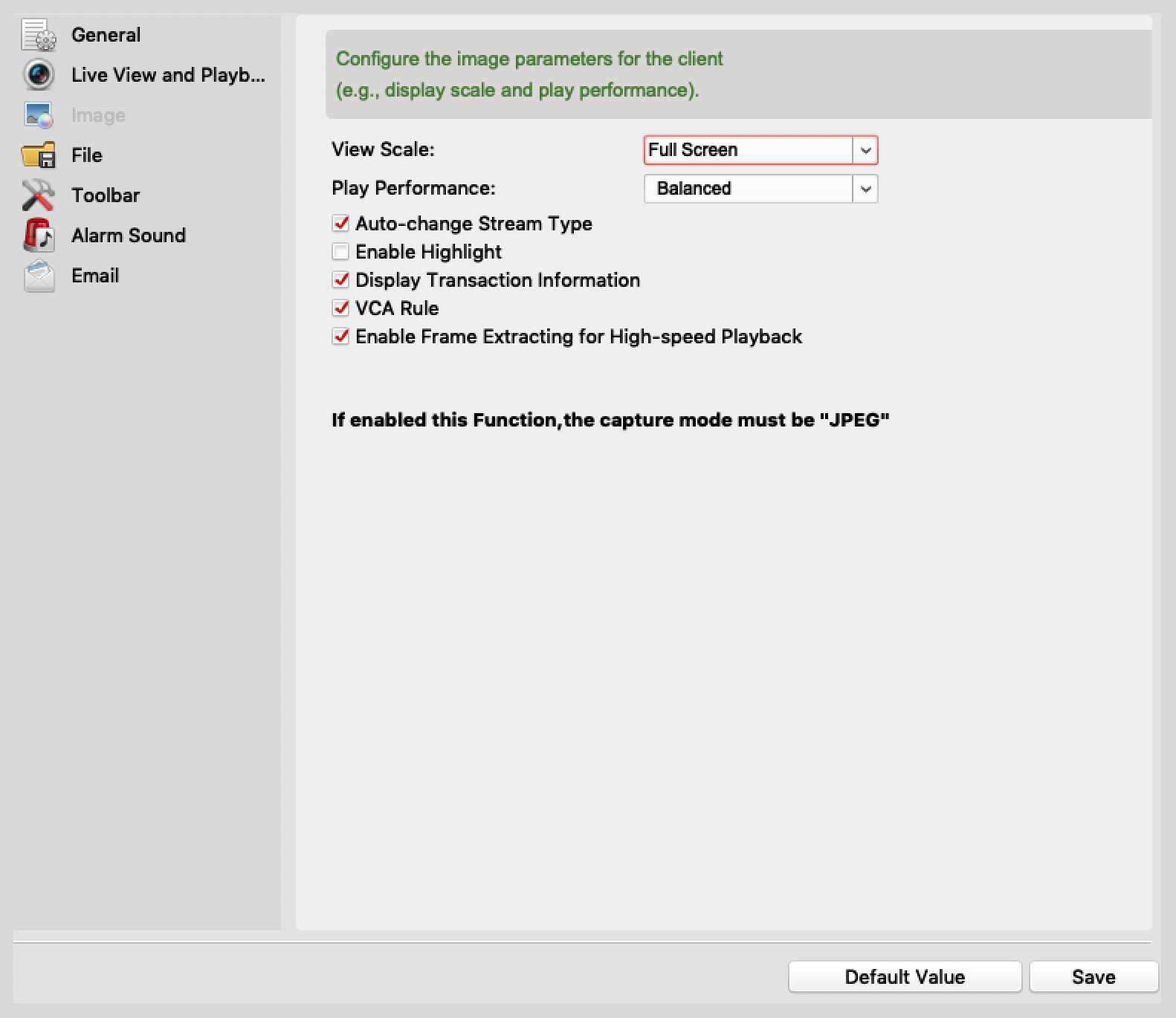

Dan Administrator Staff member Messages 4,632 Points 113 Jan 7, 2020 #4 nesswill said: Hide smart event area markers (in blue) is there any way so you don't see them?? Thanks Click to expand... Apologies for the slow reply, if you go to image settings in System Configuration you should be able to disable VCA Rules (see below) which should remove the Event picture overlay that you see on the live view.
N nesswill Active Member Messages 40 Points 8 Jan 9, 2020 Thread starter #5 Thank you Dan that did it!!
