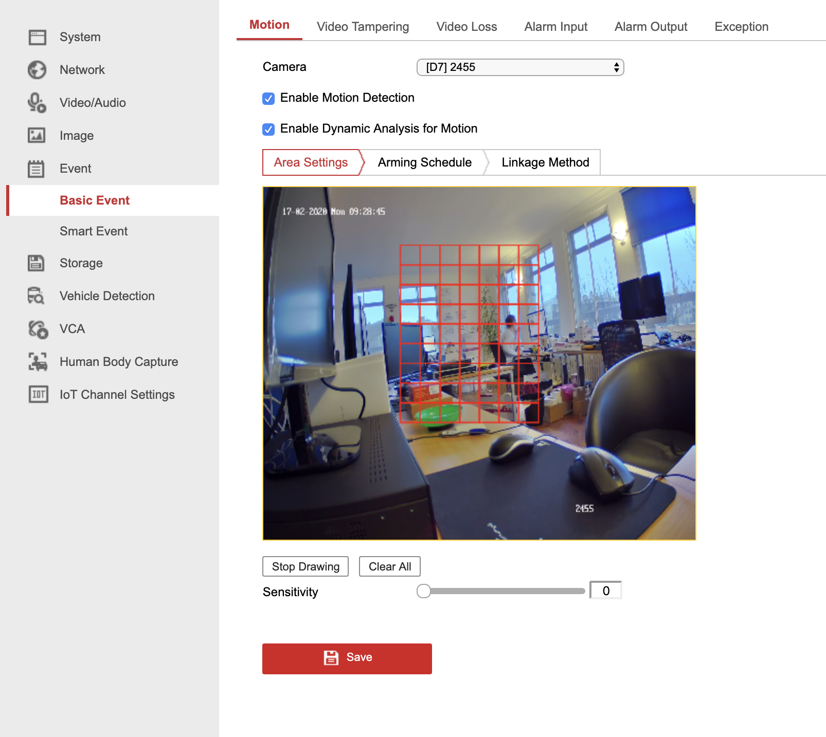

Traditionally to record by motion, we recommend that you set the record schedule to just Motion and not Motion|Alarm and then you also need to make sure in the Basic Event Settings that motion detection is enabled and set up correctly. (see below - for better accuracy we recommend reducing the area of detection and adjusting the sensitivity)
