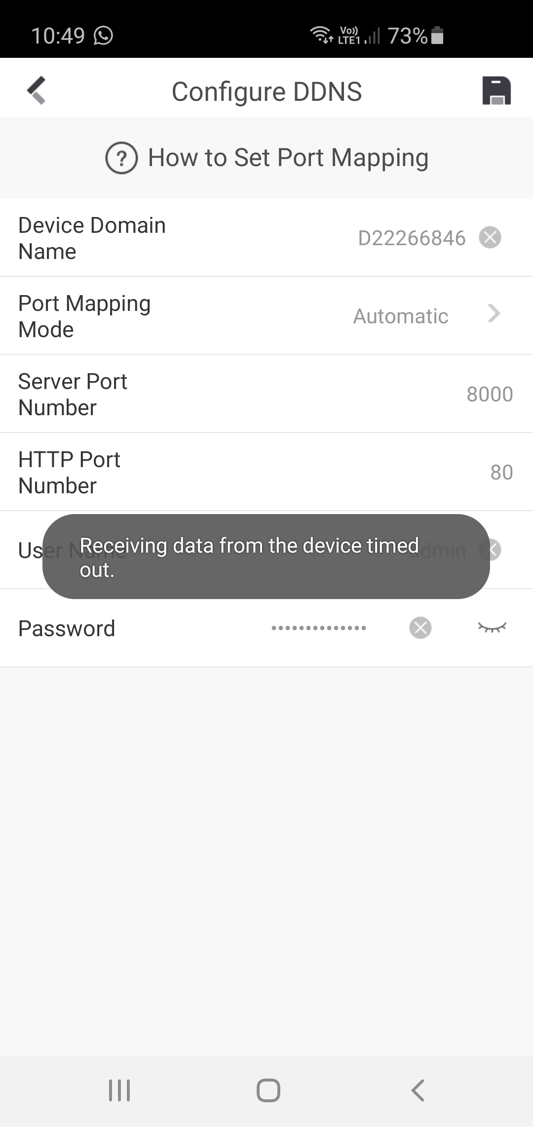

If you are using the Hik-Connect App you only need to add your NVR to the Hik-Connect portal (not the cameras).
The most surefire way to do so is to login at www.hik-connect.com and enter its serial number.
For Hik-Connect you do not need to set up any port-forwarding.
You can copy & paste screenshots / images into your Posts here if anything looks wrong / for us to take a look at your config setup.
Hi, I have done the above but I still can't get remote access to work. I've added a pic of the message I get when I try to set remote access via hik connect app.
I also never receive notifications despite the fact they are turned on
