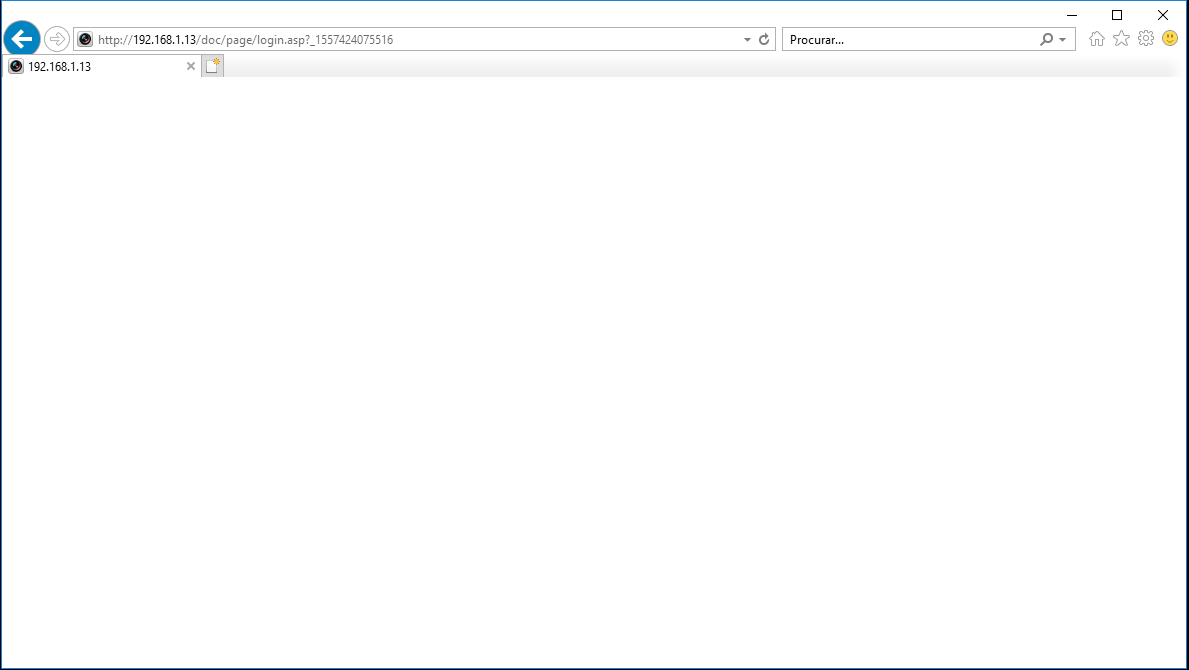

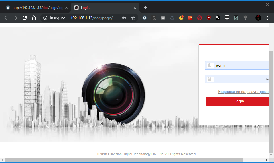

Hello, so i was trying acessing by google chrome and after installing the extension and Webcomponets it dont works.
In google chrome i get this error:
"IE: Error: Error: This is not a property claim. Source:
http://192.168.1.13/doc/script/lib/webSession.js?version=V4.0.1build180815:1 "
If i try to open in internet explorer the page stays white.
Tested in other pcs and it worked.

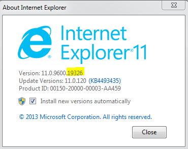

Are you on the latest version of IE11?
2183

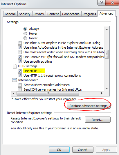

Check if Use HTTP 1.1 is ticked. As a last resort you could try Restore advanced settings
2185
