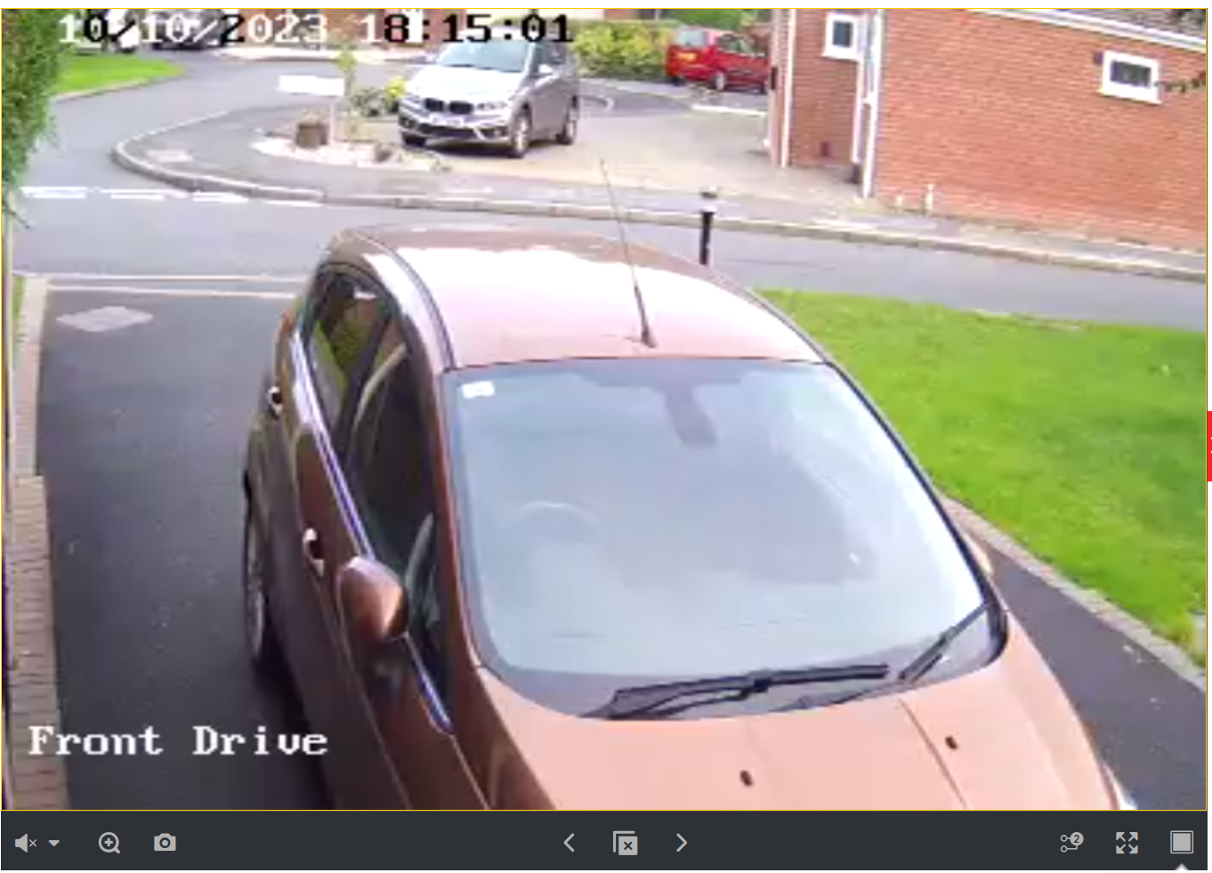

I have the Picture capture icon at the base of the window but not video record icon.
What do I need to do?

I use both FIrefox and Chrome browsers and also with both Windows10 and Linux Ubuntu and I get the same result with both,
I attach screen shot using windows10 and Chrome for reference.

The button you are looking for is the video camera icon in the bottom right of the live view window, if you click that once it will turn red to show that live view is being recorded, click it again and the recording will stop and be downloaded to your chosen file location (file location can be set in the local menu).

I have just found the Record icon on the lower right hand side of the window using Windows10 and Chrome.
Thanks for the nudge in the right direction for the solution.
