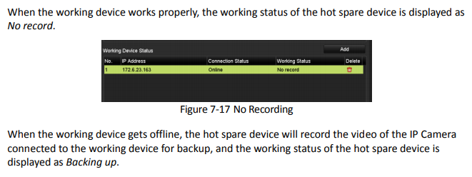

My understanding is that the 'Hot Spare' only actually begins recording and takes over from another NVR when that NVR fails.
You will note that one hot spare can be the standby for up to 32 running NVRs.
And, that when all the normal working devices are running normally, the Hot Spare sits there NOT recording.
