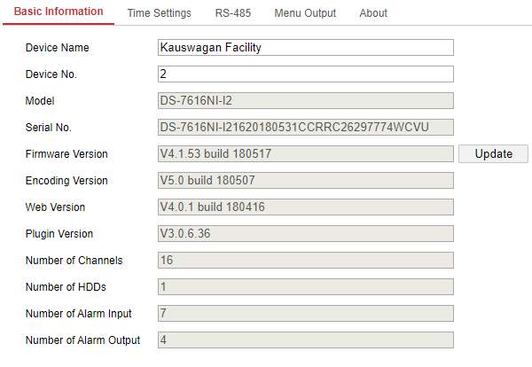

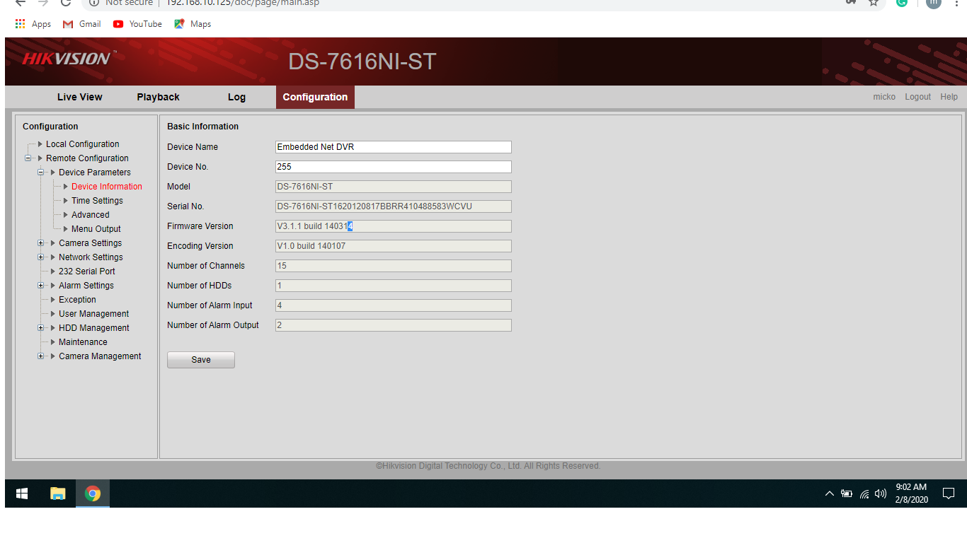

Sorry, my bad wrong NVR firmware actually I have 2 NVR, ds-7616NI-ST is the older one.
No worries :) The first thing you'll need to try then is follow this link to download the latest firmware release for the NVR. You're currently running an outdated version. Hopefully this will fix the issue, let me know how you get on!
You should be able to but you probably won't want to revert back to your current firmware anyway as it's so old, the purpose of the updates are to fix any problems people are finding while running older versions. If you have problems with the update then what you might need to do is install each update between your current (V3.1.1) and the most up-to-date (V3.4.4) step by step, rather than jumping straight up to the latest. See how you get on with jumping straight to V3.4.4 though as I suspect this won't be an issue and will fix things.
