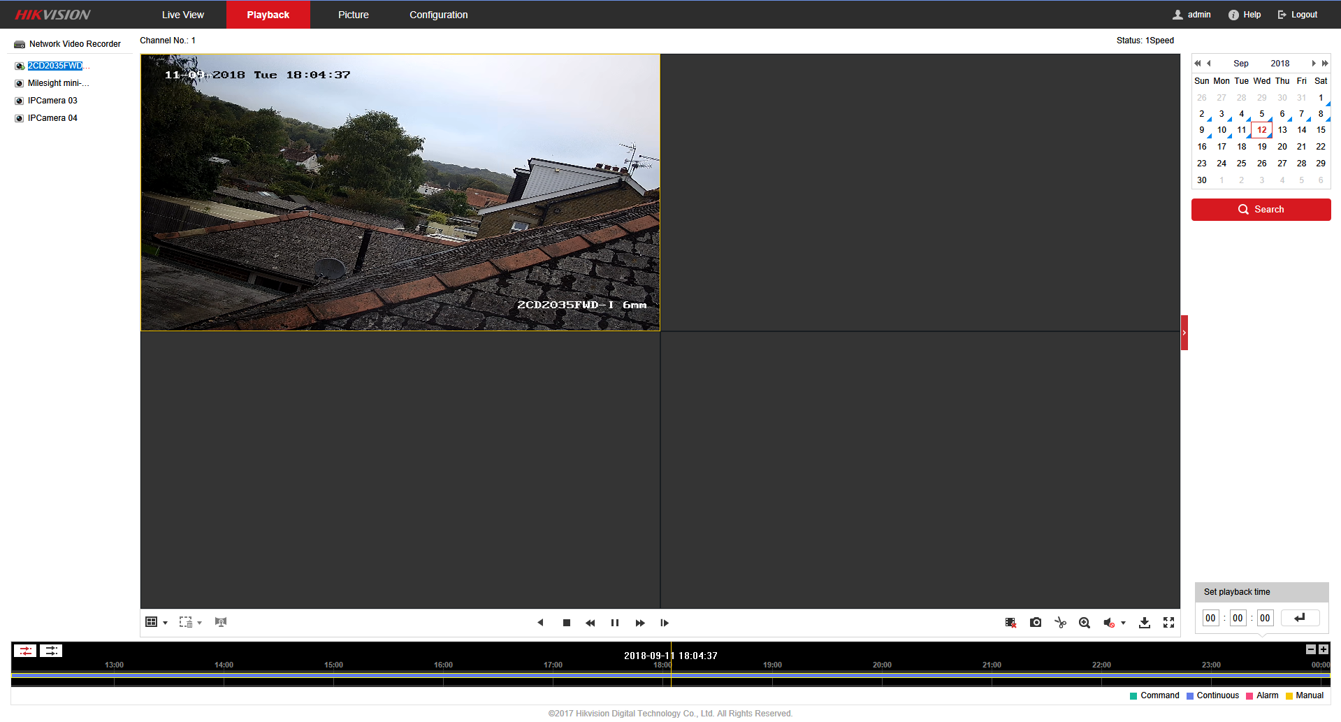

It is still possible to snapshot from a browser, and if you can't access via a browser and you desperately need a snapshot you may have to export a short video clip, load it on a computer and then screenshot the moment from the playback that you require.

Yes thanks Dan, I have the web browser version set up and have got it working so that I can get screenshots that way. I am new to this, but it seems to me that it would make a lot of sense if the feature was available directly on the unit itself as well, with the fancy smart search/line-crossing etc. facilities!
