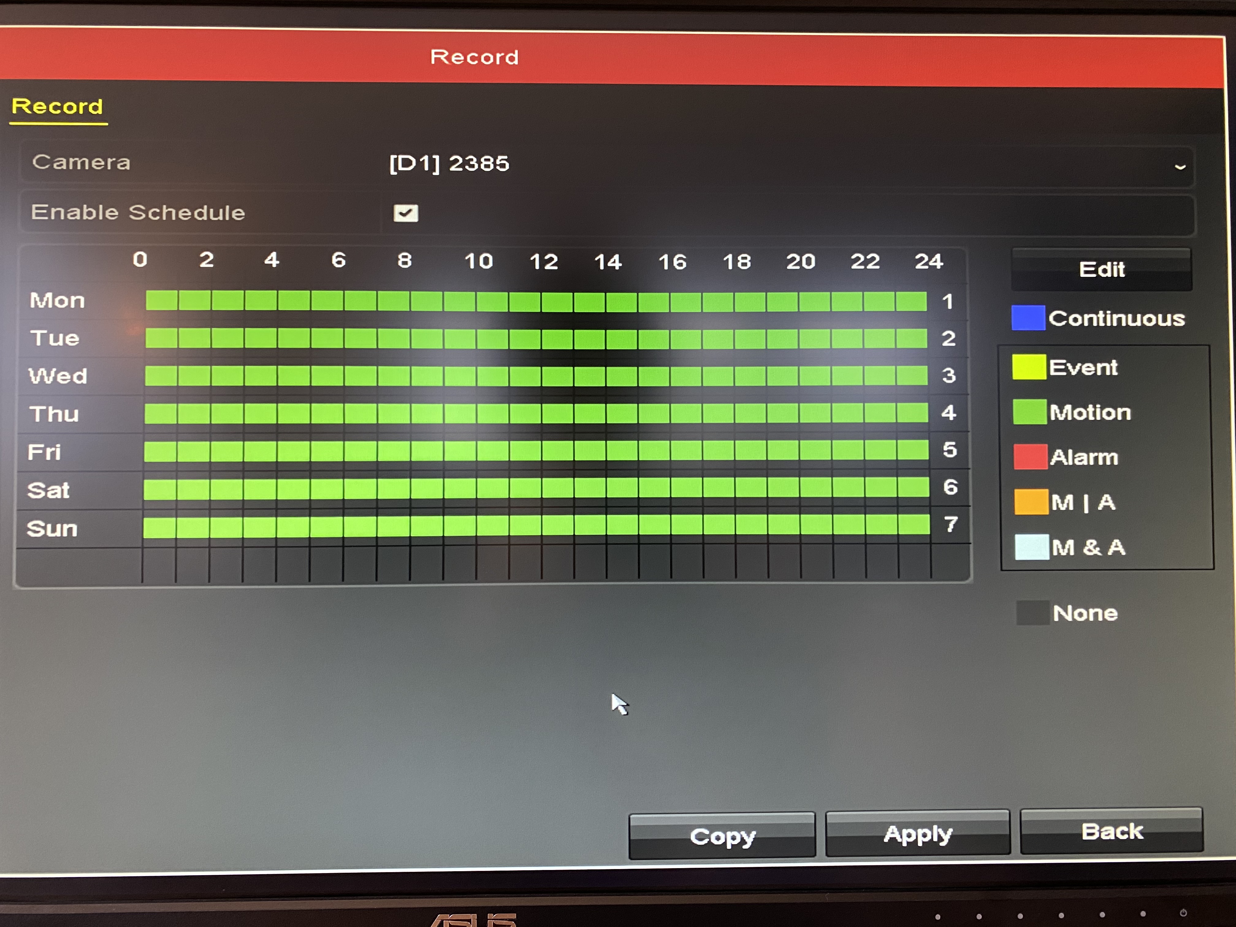

Have you definitely set the recording schedule so that it's constantly set to 'Motion' and not 'Continuous', so it looks something like this below?

I am assuming you mean setting the NVR to Motion recording, I assumed that setting the NVR recording to motion was for if you are using the NVR’s motion detection , where I want to use the cameras motion detection to prompt the NVR to record, I will try this thank you
Yes sorry, wasn't the clearest wording! The motion detection feature is unique to the cameras, the NVR's don't actually have it, they just process and handle the camera's motion detection. Let me know how you get on :)
