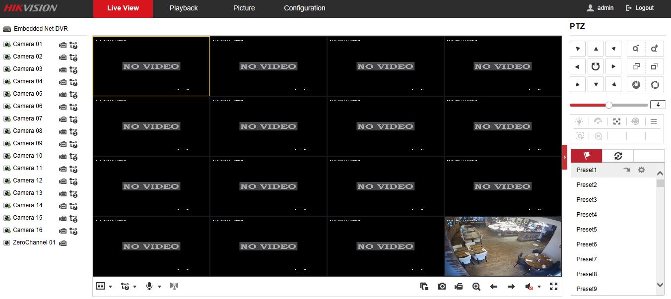

A friend has asked me to take a look at his Hikvision ds-7216huhi-k2 he has a channel DVR with 16 analog cameras plugged in but only one camera seems to be working.
I can change the working camera around to other channels and it works but other cameras just state No Video, please see attached screenshot.

The DS-7216HUHI-K2/P supports power over coax. Depending on which model your friend has, either the built in PSU has failed or if the DVR is the non P model, he likely has an external box PSU which has failed.
