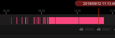

I have a Hikvision DS-7216HGHI and for the past few months has been missing gaps in recording, so in ivms it will jump randomly.
It tends to have bigger missed blocks during the night with no movement, but is still quite random as even though there is activity some blocks will be missed during the day. 13 cameras and they all have missing blocks.

Looks like this might be sorted. It seems at some point a new version of ivms was installed on a users computer, which possibly changed the recording schedule to an alarm template which was linked to motion detection (although the motion detection is very poor) with the recordings in pink. This has been changed back to the all day template and is now recording in blue blocks.
