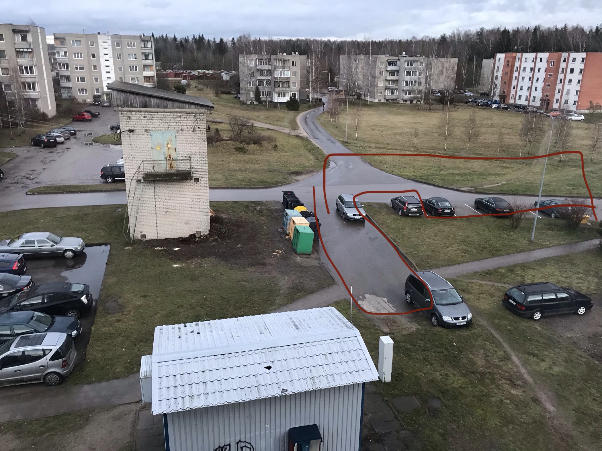

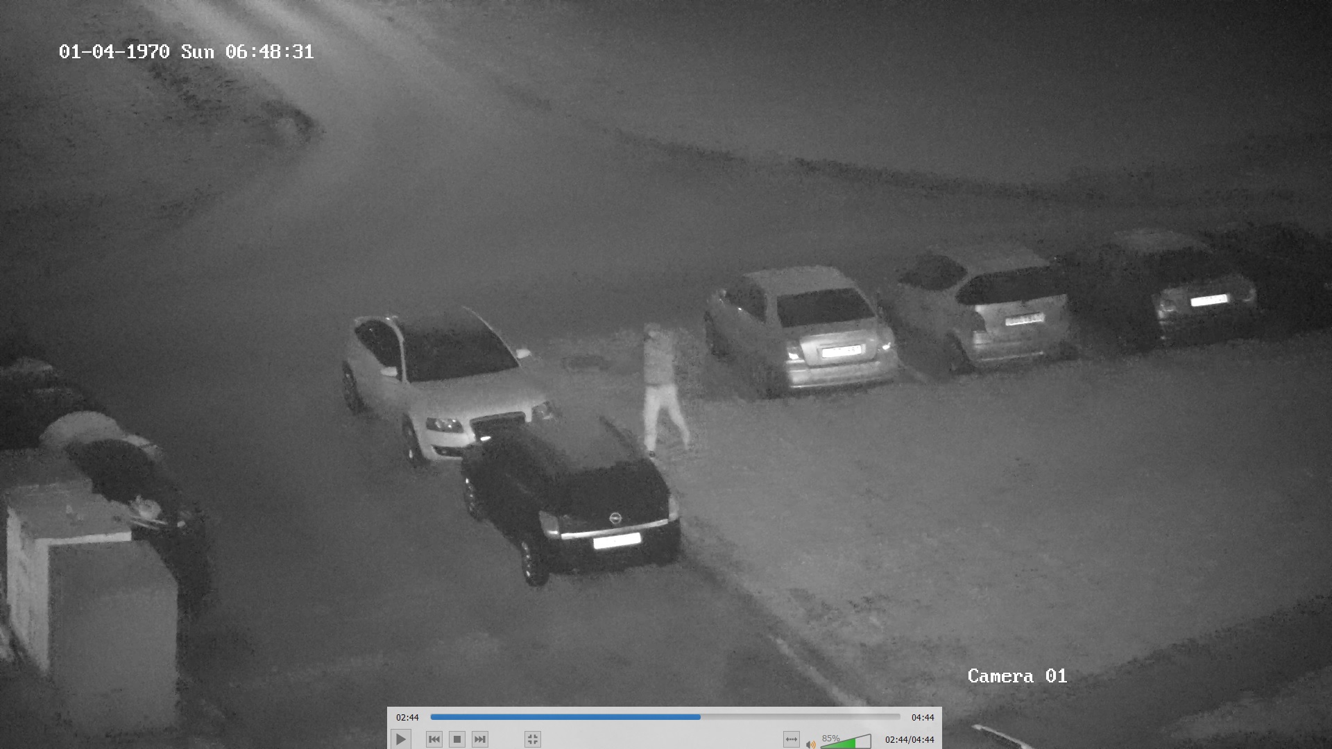

Bought Hikvision camera with model written in title with 12mm lens. When connected I spotted that video record so poor, I didn't expect it. Is there any settings need to be changed?
Some information:
Living on the 4th floor, SOMETIMES street light at night is turned off, sometimes it's on. I want to catch on the video a thief that steal car mirrors and etc.
I will attach a photo with my field of view through the window at a day and a video's screenshot with poor quality. Also, you can recommend me other outdoor camera that will record a video with better quality at a night time.

You would need a much longer focal length to be able to render useful images of that area from your position.
I would suggest a PTZ camera with 25/30x optical zoom.
You will also of course need to select a model with an adequate IR range.

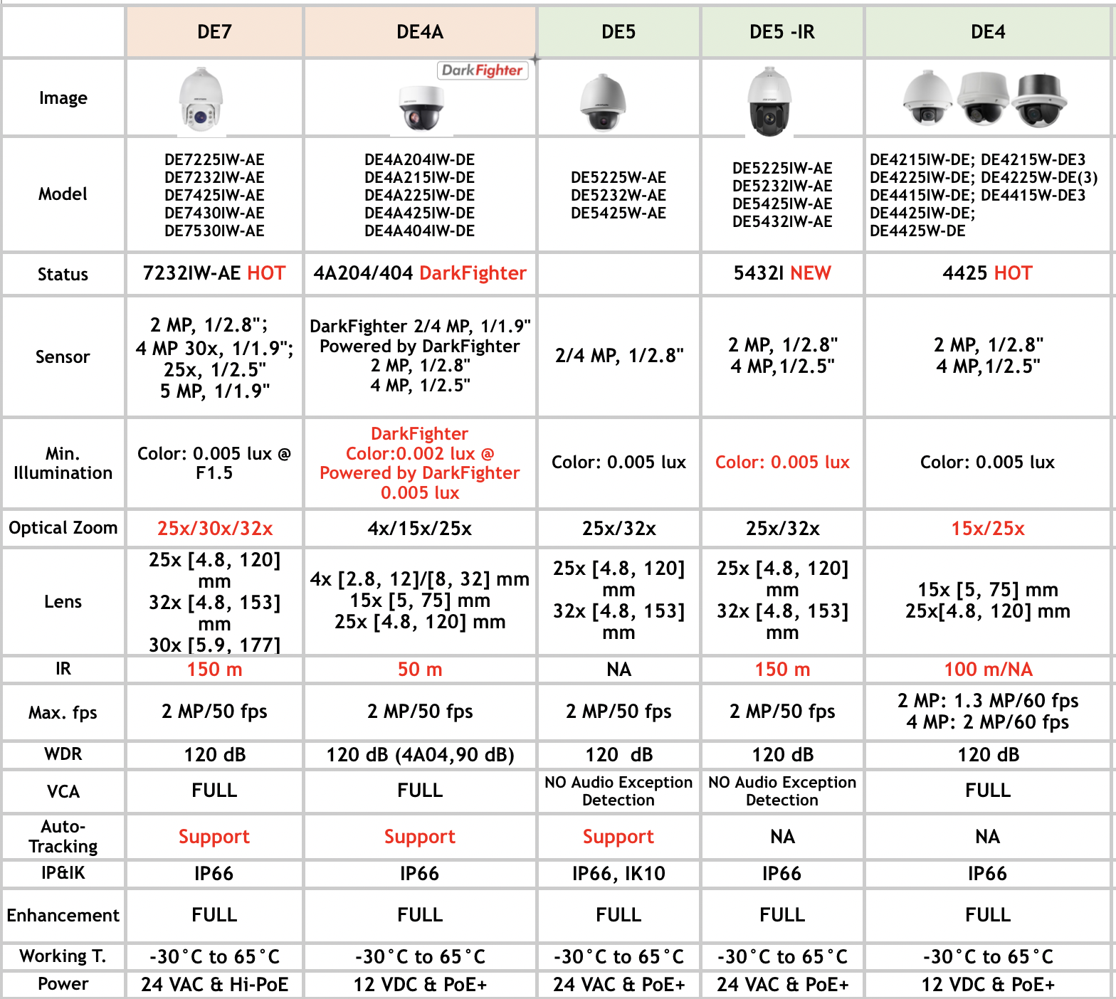

See the below PTZ spec table, all 3 of the models you are looking do NOT support auto-tracking.
It is only the first 3 ranges shown above (DE7, DE4A, DE5) that support auto-tracking.
Ok then. So there is no big difference between Hik 4225 and 4425? The only difference is that one has 2MP and the other 4 MP?
Yes, that and the max. fps are the only key differences. You will see it says that that the 2MP model can only achieve 60fps at 1.3MP while the 4MP can do 60fps at 2MP.
