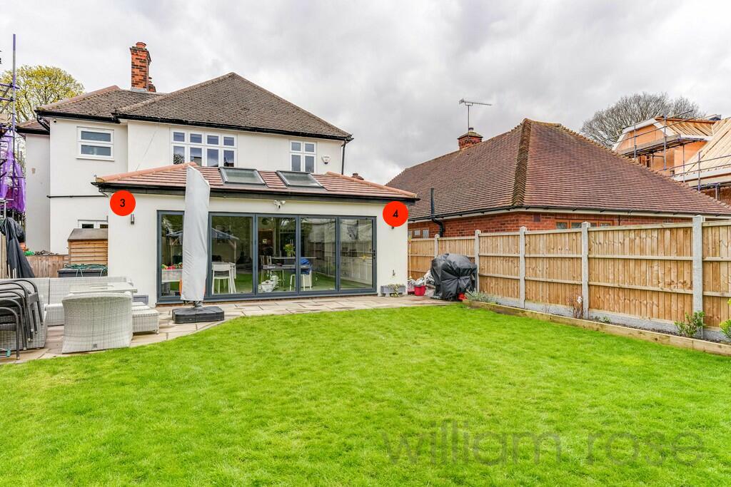

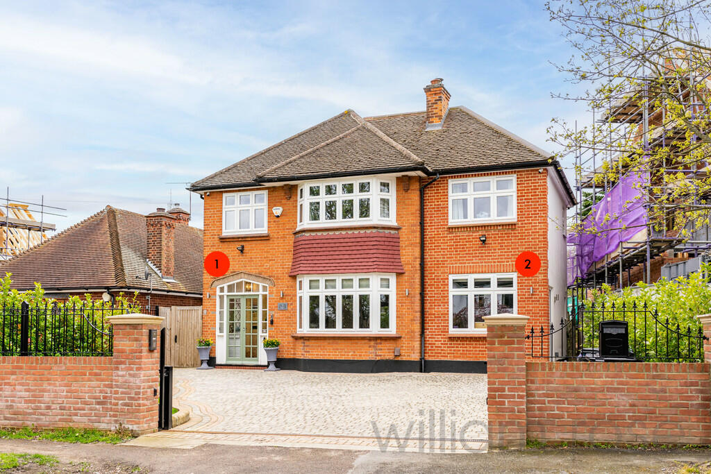

Below are few pictures of a house I found on right move that is the same layout as mine. The only difference is I don't have a side alley on the right hand side of the house and my Extension is the full width of the house so I haven't added cameras down the right hand side in my layout
Are the camera locations I am proposing right? are 2.8mm ones fine for what I am looking at or should I be getting a 12mm lens one above the front door?
Will also be getting a doorbell as well so maybe that would be best for capturing faces near there? all the walls are currently stripped and waiting to be plastered so I am planning to run the cat 6 cables to these locations next week. thanks for any help in advance.

Hi @NewbieCCTB
Your proposed positions are good :)
If you are concerned about cameras 3 and 4 getting vandalised, you could mount these higher up on the first-floor wall behind where you currently have them, but you would need to use a longer focal length (probably 6mm or a varifocal camera) to keep the roof out of shot.
The other cameras should be installed at ~2.5m+ to keep them out of a person's reach too.
For the front and back of the house, you will have better coverage if you combine a 2.8mm and 4mm camera rather than have both with a 2.8mm lens.
The 2.8mm FoV is wide enough to cover the width of the property on both sides, so it is best for capturing anything near the house, but the 4mm will provide you with a sharper picture at the back of the garden.
For cameras 5 and 6, 4mm models with rotate mode enabled will probably be best:
I'd advise mounting the alleyway cameras at slightly different heights too, as this will avoid blinding each camera with the other's IR LEDs at night.
If you're going for a doorbell with a wide FOV, then I'd recommend putting the 4mm camera on the front of the house on the same side as the doorbell, as this will be covering the space near the door as you say.
