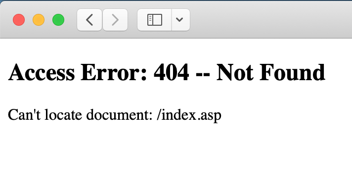

What exactly do you mean by "cannot access the camera"? Can you log in to the camera but can't access any settings or can you not even reach the login page for the camera?

  2. I cannot reach the login page for the camera, see screenshot.

Thanks @Murfy92

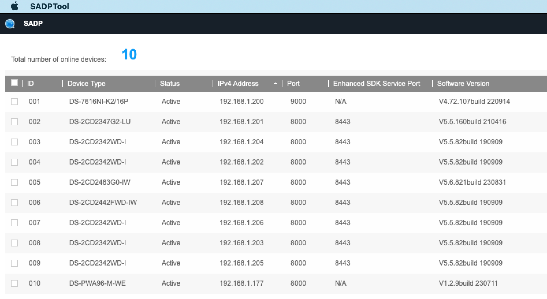

Can you share a screenshot from the SADP Tool showing the IP addresses of your NVR & cameras?

Thanks for reply
  1. I've tried different browsers Safari, Edge, Chrome and they all give the same error page.
  2. screenshot attached
  3. For my 2347G2-LU I'm trying to set-up 2 way audio
  4. For my 2347G2-LU I'm also trying to set-up so that I can hear the audio in the playback.

Thanks @Murfy92
So the reason why the firmware wouldn't update via the USB stick is that the firmware you linked above is not the correct one for your model.
The firmware you linked above is a G5 Platform firmware for the newest hardware/software version of your camera, which usually has a (C) at the end of the model number to denote being a G5 model.
Your model is a 1st-gen model and uses the G3 Platform Firmware (see your version in this firmware portal folder) and the latest firmware for your model is 5.5.801_211105
If you try updating the camera via USB stick using this firmware then it should work.
