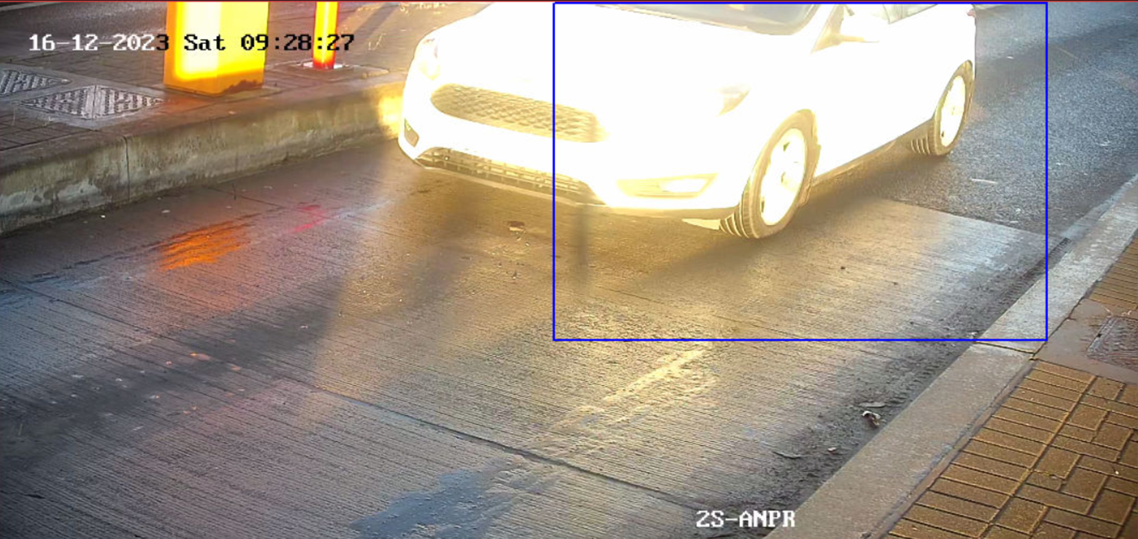

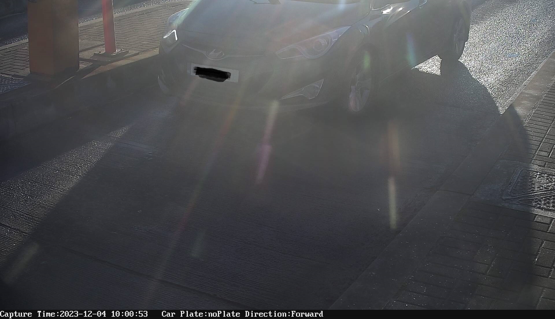

I am experiencing an issue with some of our Hikvision LPR camera's where at a certain time of day ( 9am - 11am in the morning) the glare off the road is playing Havoc with the cameras ability to do OCR. Other times of day its is fine and the read and accuracy rate is high. But during the morning the read rate is quite low.
What can I do to rectify this?
See attached image for example

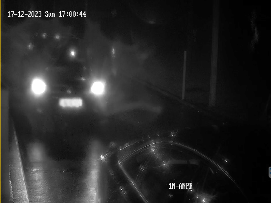

And if its not glare then its rain
Really need assistance in how to set these cameras up to work in these weather conditions

We would recommend adjusting the rain/sun shade on these ANPR bullet cameras to be as far forward as possible to give more shade to the camera lens.
If that is still not enough, then you will probably need to look at creating larger custom shade/protection to go above the cameras.
