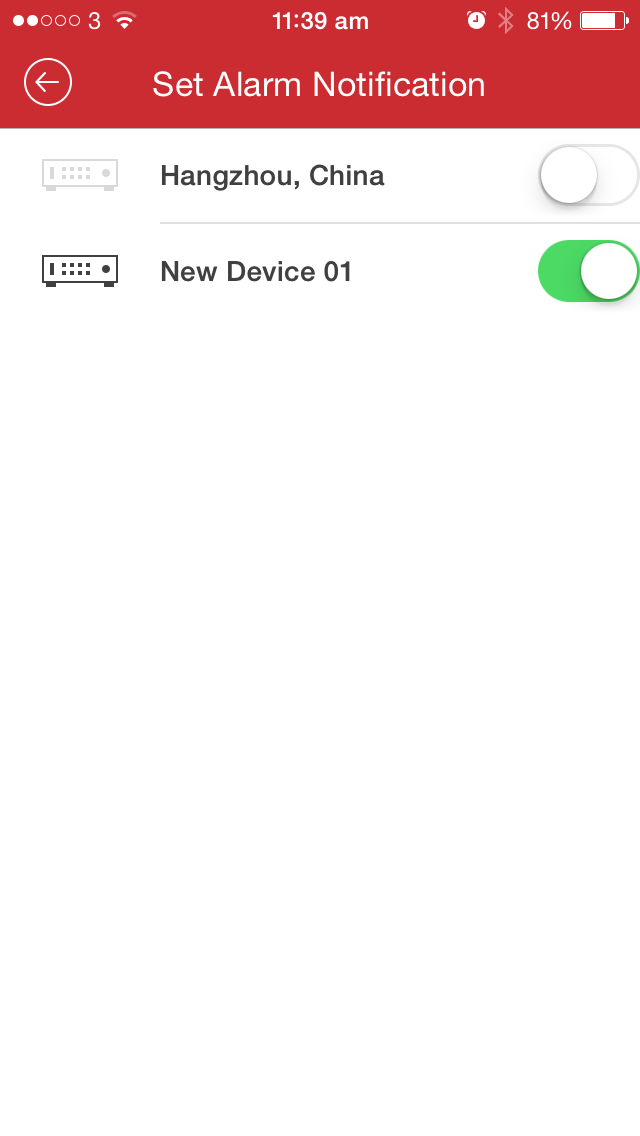

Hi all, I've got 4 DS-2CD2032's attached to an NRV that I would like to use to send push alarm notifications to my phone.
I've setup the email notifications okay but feel it would be better if I used the push to app function..
I have configured everything correctly (as far as I can tell!) but an not receiving the notifications to the phone app?
The only thing that I can see that might be wrong is that within the app my device is showing as the NRV and not the individual camera. Could that be the problem and if so how do I add the individual cameras and not the nvr?
see attached.
Many thanks in advance.
Devs.

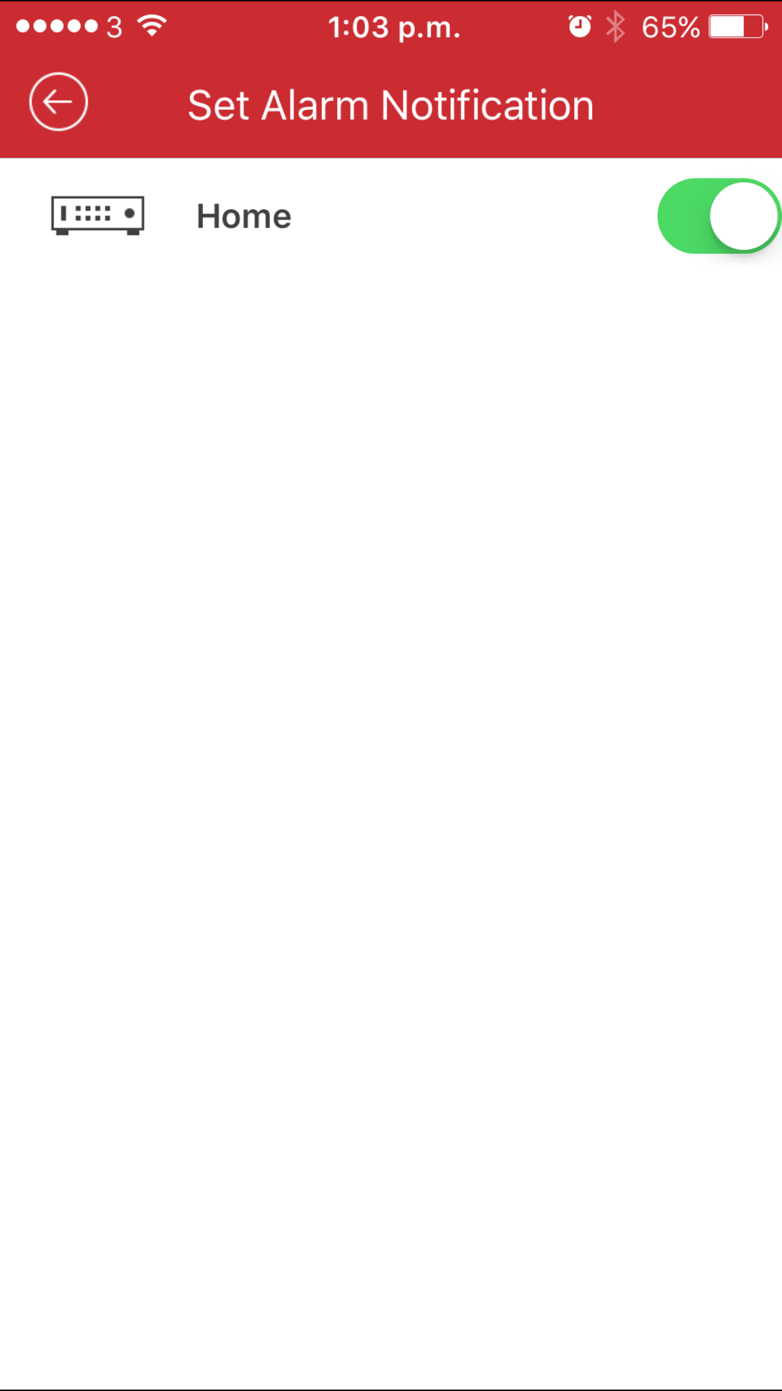

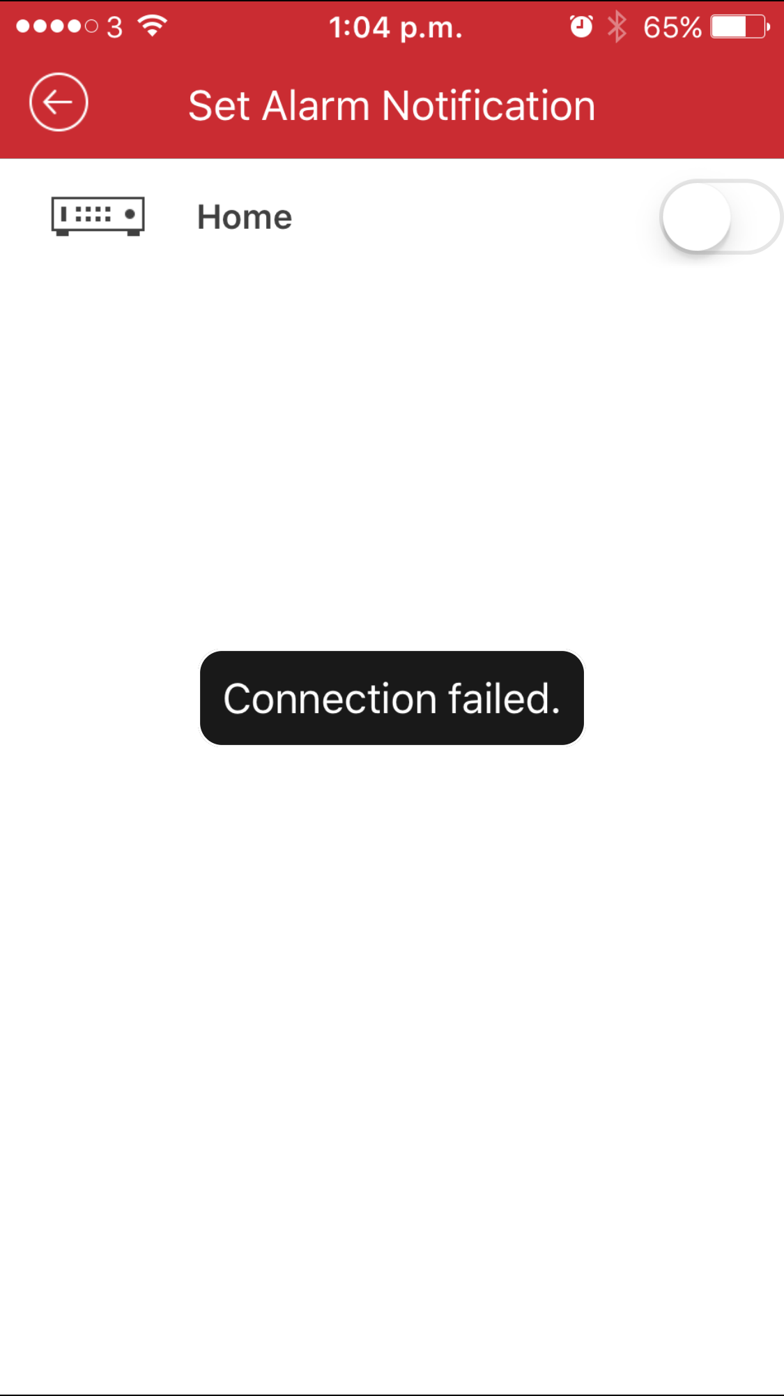

Hi guys, I wondered if anyone would be able to help? I've had push notifications work fine and all of a sudden a couple of weeks ago they have stopped?
I do not recall making any changes that would stop them. I've looked at the iVMS-4500 app (ios) and the only strange thing that I can see is as follows: under the "Set Alarm Notification" menu my device is showing as set to on. However if I try and turn it off it comes up with the error "connection failed" this makes me think that its not connected even though it appears to be?
I can view my cameras via live view but no push notifications via the app?
Can anyone suggest what I could try as I'm lost :(
Many thanks,
Devs.

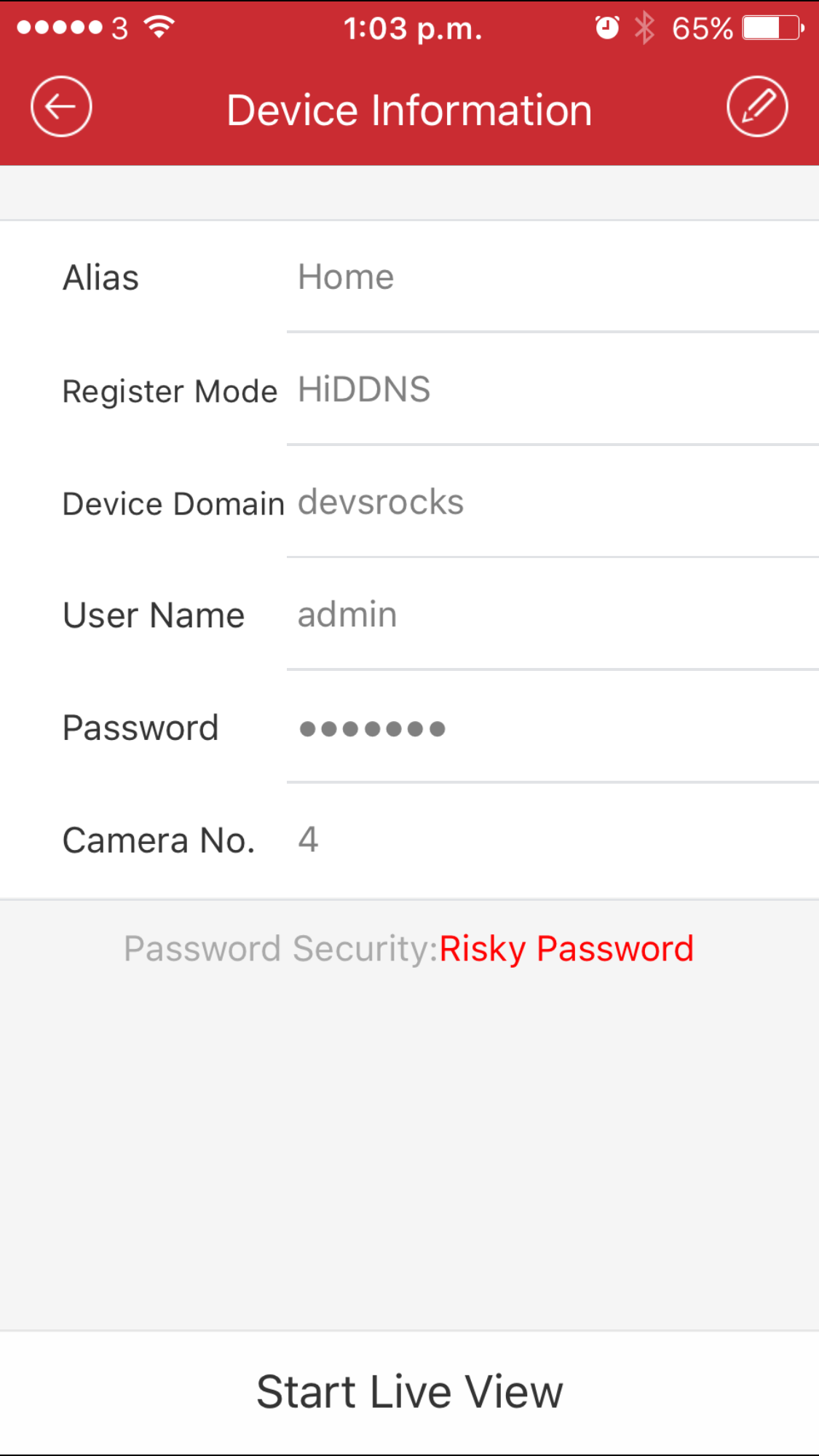

Here are a couple of grabs from the app if they help any..
Many thanks,
Devs.

Yes, the default gateway should be set the same as your router in the TCP/IP menu. You can double check what the default gateway of the network you're currently connected to is by running the command ipconfig in a Windows command prompt.
In the same menu you mentioned, please check whether your Preferred DNS Server is set correctly - we like to recommend Google's DNS server of 8.8.8.8
Otherwise, I'd suggest you try reinstalling the app and readding the device. One of your screenshots indicates that the device is using a weak password, which I'd recommend you change to a strong one ASAP - weak passwords on Hikvision devices cause all sorts of compatibility issues.
Hi Kieran, I've done as you suggested above and the reinstall fixed the problem. Really glad its sorted and thanks again for your assistance!
