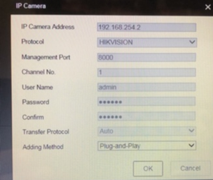

Hi Phil
Thanks for quick reply, yes both camera's are connected to the NVR by cat6 cable, as soon as I check firmware I will let you know, IR light is ON at nights on camera that is not working, I have tried factory reset NVR but no luck getting same results, 2nd camera working 1st one not. Am I doing something wrong in setup ...

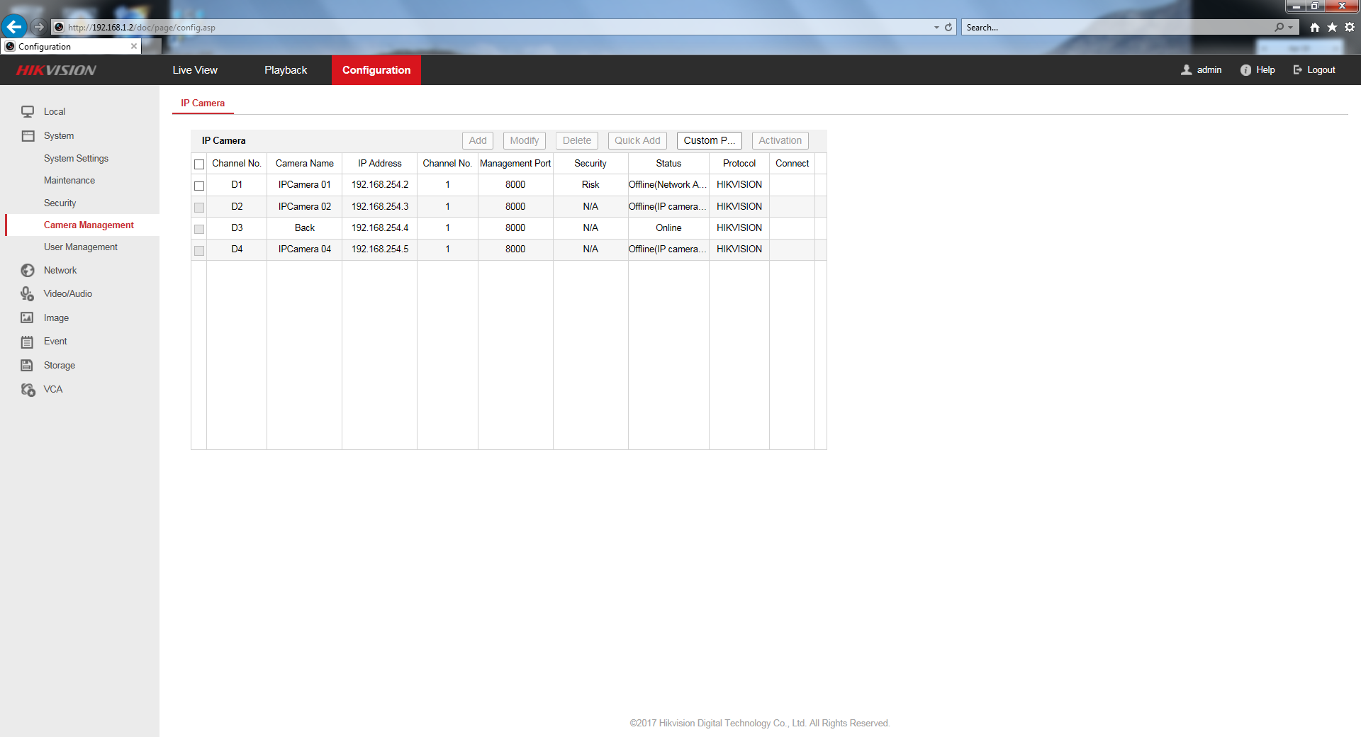

Hi Phil
got firmware of NVR
1988
Your firmware looks OK.

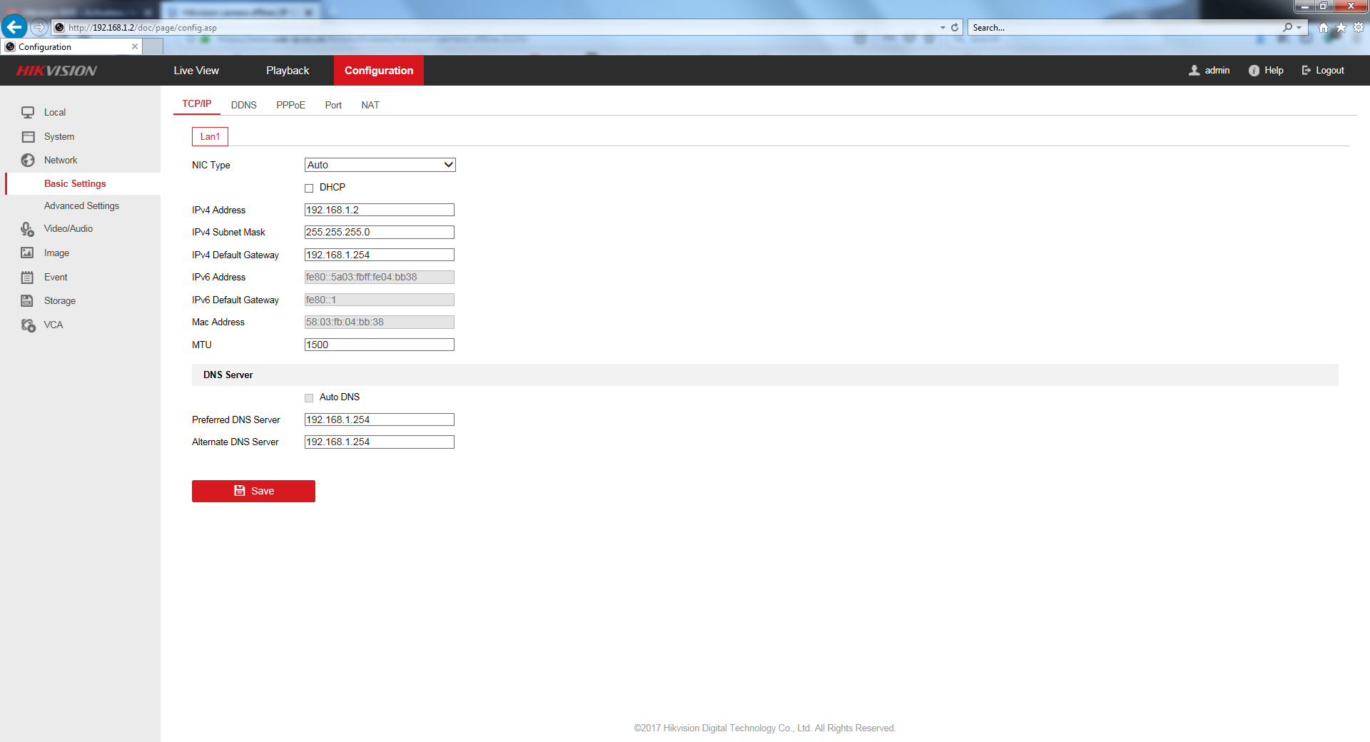

Can you attach a screenshot from the NVR's 'Camera Management' page please?

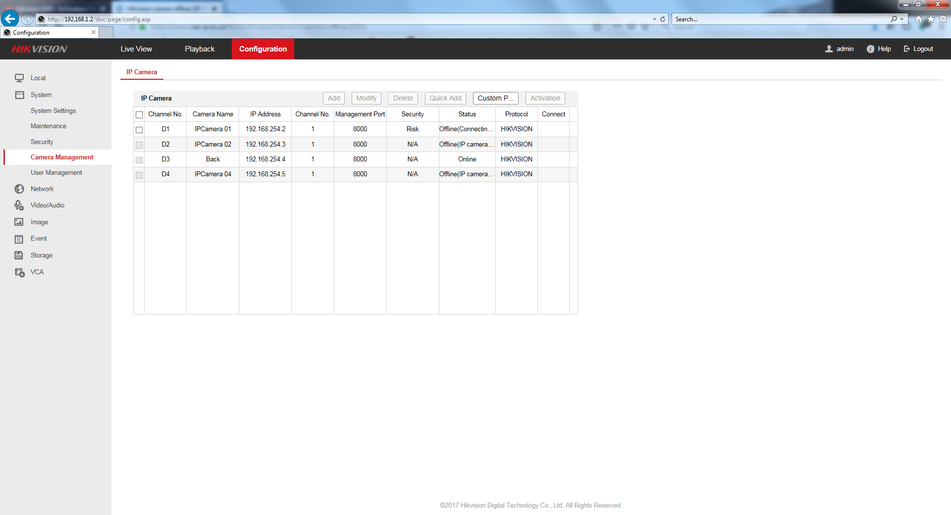

this is camera itself / if I change password then message appear " password error " those dots as a password are not my password
1990
Your settings look reasonable.
Some sort of problem with the cameras connecting to the NVR e.g. their passwords.
I think I'd disconnect the cameras.
Reset the cameras.
Reset the NVR.
Start afresh.
Plug in one camera at a time.
With the cameras disconnected you can reset the NVR from Configuration -> Maintenance.
For the cameras, you'll need to connect each to your network with a separate POE/PSU source and use SADP to access and reset them.
Hi Phil,

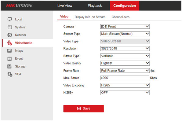

got the issue sorted, thanks a lot, may I ask you for advice when setting up a resolution on the camera ( DS-2CD2355FWD-I 5MP camera ) ...
to achieve the best possible day & night image, what resolution/camera set up you advising ...

Thanks,
will this will be the correct one as don't want on playback or live view to have small freezing ...
2055
Your settings look fine, I would enable h.265+ by setting the last field to 'ON' (the camera will reboot).
The h.265+ CODEC is significantly more efficient, so will save bandwidth and storage space.
