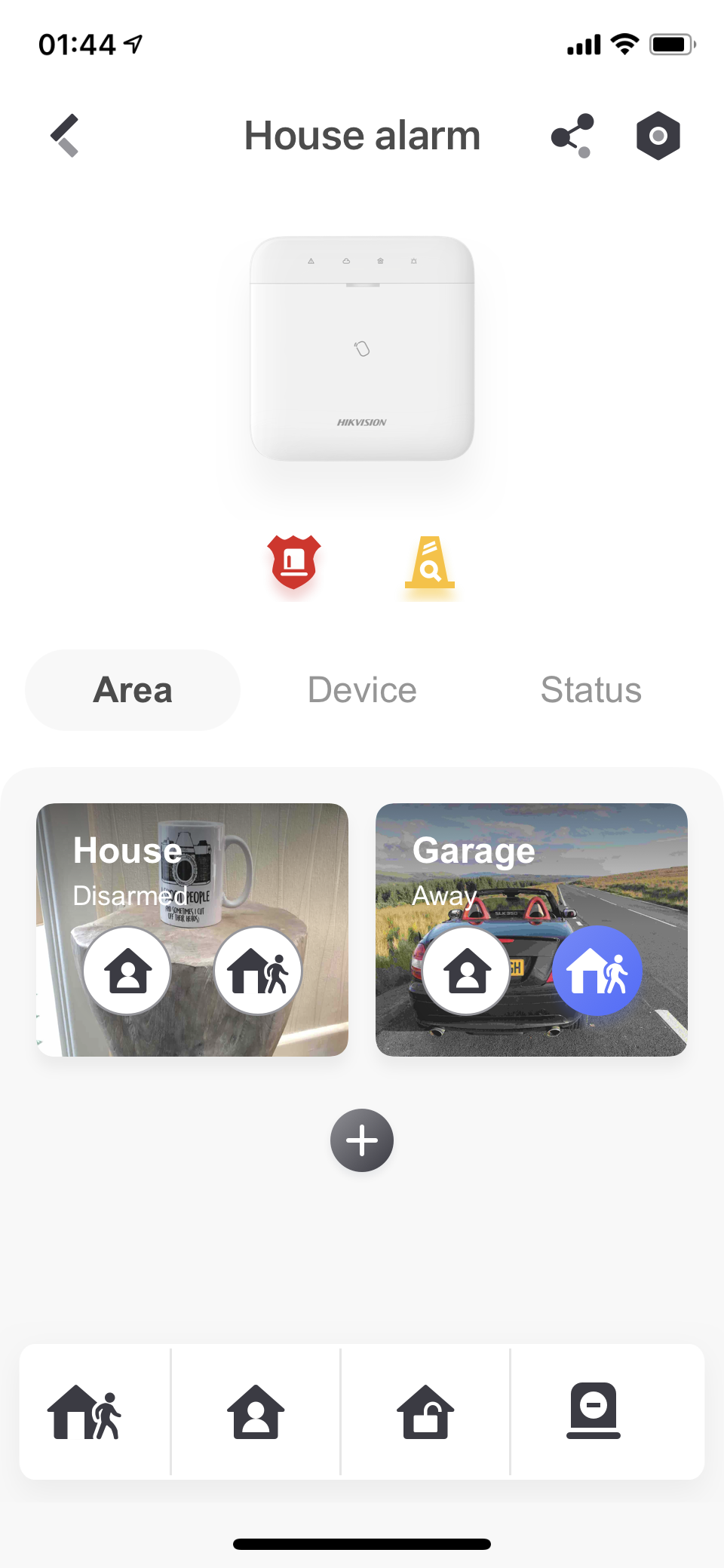

For each of my zones - there are two 'buttons' - one to set the system to armed if I'm at home, and one to set the system if I'm away. What's the difference in terms of what the system actually does between both options? I can't see anything that's configurable to perform a certain action different ways depending on whether you are home or away - has anyone figured out the difference?

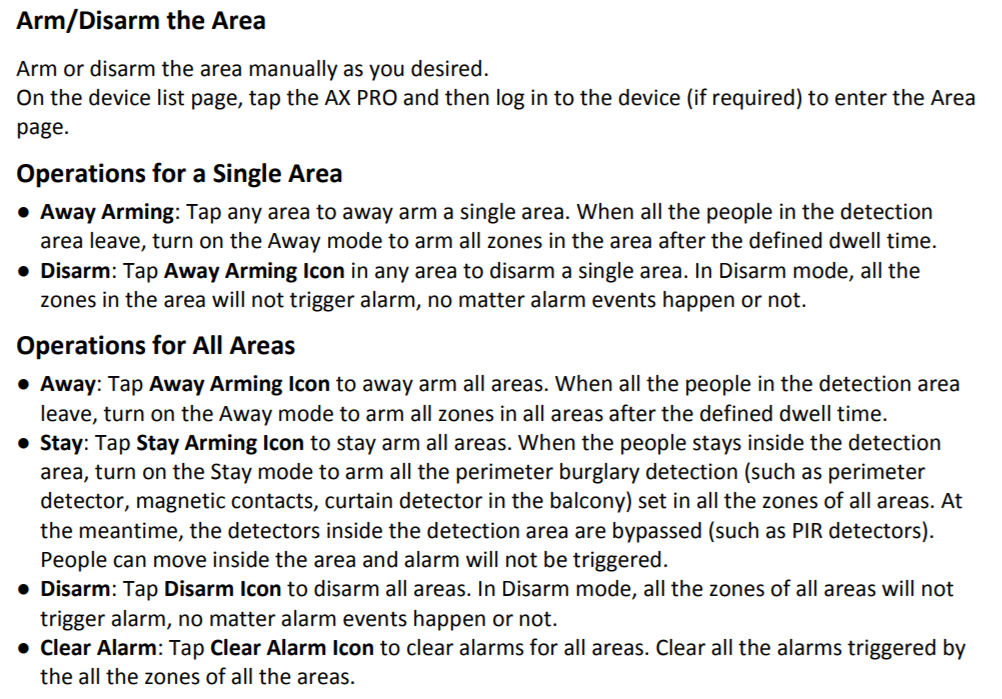

The screenshot below is from the user manual (also attached if you need it), it looks like...
"Away Arming" - This waits for you to leave the property, and then arms all of your alarm devices, both indoor PIR detectors, and perimeter devices (e.g. magnetic contacts, perimeter, glass break, shock, and curtain detectors).
"Stay Arming" - If you're home, this option will only arm the perimeter devices, and leave the PIR detectors for detecting movement within the room off, so that you're alerted when somebody else enters the property.

I've been messing around a bit since earlier and worked a few things out and I have a few scenarios that I'm trying to figure out.
  1. Are you able to set what state the auto-arm does? By default if you set auto-arm for a time then it'll full set the alarm for the area. This is fine for my garage as I can set the auto-arm and auto-disarm and forget about it but for the house I'd like to auto-arm and auto-disarm in the evening and morning but only to stay, not away, so only the door contacts are armed.
  2. In the event that there's no way of setting what auto-arm does, other than full set the alarm, is there a way of saying somewhere in the settings that if I press the main stay arming button, for the whole alarm, that for the garage area only I'd like it to full set.
If think, from what I can see, and from what I've seen in the user manual that every evening I'm going to have to manually stay arm the house area. I know this is not best practise but it saves having to arm/disarm in the middle of the night if the dog wants to go out.
In the Nest Secure settings I could basically make it so that on the home and guarding setting all the door contacts were armed but the garage PIR was also on so the routine would run every night and turn on all the door contacts and garage PIR.
Hopefully that makes sense?
