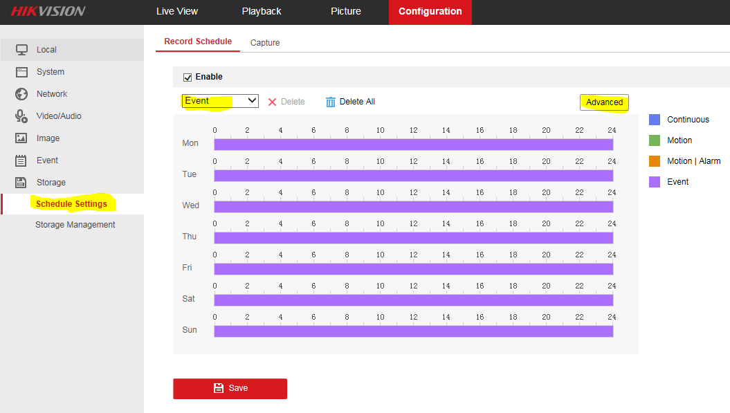

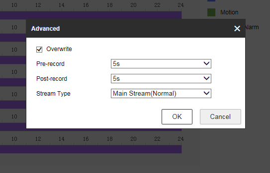

Hi, thanks for response - I do have an SD card in the camera. I do see some setting that specify record 5 secs or after event. But I don't see how these cod be Ftped..... I think it maybe via an event
Have you tried?:
Yes I tried that but I couldn't get it to FTP. I'm pretty new to this stuff so it may just be me... I'm a bit of a newbie..... really appreciate all your help

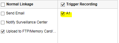

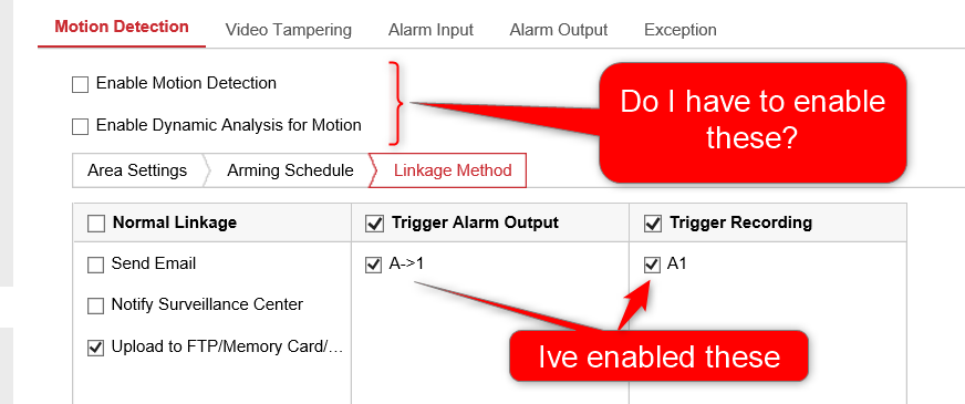

Does the vehicle detection have an option to select like this under linkage method?
Thanks for the reply and follwing thsi up with HikVision. I have enabled these see below. Im not so familar with these setting as I managed to spam myself with images accidentally - I some how sent thousands of images to my FTP server. So I have been a reluctant to mess with them too much
I spoke with Hikvision's technical support again and their answer was no, you can't ftp the video clip directly from the camera. They suggested using iVMS-4200 (or an NVR) to perform that action.
