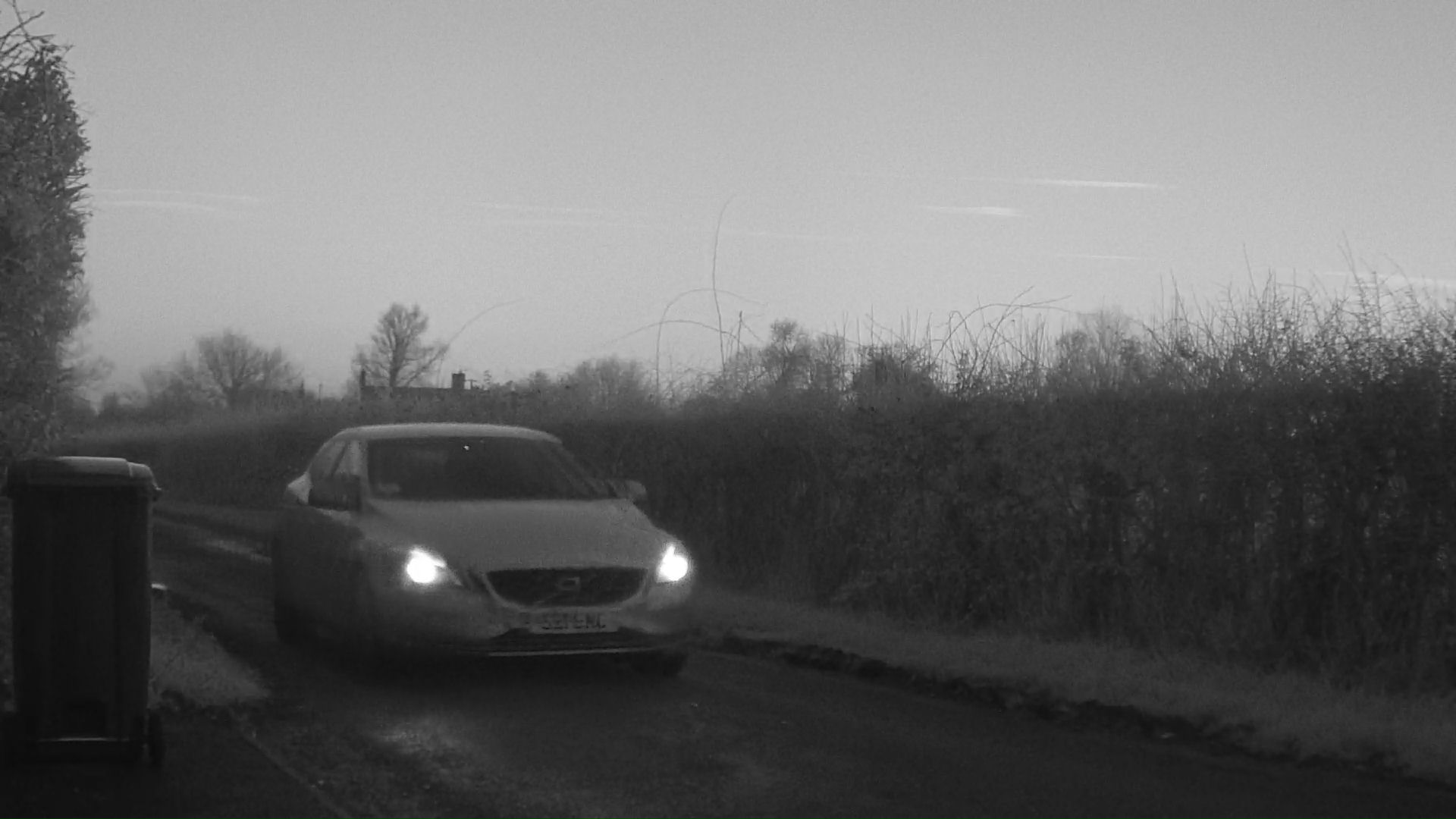

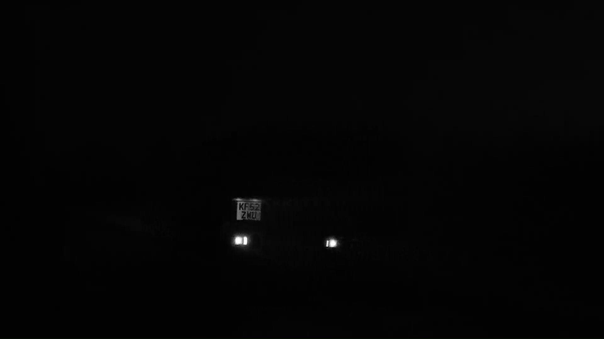

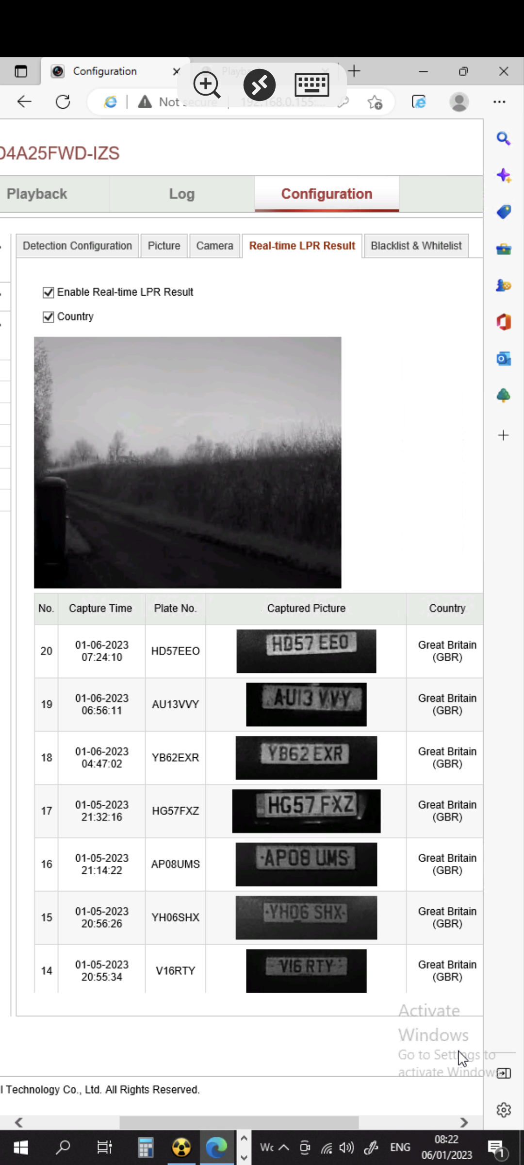

Do you have any idea what settings I could tweak to maybe catch these too plate . They have not been detected
