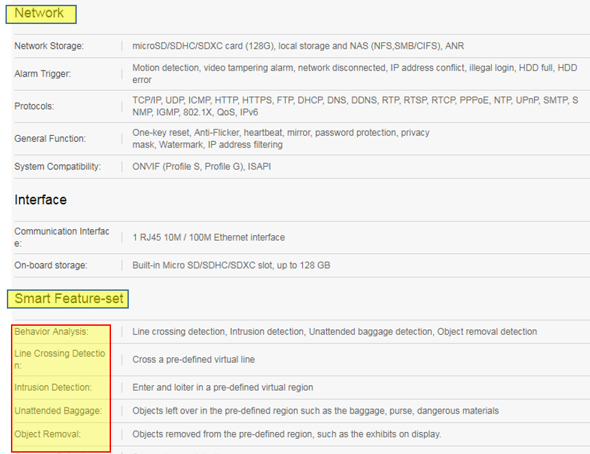

The best way to be sure the cameras come with the features you require is to look at the specifications or the datasheet for each product. Typically IP cameras have more functionality. Look under the Network>Alarm Trigger and Smart Feature sections.
The following is for a DS-2CD2025FHWD-I which can be found here: DS-2CD2025FHWD-I. Examples of analogue cameras can be found here: Analog Camera Turbo HD Camera HD720P Indoor Dome-List1-Hikvision

generally you can use these VCA(Video Content Analytics) in Analog system too the main difference is in IP camera system any one of IP camera according to their datasheet has these feature so it could be use as a standalone. in example i have 1 IP camera DS-2CD2343G0-I which i install in my house with no nvr so for storage i use SD card and it directly connected to my router. currently i'm use motion and line-crossing on camera it self and it save videos on it's SD card and send alarm via email and app when its triggers. but in your analog system most of them cant use as a standalone system and VCA features like Line-cross, regional exit,.. need dvr actually DVR itself process the images that received from analog camera and trigger according to these features.
final word: most of VCA features which you see in IP camera it would be supported by most DVR from Turbo HD 4 or above so for comparison you should check DVR specification event!
