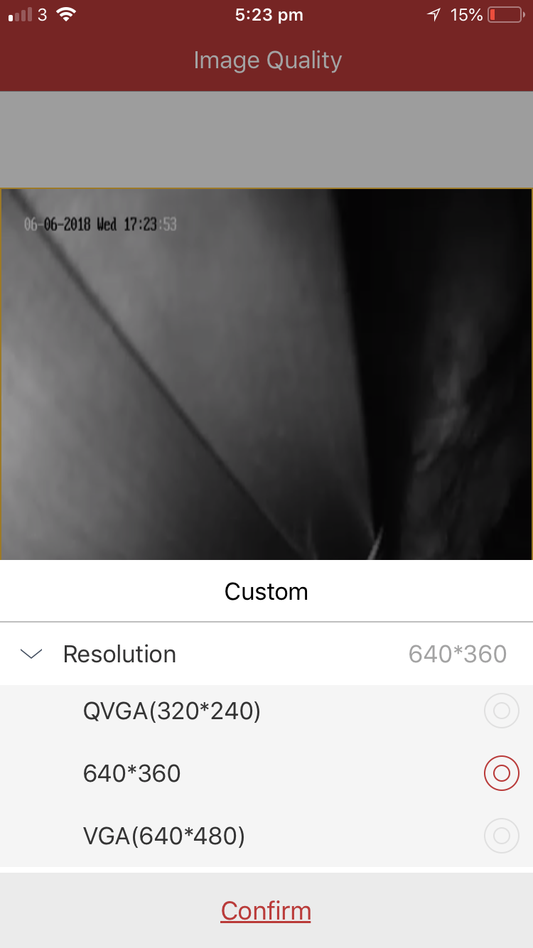

Iv took delivery today of 2x EXIR Turret cameras. However they are both not allowing me to up the resolution (Please see image).
Has this been experienced before and can advise of a solution?

Looks more like the sub stream resolution.
On IVMS 4500, I dont have the option for the sub stream, like I do on the other cameras.
Also logging in to the NVR I can only opt for Main Stream.
