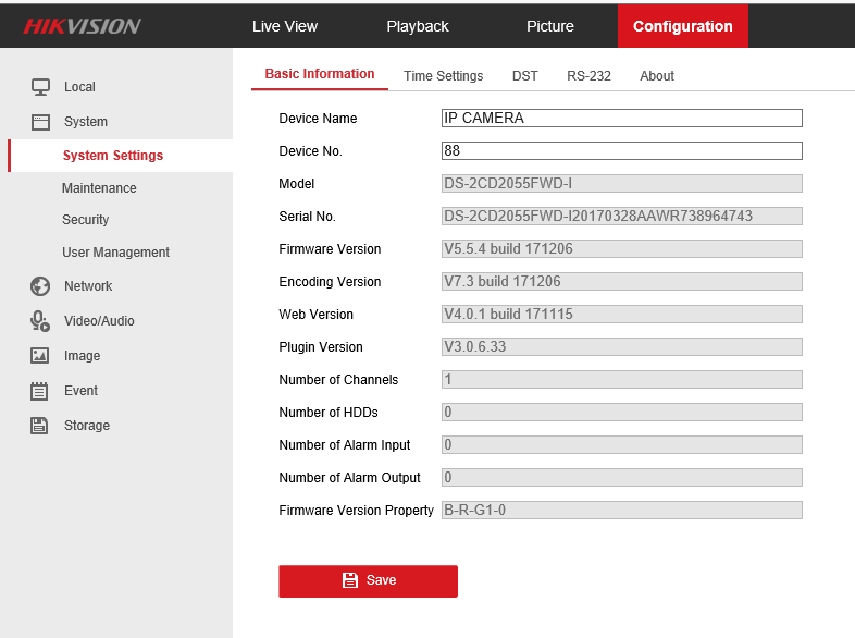

OK, I've upgraded a 2055 5MP mini-bullet camera to the latest available V5.5.4 firmware:

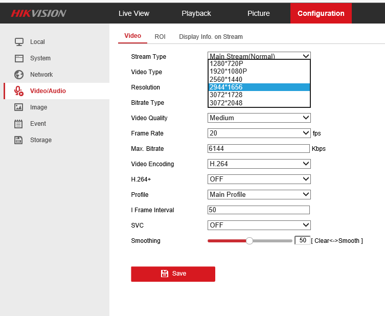

The available resolutions are shown below:

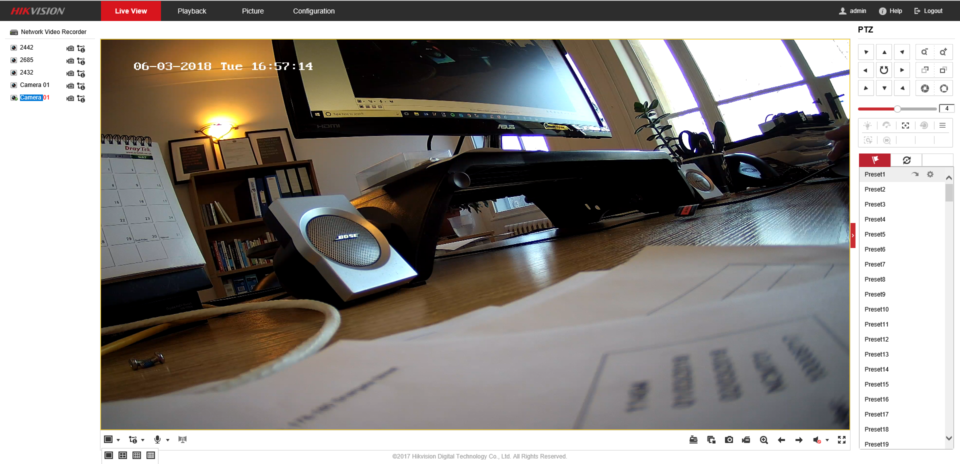

When set to the 6MP resolution of 3072 x 2048 it displays fine in Internet Explorer:

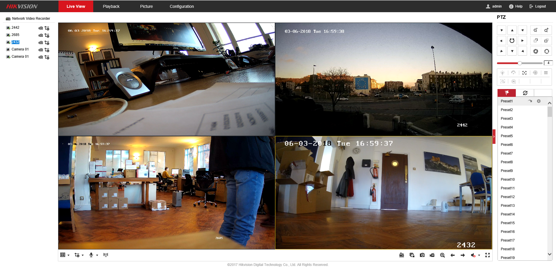

I've attached some captures of the same 2055 camera set at 6MP captured via the NVR when viewed in IE on my PC.

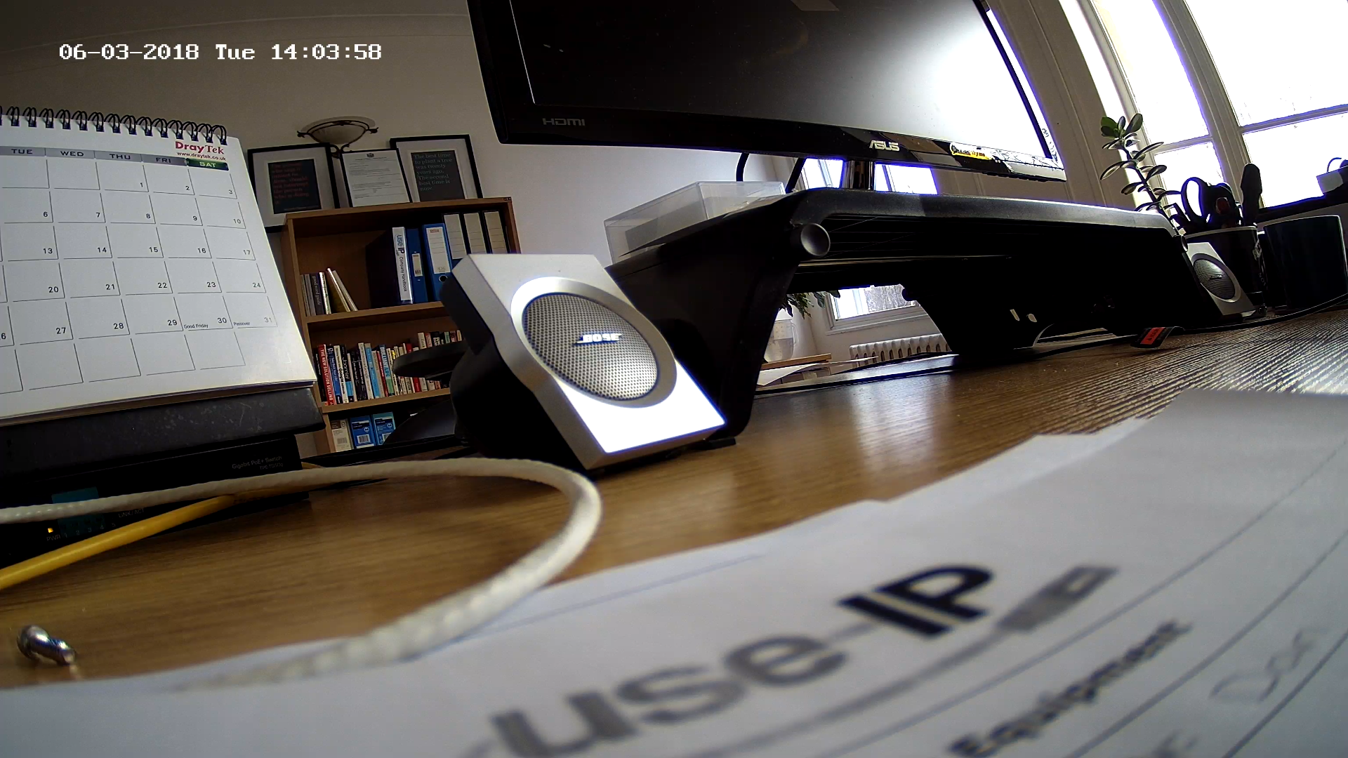

Nicer aspect ratio and wider field of view as well using the higher resolution compared to 2944x1656.
Yes, one thing I didn't do yesterday was to grab an actual capture still to verify the image size was as set.
So, attached now 3072 x 2048 capture 0.5MB image from a HikVision 2055 mini-bullet running firmware V5.5.4:

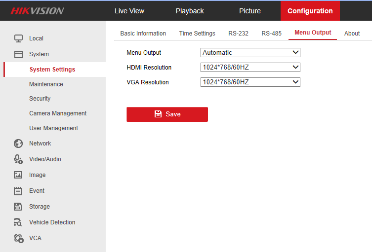

As you mention TV, does it make any difference if you adjust/increase your NVR's output resolution?
You can check for bitrate issues (in the user interface on a directly connected monitor only) as the NVR will show you the bandwidth currently used and remaining available.
Morning. The maximum I can increase the output resolution to is 1920x1080 at 60Hz, as my TV isn’t 4K. When I say the TV goes black I mean only the single camera window within the NVR software and not the entire TV screen itself.

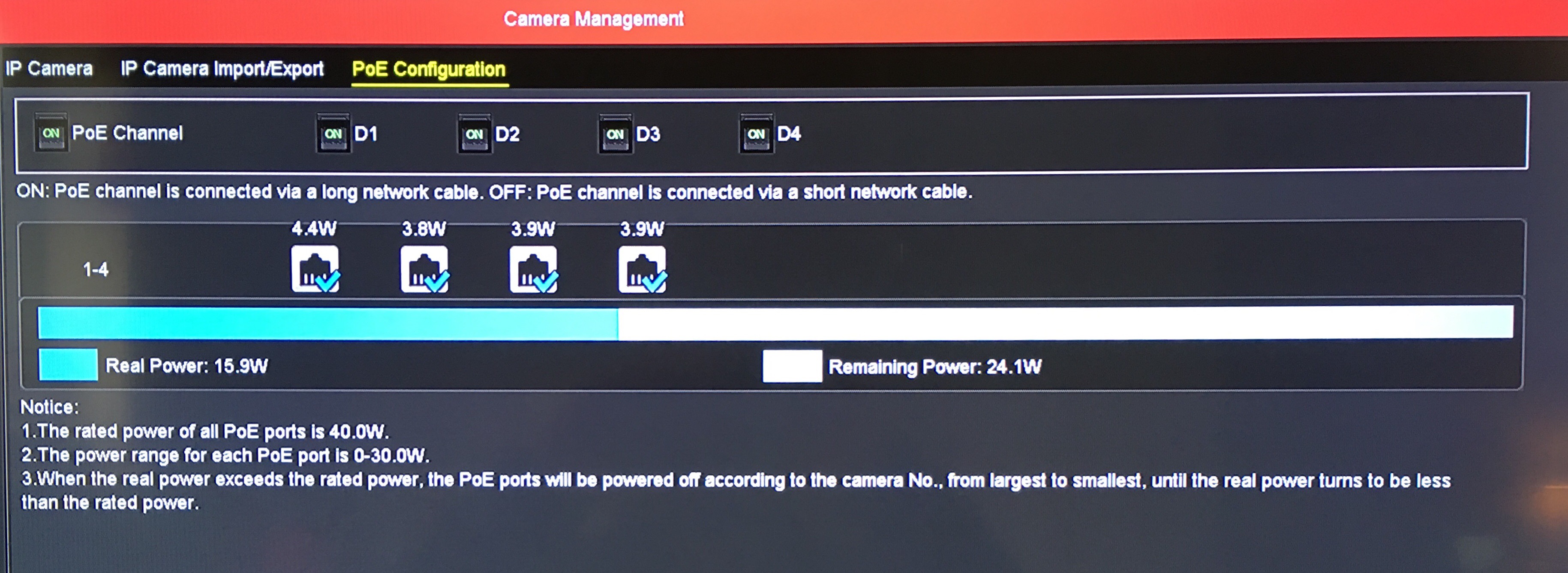

Think I mentioned before but does 3.2W to 4.4W power use for each camera seem normal?
When you are viewing multiple cameras on your TV are they set to sub-stream?
Try that.
Those POE power values are fine.
