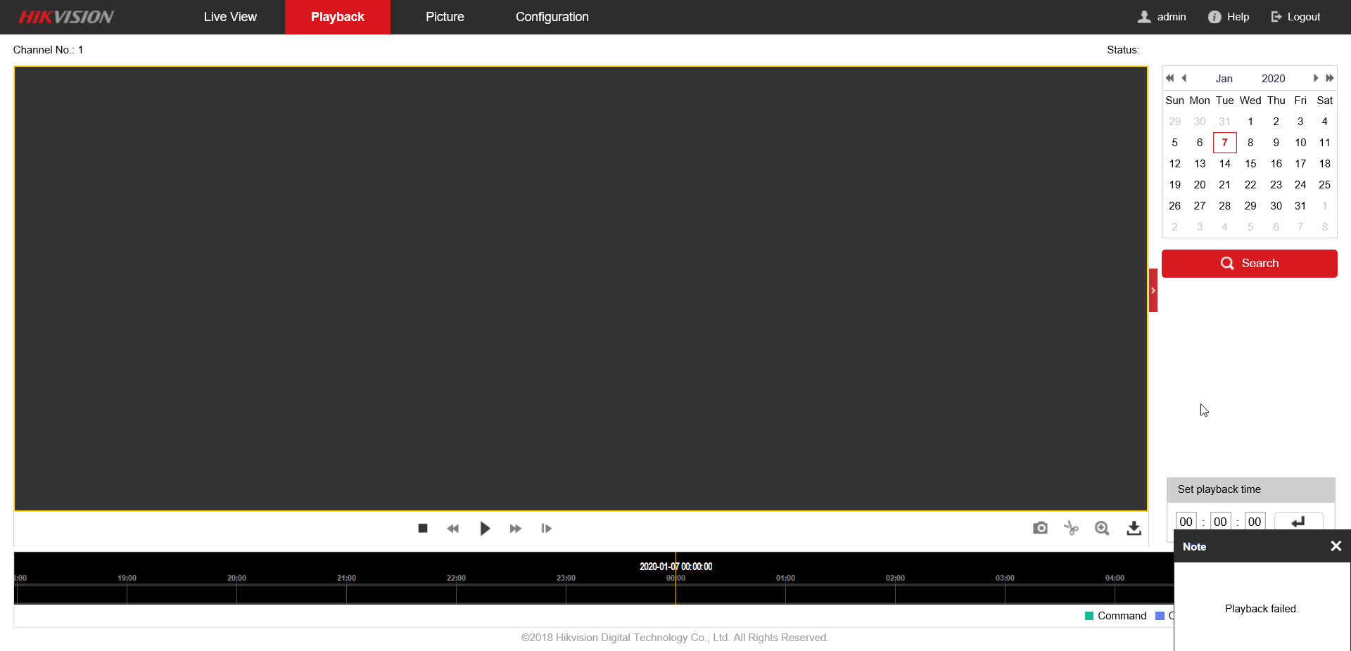

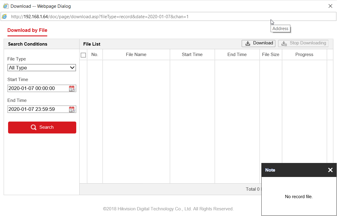

Hi, I have a Hikvision Network camera that is able to save recordings into the SD card but I am unable to view the recordings in the playback tab when using a web browser. I have to manually take out the SD card from the CCTV and read it on my laptop to confirm that the recordings are being saved. I am unable to locate any of the recorded videos. Is there any way to solve this issue? Note, I do not use a NVR.

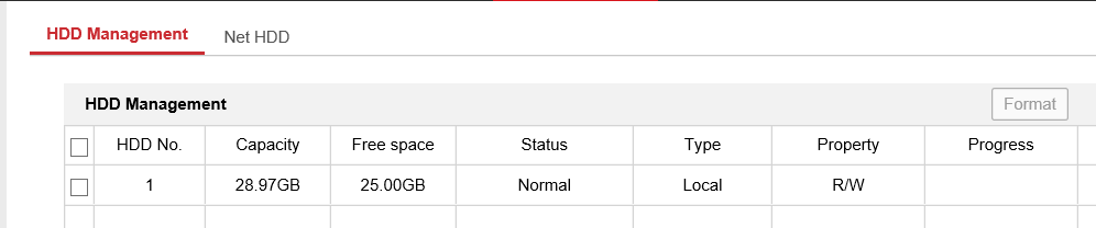

Did the card format OK at the beginning?
Sometimes, in the event of problems, people find it helps to format the microSD card in a PC first, then again in the camera.

The SD card is already formatted and the recordings are being saved in it. When I take out the sd card from the cctv and read it from my pc, the video recordings are there. However, when I try to view the recordings directly from the cctv with the web browser, there were no files recorded.
