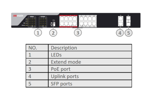

both switch connected together via G1 to G1 than from first switch PORT 16 to NVR
now all cameras are working but the few of them images are responding slow please guide me thanks
Are you using the 'Uplink ports" (4 in the illustration below) to connect the two switches one to the other and to the NVR's LAN port?
