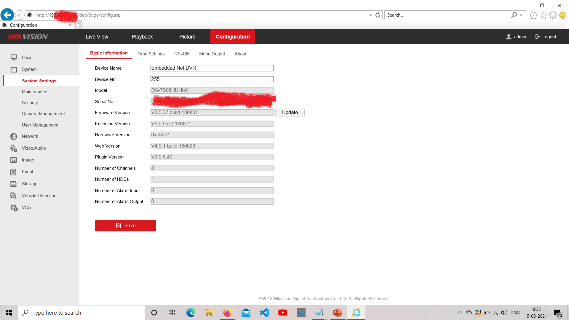

Initially, when I am staring the device for the first time, I gave admin password, security questions, Unlock pattern and other settings. Now my device is locked at these settings. I am unable to change them.
I tried changing my network settings/firmware upgrade/Adding users/any other change I do. I am getting settings were succesfully saved notification. But after Reboot all settings were unchanged. Please help me.

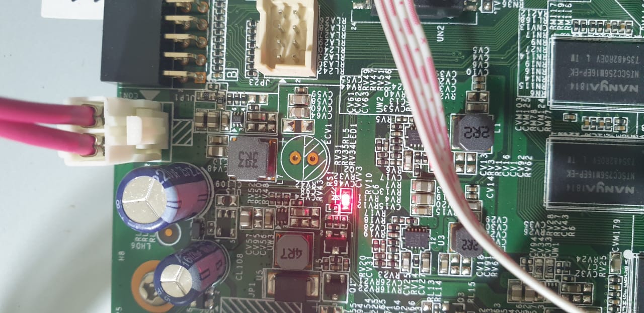

By the way, I am seeing a red indicator on the motherboard. I am attaching the screenshot for your reference. Please let me know if this is of any use to solve my issue.
I have also tried replacing CMOS.
If there is any way using pins on the motherboard if I can reset the DVR please let me know so I give it a try.
Try:
Run Internet Explorer as an administrator
Also, if the above makes no difference, as you seem to be using a laptop via wi-fi, try connecting your laptop to your network with a cable.
I know, it should not make a difference, but it's step that got added to our firmware update guide for a good reason :rolleyes:

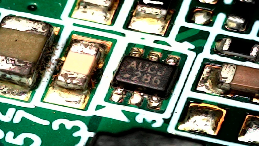

Hello @venkatnrit,
I actually have the exact similar motherboard with a shorted buck converter.
The components are fried up and I am unable to read the markings on top of them.
Could you kindly check the markings for me.
I am referring to the below,
You will find a marking written on the two chips like AUC. It could be different. This is why I need to get them confirmed before ordering.
Hope you could help me out.
Thanks a lot.
