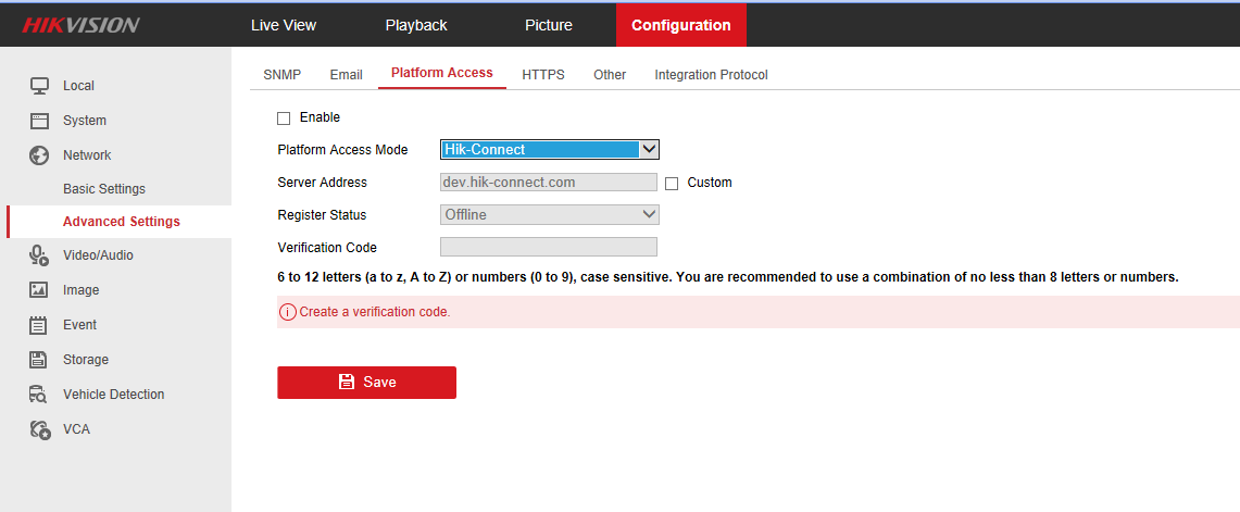

You need to enable 'Platform Access' in your NVR as per the below screenshot:
