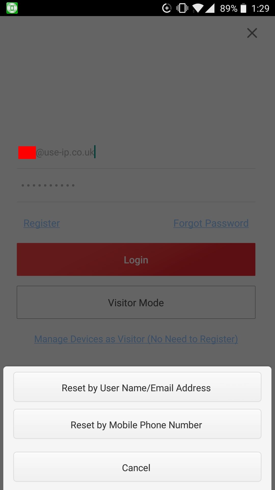

can i fix my hik connect app without password? if so how do i do that
There should be a 'forgot password' link:
