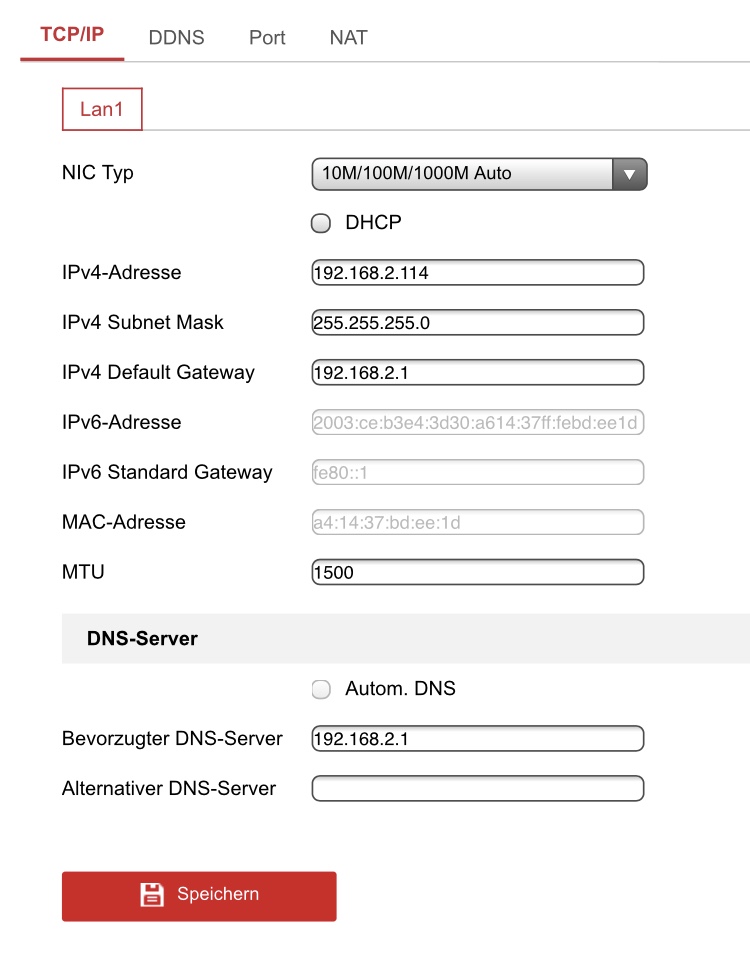

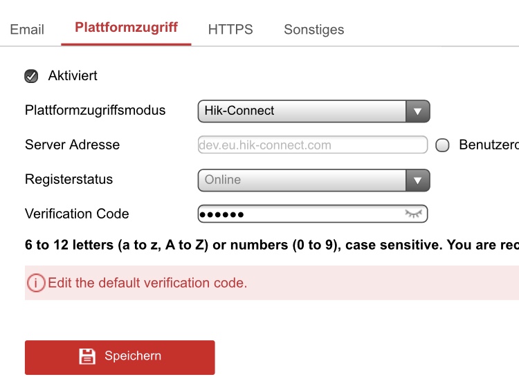

I've been having an unexplained problem for a few days now. My device is displayed as offline in the HikConnect app.
The router is online, the web interface is accessible via the IP of the device and in the configurations the connection to HikConnect is shown as online.
If I want to connect the device to the app it says that the device is connected to the router but cannot connect to the internet. But the device can be reached via the external IP...

I've updated in the chronological order but sadly after the update it still tells me that the device is offline, even though in the Hik-Connect settings the status is online.

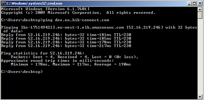

Open a command prompt from a PC on the same LAN and ping dev.eu.hik-connect.com. Do you get a reply?

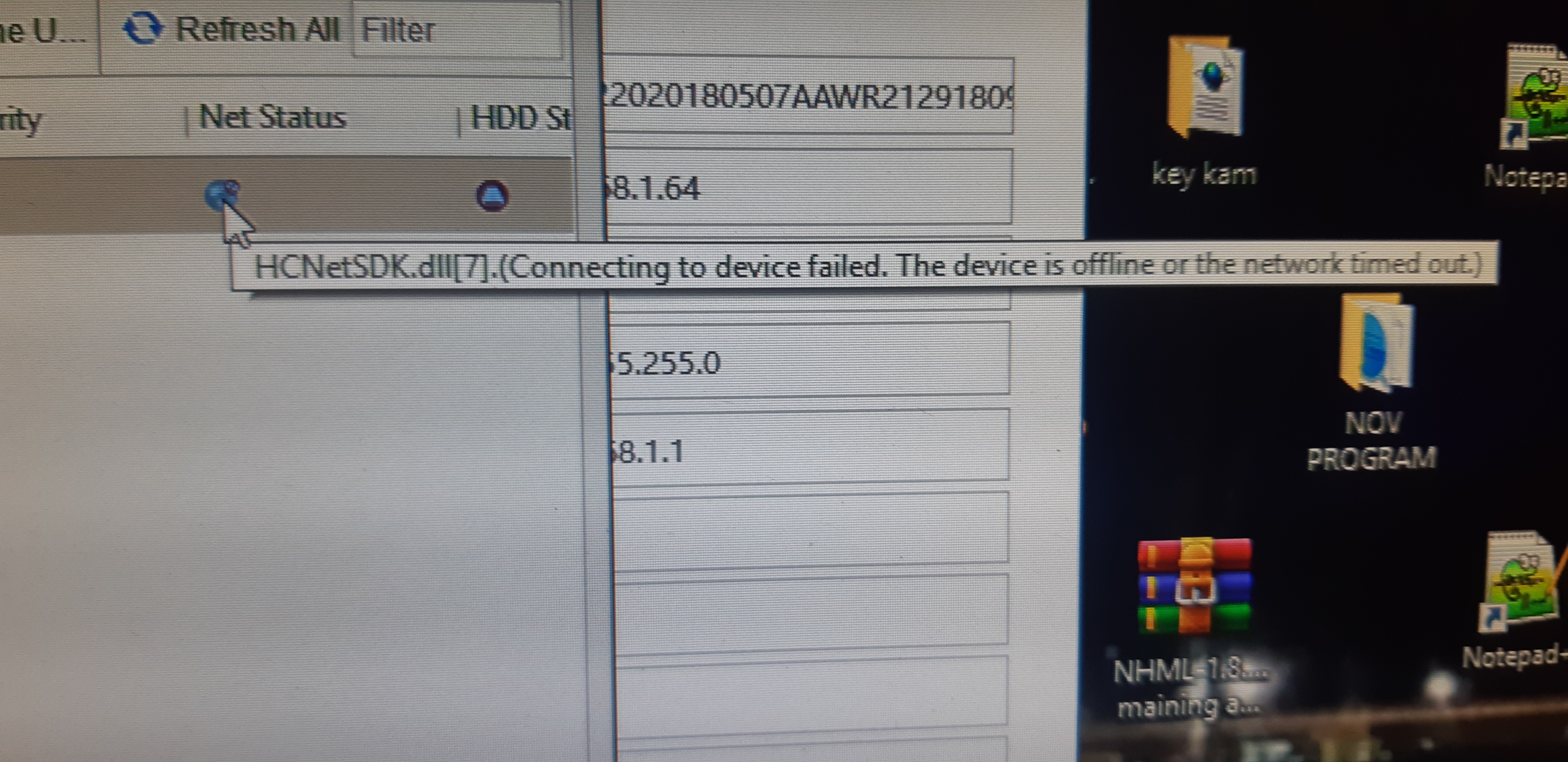

My hikvision dvr DS-7116HWI-SL showing offline in Hikconnect app for a few days inspite of all correct things. Removing and adding device shows cross region error.
