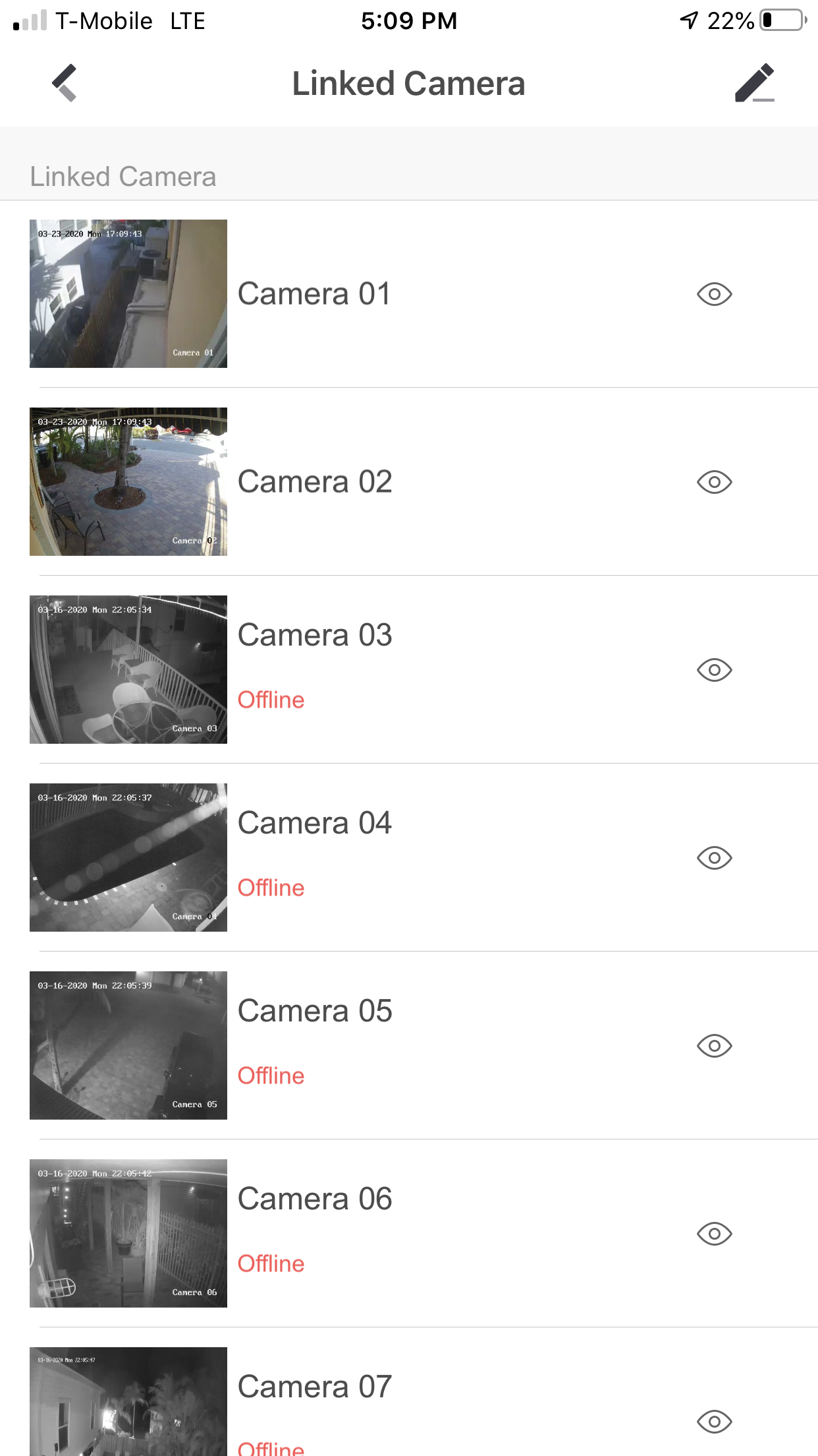

Hello all! I am new here. Am having trouble getting all cameras to show online in the app.
About a week ago, all cameras went offline. Finally was able to check the connections on the nvr today.
After unplugging and plugging back in the internet connections, 2 cameras came back online and all camera
views are available to replay. However, 5 cameras' live views still show "device is offline". Has anyone ever seen
this before? Any suggestions would be greatly appreciated. I don't have access to the nvr directly as I am in another
state. Have a friend who can check the physical device for me if needed. Thanks!
Go to settings, linked camera, and see if: (1) all the cameras show up in the list; and (2) make sure each one has the "open eye" icon next to it - if not, touch the icon to add that cam to the list.
Thank you for responding. I attached the pic from settings/linked camera. All cameras
have the open eye but only cam 1 and 2 are online.
