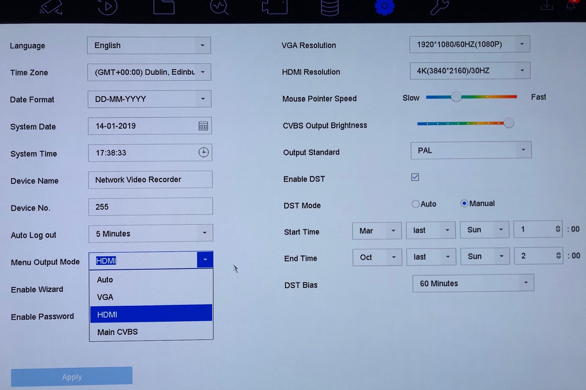

Could it be the menu output mode set to auto rather than hdmi?
