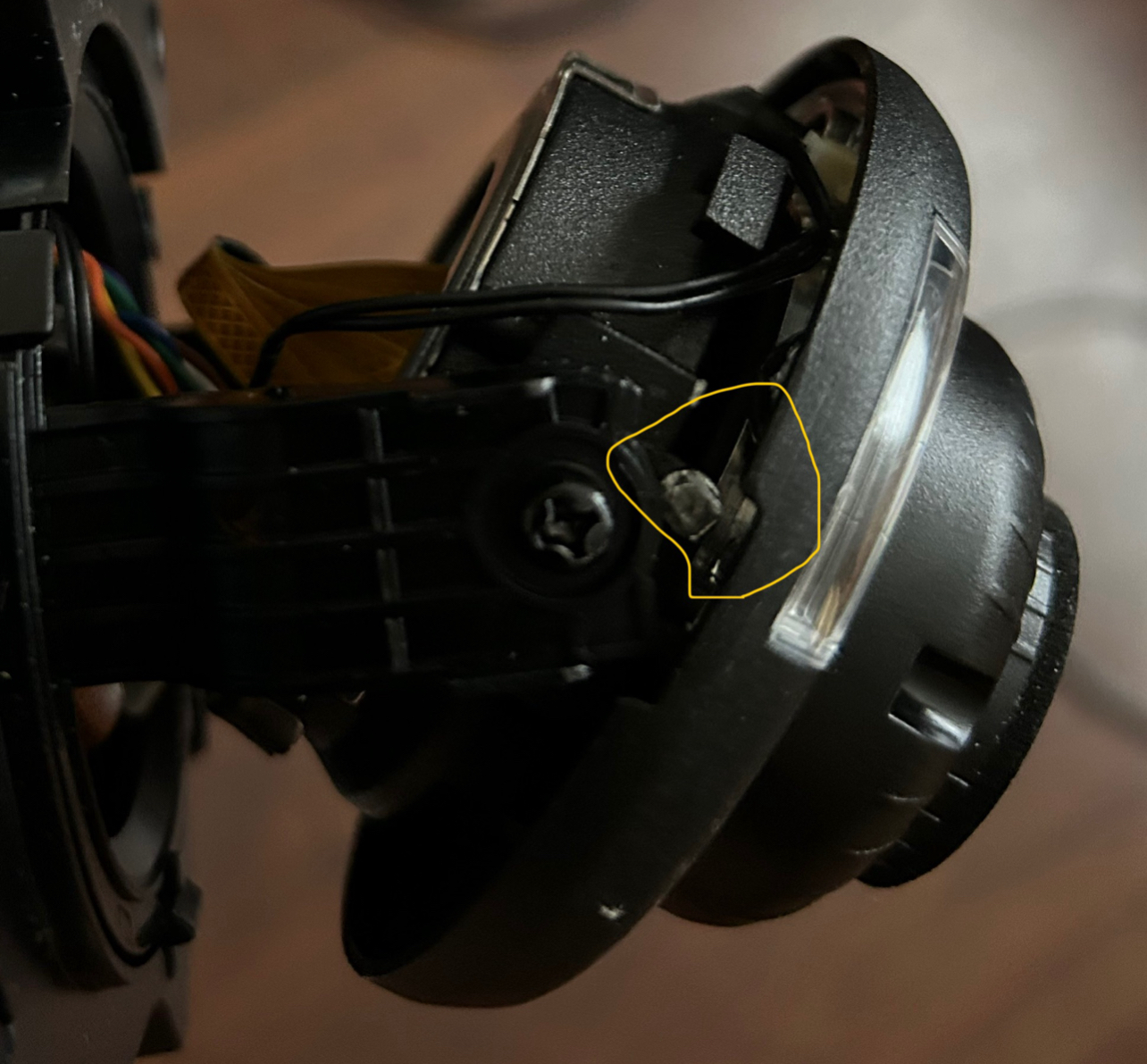

The accusense camera displays the view from my wall upside down. There is a tab that physically prevents the camera lens from displaying upright. Were I to cut that tab, I could rotate it correctly.

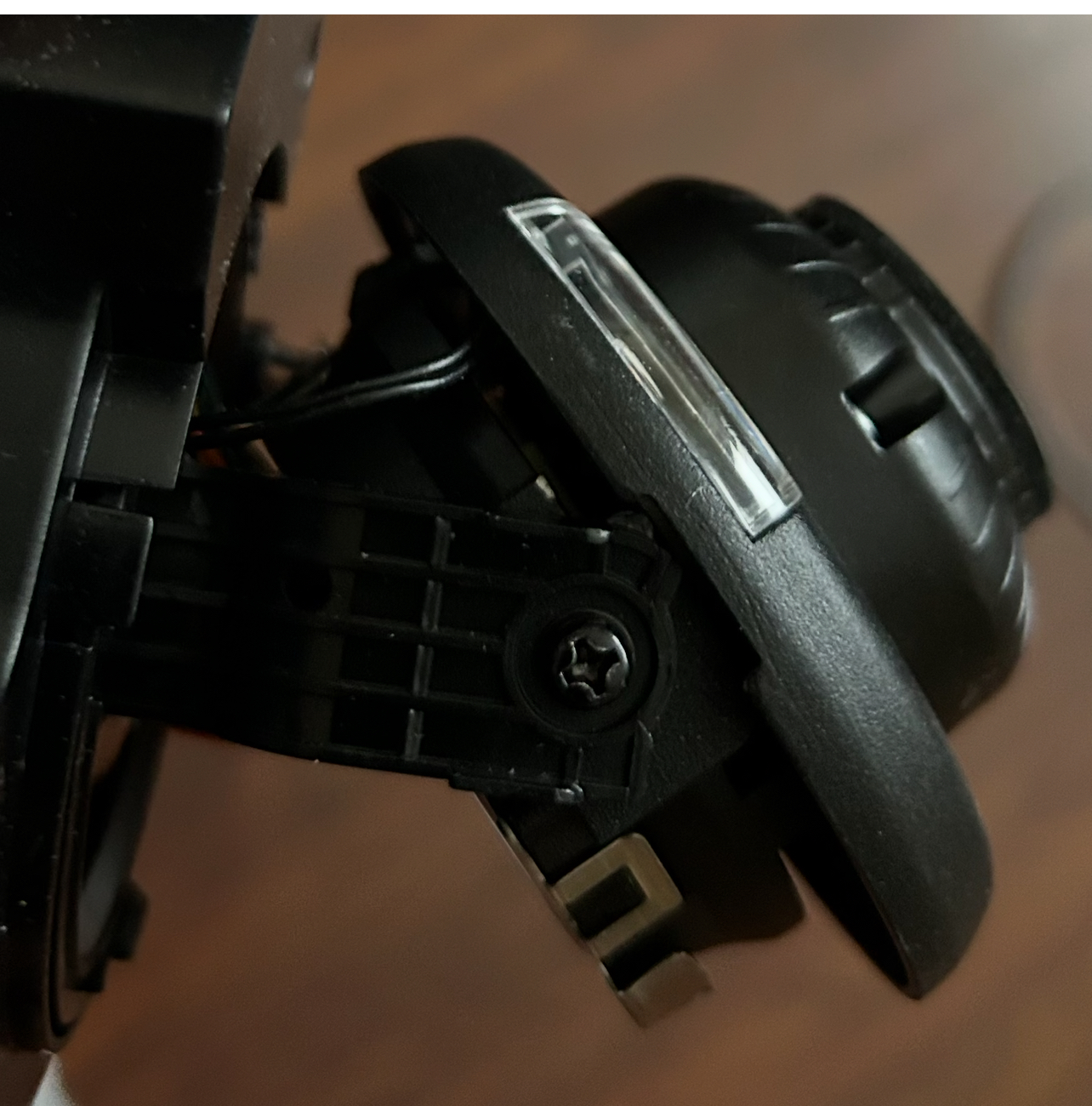

Not proud of the solution I did to fix my $180 camera, but it now views correctly.
There’s a knob in yellow that was preventing the camera from turning and I cut off the knob with a set of wire cutters and it rotates the full range of motion.
This is it rotated to the correct position
