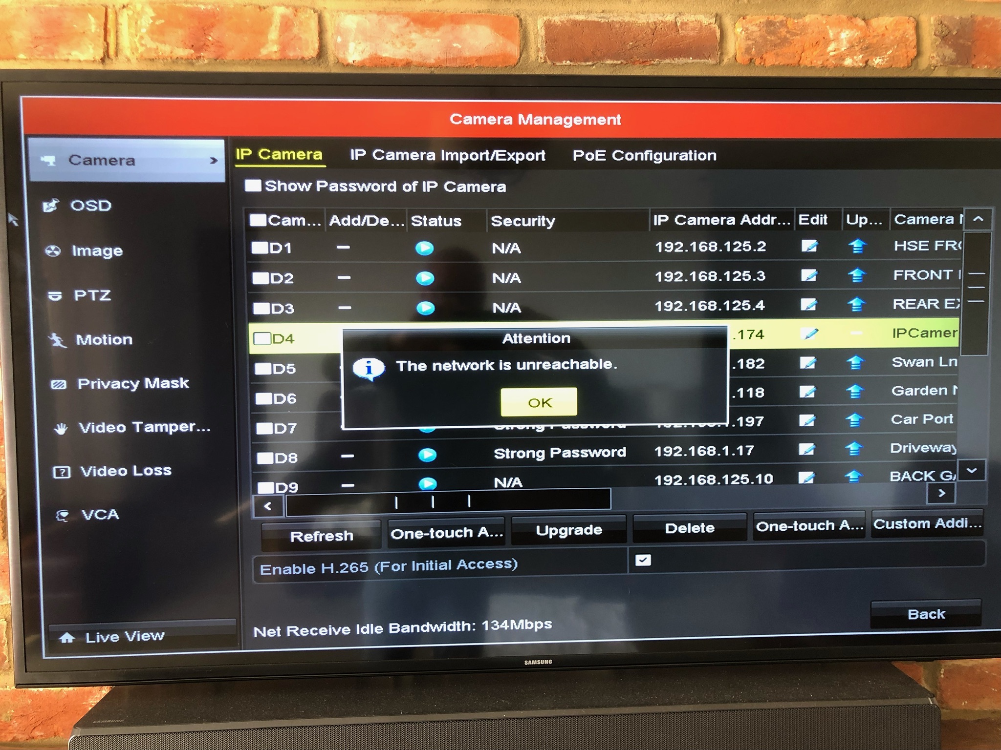

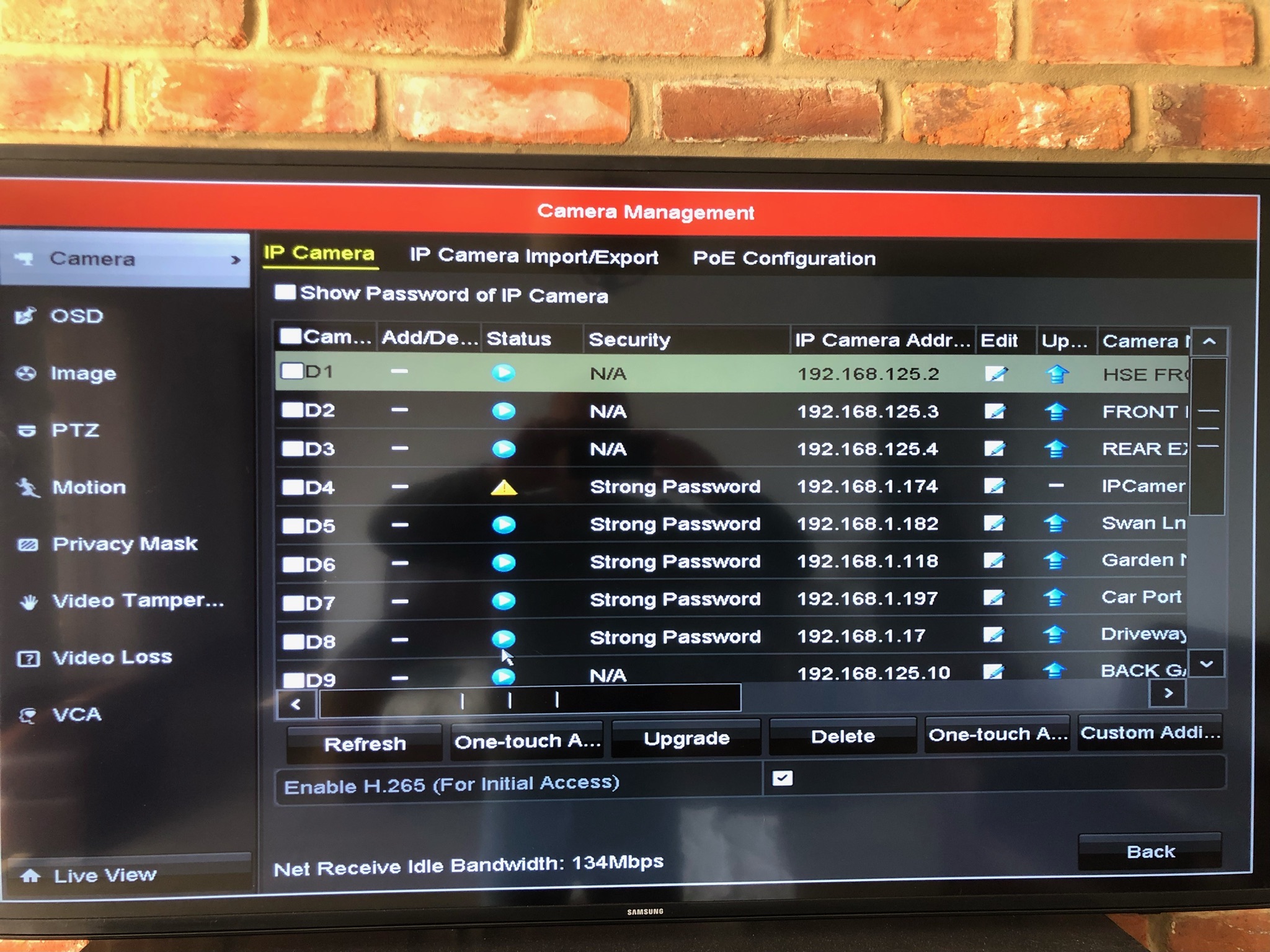

Recently, one of the PoE cameras (D4) has started showing as offline and I am unable to view it either via the HIK Connect app or via the NVR interface. The other 8 (including the other 4 PoEs) are still working without issue
Having spent hours trying to find a solution (to no avail) on the internet I came across this site. I’ve read through the various similar threads but I’m either doing something wrong or not grasping what is needed.
I attach a couple of pictures of the camera configuration and would be grateful if anyone could offer any words of advice. Although I am reasonably tech savvy with day to day stuff, I might need to be treated like a child with anything too in-depth!

I have tried entering the IP address into a browser and I just get an error message saying something like “error, connection timed out”. If I try putting the IP address of a working PoE camera it does take me to the log in page

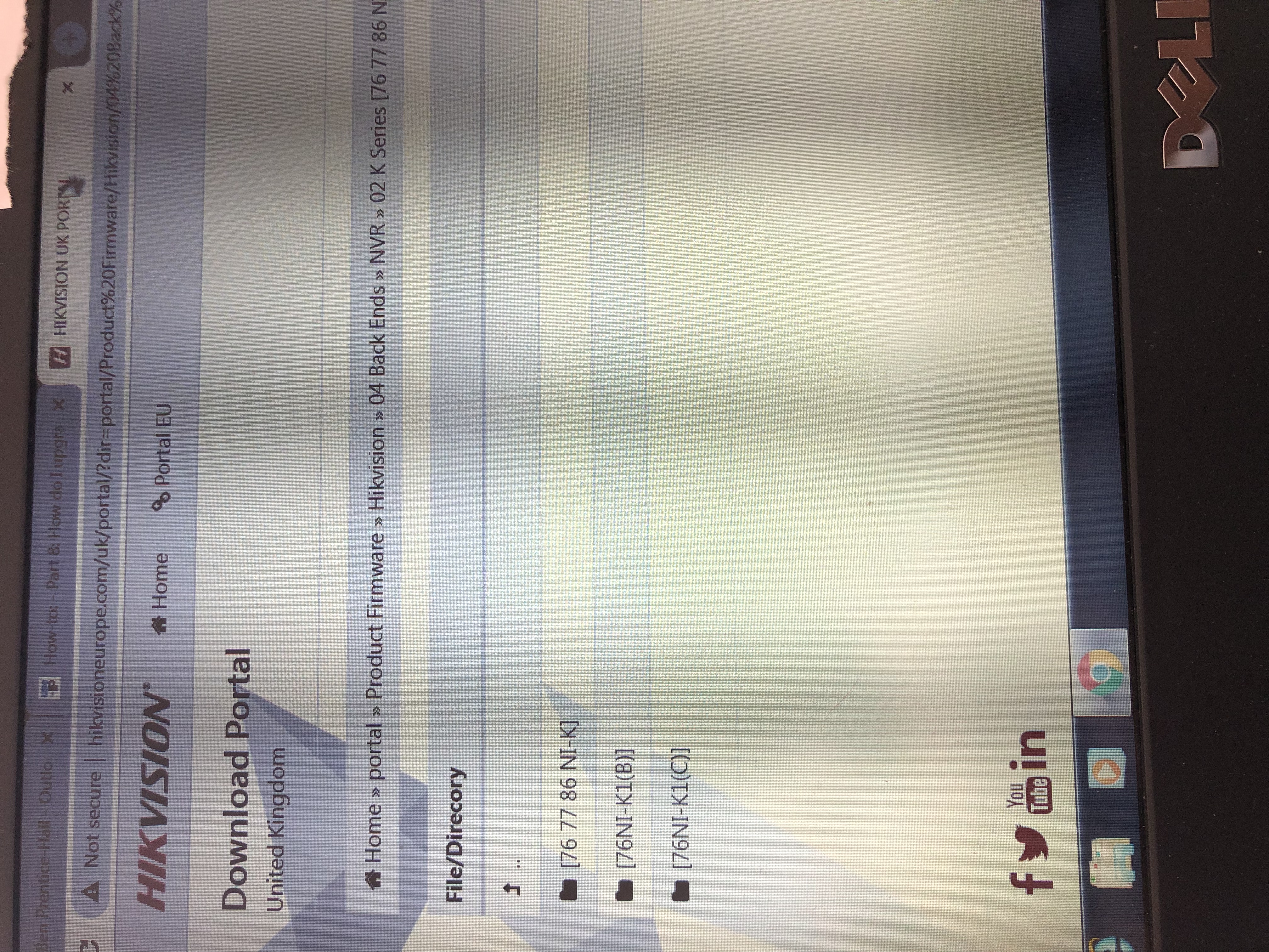

Can I just confirm that mine is a K series? And if so, which of these sub folders (and the subsequent ones after that) do I need to choose?
Upvote 0
Hi @Chip
Your model is definitely a K-series as you said it was a K2/16P model.
If you follow the link in my earlier post that should take you directly to the correct sub-folder which is portal » Product Firmware » Hikvision » 04 Back Ends » NVR » 02 K Series [76 77 86 NI-K] » [76 77 86 NI-K] » [76 77 86 NI-K2 K4 K8]

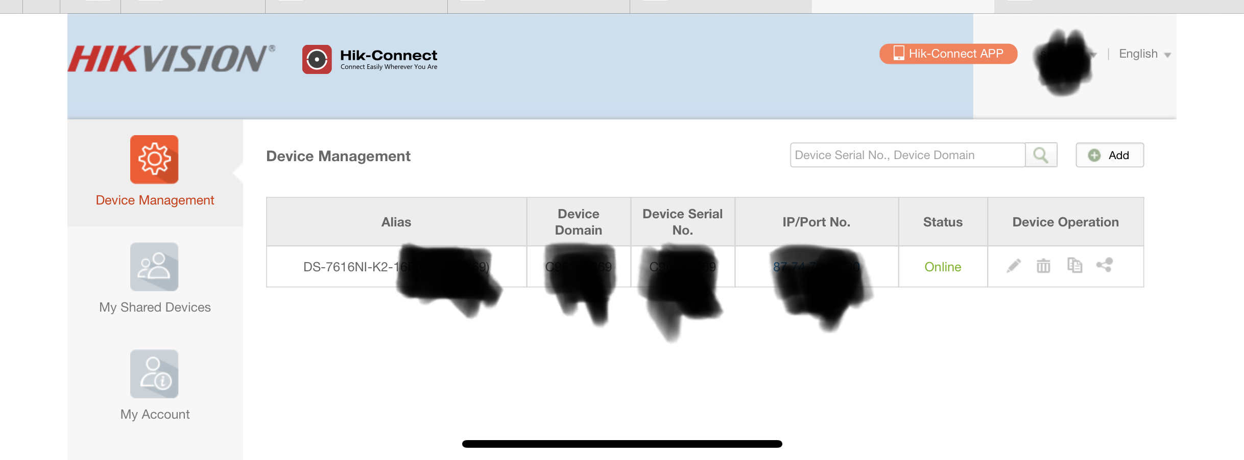

I’m a little confused - I can log on fine to the NVR and also if I go to the HIK connect webpage (see attached). Are you saying there’s another set of log on details I should have / know?
Going back to the installer / seller isn’t a possibility so if I am missing another log on and password, I guess I’ll have to go to HIK directly?

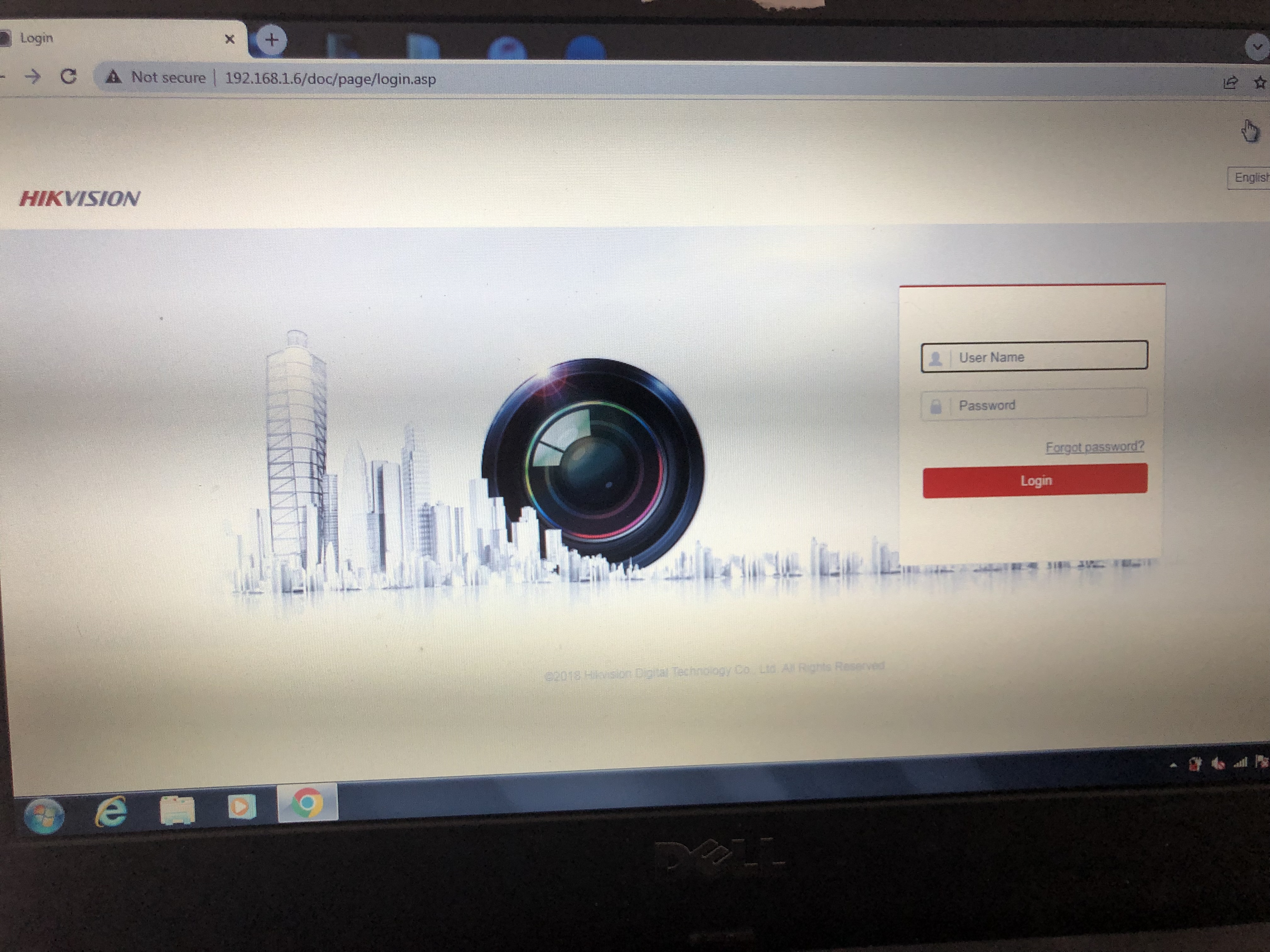

Attached is the screen where it says incorrect username / password
I’m using the IP address 192.168.1.6 (also as per the screen shot)
I’ve tried on both google chrome and a safari browser. Have just attempted it again and it still won’t work

Okay, it may be that due to the age of the firmware you are running it is not properly supported by modern browsers as they removed support for the plug-in that the NVR required for browser access.
You may have to do the firmware update via the desktop iVMS-4200 software, this basically allows you access to the same menus and features as the browser but on your desktop. Install the software, open it and go to device management, either select the NVR from the online device list and click add to client or click add in the top left of the device management window to add the NVR manually.
Once you have the NVR added to the software you can select the NVR and then click remote configuration, a pop-up menu should open with all the NVR menus, click System > System Maintenance and you should be taken to a page with a section labelled Remote Upgrade where you can load the NVR firmware.
