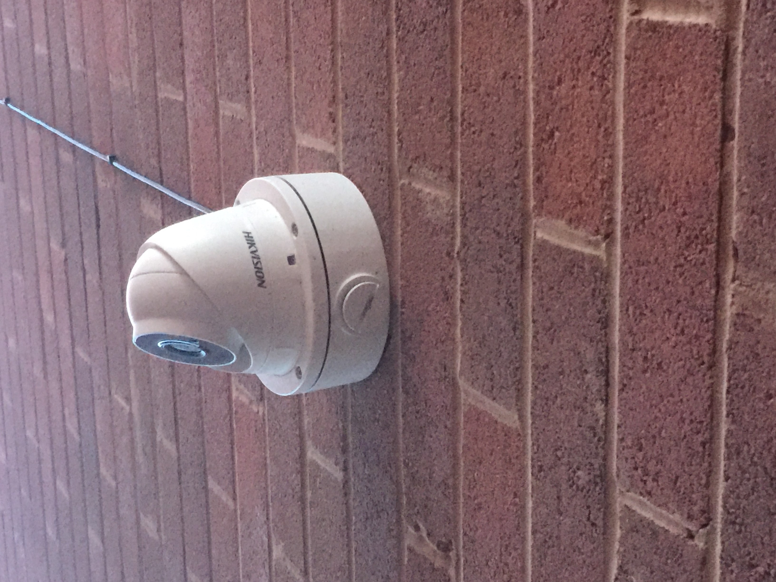

Thanks for the reply, the model of the recorder is DS-7024HUHI-K2, Serial C73647625 im unsure of the model of camera, i have attached a picture, if that helps?

Typically the lights are Power (green) on the left, HDD activity (red) in the middle and Network activity (green) on the right.
The power light should remain constant but the HDD and network light should flash indicating activity.
From a computer connected to your WiFi router try access the DVR. If you don't know the IP address, download the SADP tool from Hikvision's site and run it. Once you have the IP you can access the webGUI of the DVR from IE11 browser to narrow down the issue.
