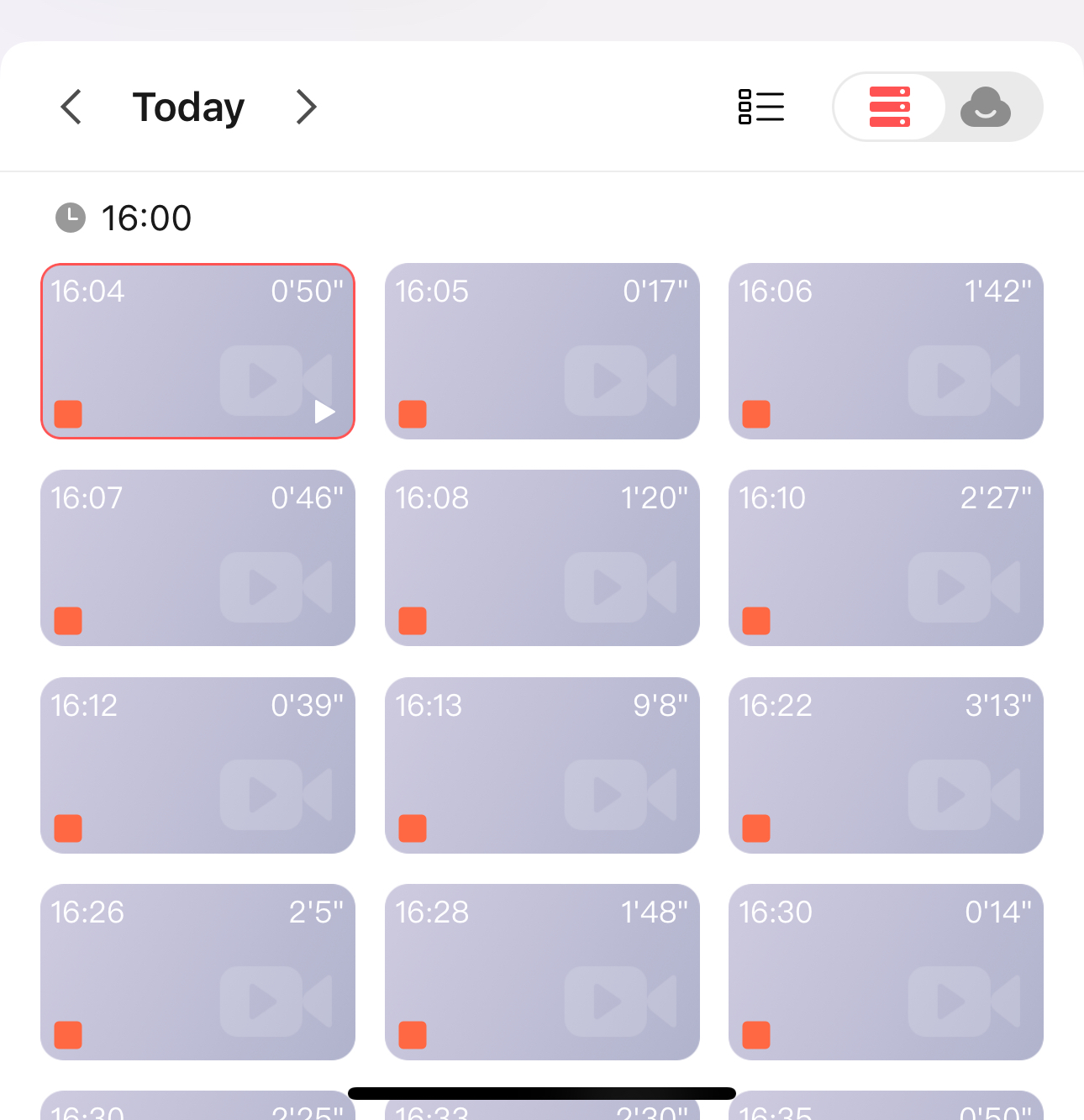

Any ideas why the video playback event thumbnail are not appearing in the Hik-connect app? Got a new NVR and ColorVu cameras installed recently. Latest version for all.

Unfortunately, "Latest Version" when self-reported by Hikvision is seldom true :(
To date, they have never got the function to work properly, and the self-check always believes that IT IS the latest version :(
And, before doing the hard yards of trying to diagnose a root cause for any issue, being on the true latest version of firmware for each device IS important (simply because Hikvision may have fixed the issue that you are seeing).
Therefore, I'm afraid that we have to ask you to share the model numbers of each Hikvision device AND the firmware currently in use.
The same goes for Hik-Connect e.g. Android or IOS? And the version that you are using?

Try updating the firmware on the cameras and NVR.
You're using the most up-to-date version of Hik-Connect, so it might be down to compatibility with the old firmware and new app update.
Update the cameras to: V5.7.14 build 231213
And the NVR to: V4.61.025 build 220905
You can download the firmware by searching for the model numbers here.
