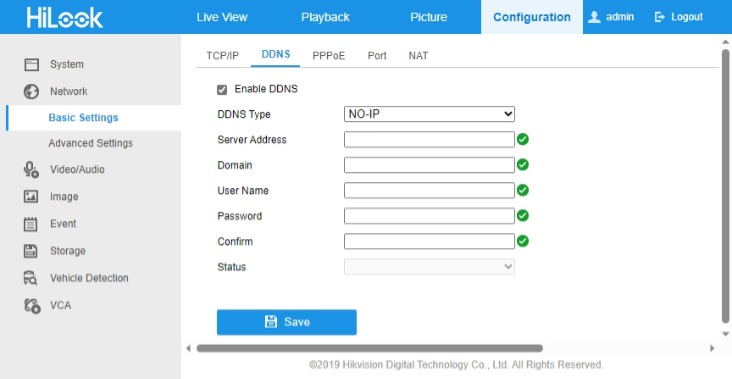

About the DDNS, I don't know if your device has support, but if it has, you can set it up on either NVR web or physical interface. And yes, you don't need a DDNS service if you Hik-Connect cloud service. The following is the DDNS configuration page on web GUI of my devices, but the physical one is mostly similar. Mine has support for DynDNS, PeanutHull and NO-IP services.
