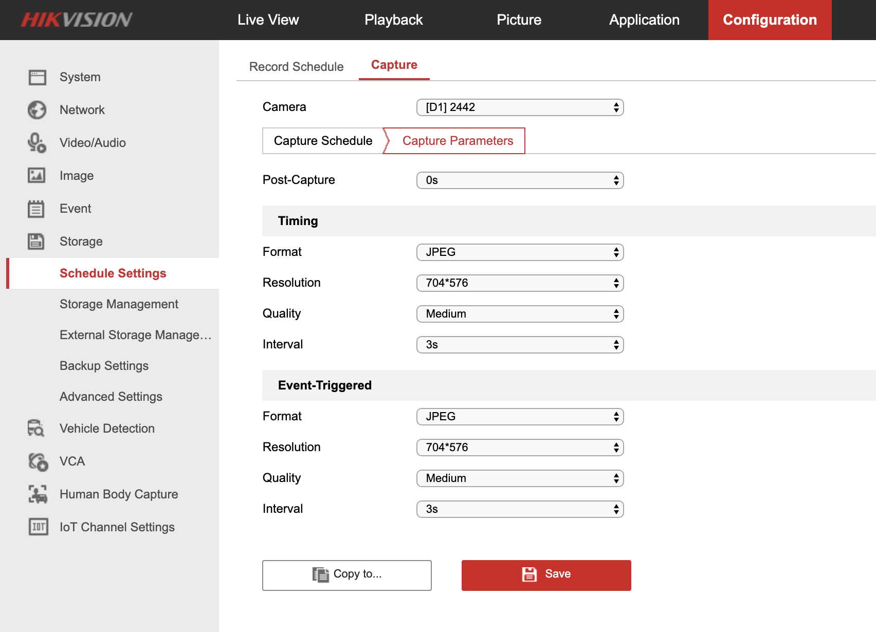

In the mean time would it be possible to reduce the snapshot size? ... I've had a look and can't see where this is set.

You need to go into the Capture settings under the storage menu on the NVR and change the Event-Triggered Capture file size. (see below)
We have been told by Hikvision that the maximum size of a file to be attached to an email is 512KB, so I assume it is something similar for captures sent to the app.

Now that you pointed out those settings - I remember I've been in there previously.
As they were 8Mb cameras I figured 704x576 would be no major issue for snapshots.
[Configuration\Storage\Schedule Settings\Capture\Capture Parameters\Event-Triggered\Resolution from 704x576 to "352x288"].

With regards to the point above from Dan - thank you for your input - the image on the Android HIK Connect App is FHD - 1920x1080 - even though the NVR event snap shot is set to 352x288 and the same setting on each camera is 3840x2160 without the possibility to scale down.
