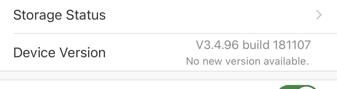

Hi, I have the exact same problem. My app states it is the latest software version, but I still encounter the same problem. Any advice?

Hi Nicole,
Whilst the problem is apparent in the app, it's not the app that's causing the issue, it's the stream provided by the NVR. The CCTV Firmware Update Check function doesn't seem to get the very latest version. You can download the latest NVR firmware the below web URL onto your PC and then upload into the webportal for the NVR (you may need to unzip it first). At time of writing the latest version is the same as the one I used and it worked: V4.61.025_220905
If you have a different NVR model then just navigate back from the above url using the links near the top of the page or use the link below to see the NVR directory:
I also did the same with each camera's firmware but it was the NVR firmware update that eventually resolved the issue - and has worked ever since I posted the findings.
