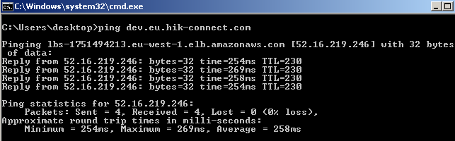

From a PC on the same LAN can you ping the hik-connect server set in Configuration>Network>Advanced>Platform Access?
Can you Telnet to the server? If not this might be firewall related.
