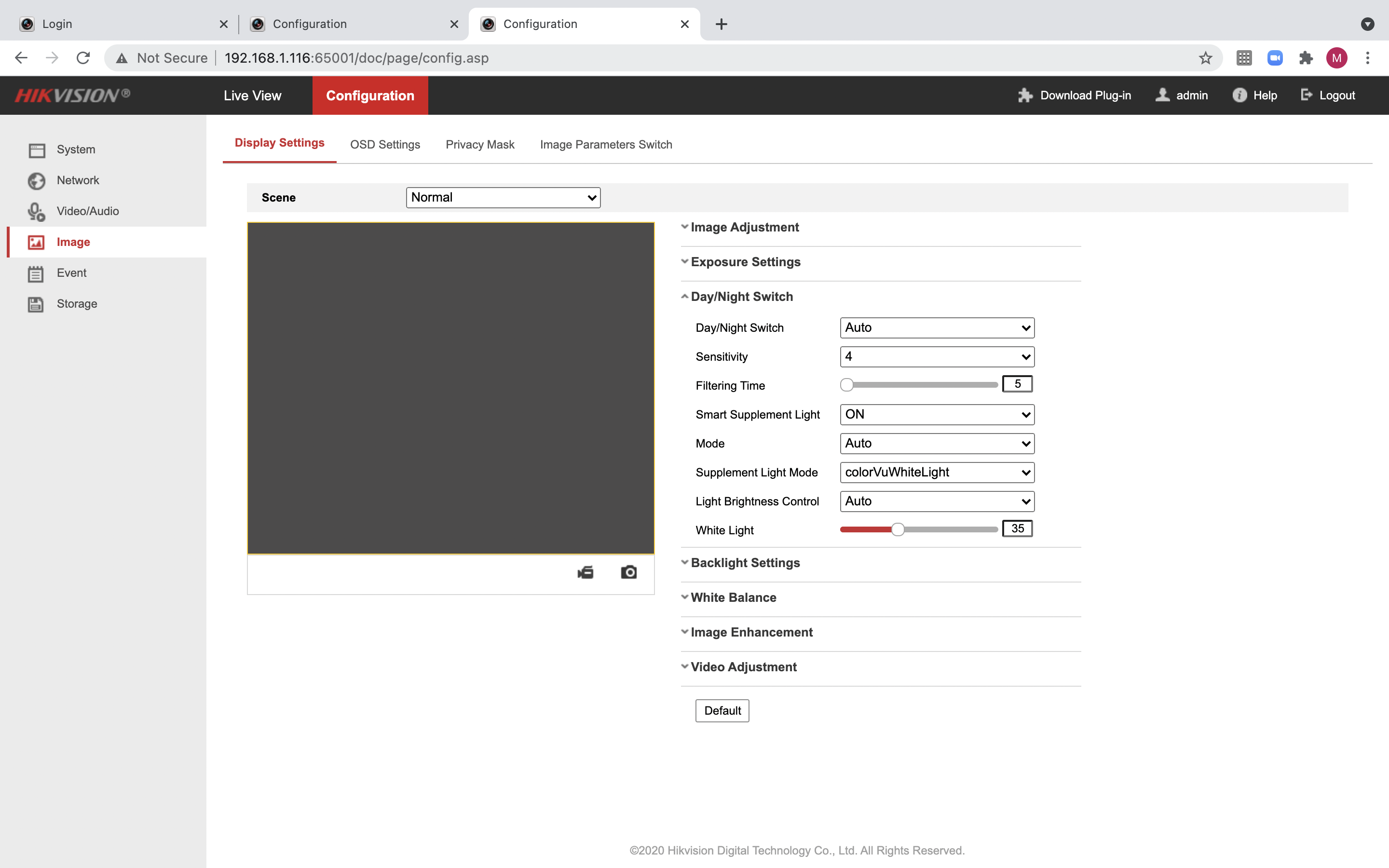

I have another quick question. I'm struggling to locate a clear explanation of these options shown in my screenshot.
It appears Hik have changed the options recently as older posts have less options than I have. Does Smart Supplement Light refer to the IR light or the LED lights on the camera? I can choose to have this set to 'ON' and Supplement Light Mode to OFF. Does this mean the IR light comes on at night, but not the LED's?

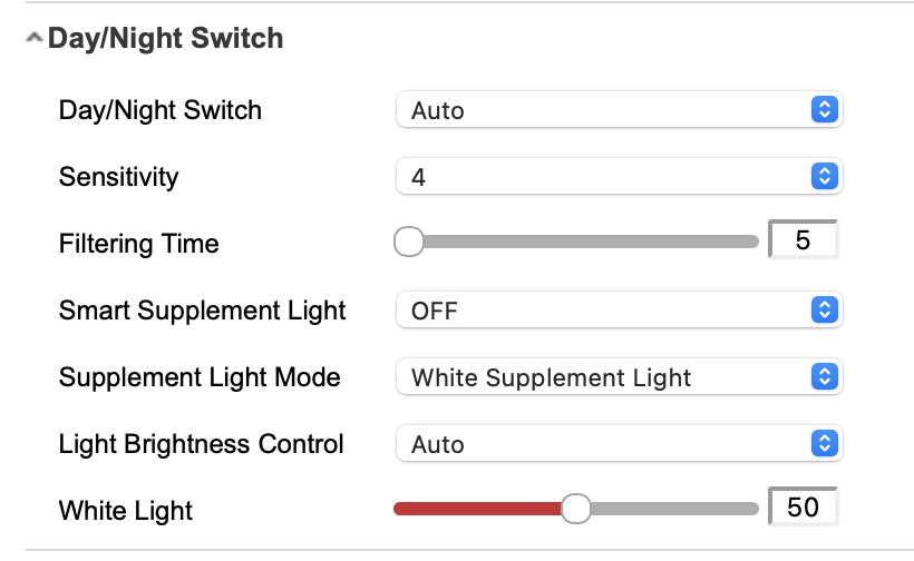

If your camera is a ColorVu then there are no IR lights - only the white LED. I believe (but am prepared to be corrected!) that if you have the Smart Supplement Light OFF then the Supplement Light Mode setting has no effect as it's OFF. I have mine set that way as I don't want the white LED on.
Mine, a DS2CD2347G2-LU (which is on firmware 5.5.160_build210416) only has the two options and no "Mode"

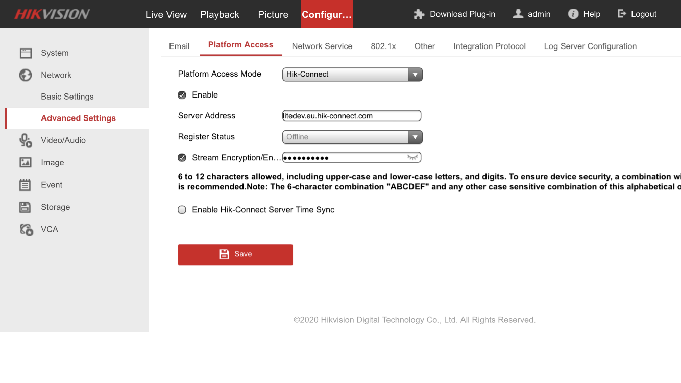

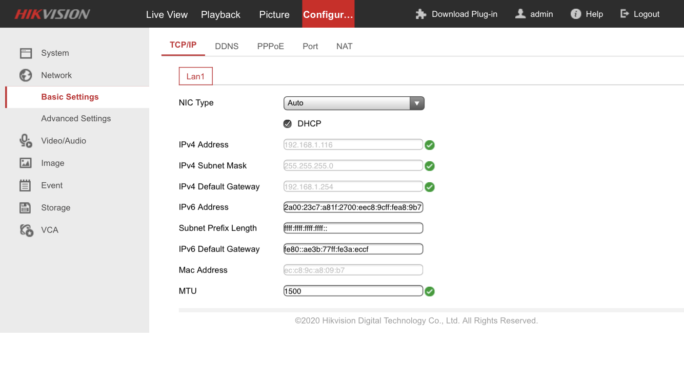

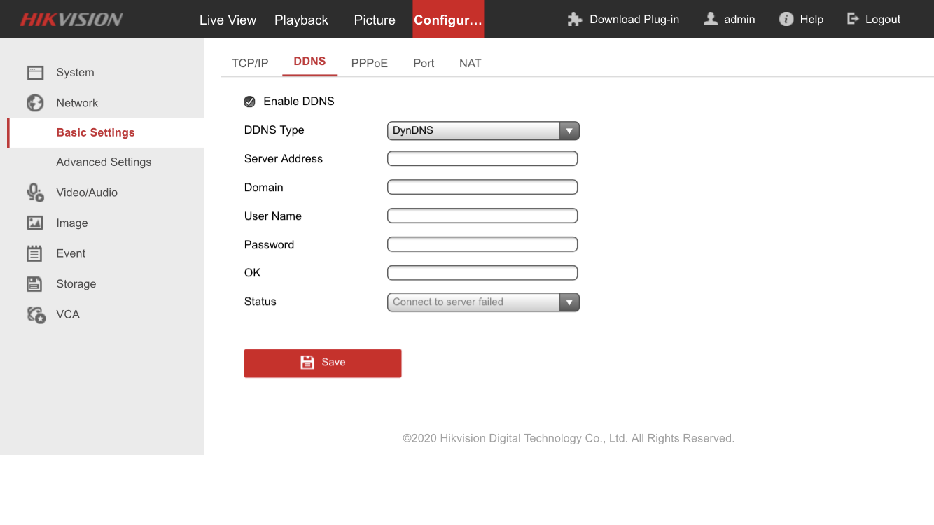

I logged in to the NVR via safari and IP address on my phone.
Under Platform Access, Register Status shows Offline. I assume this is the problem, but how do I get it back online?

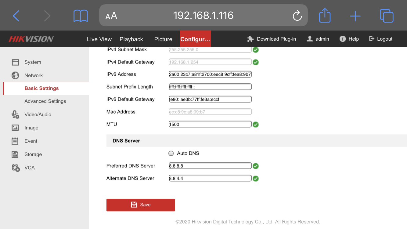

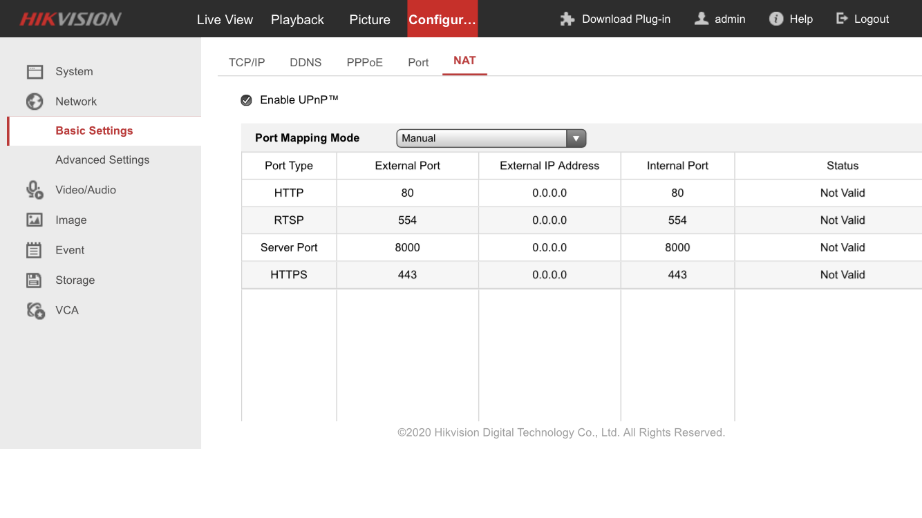

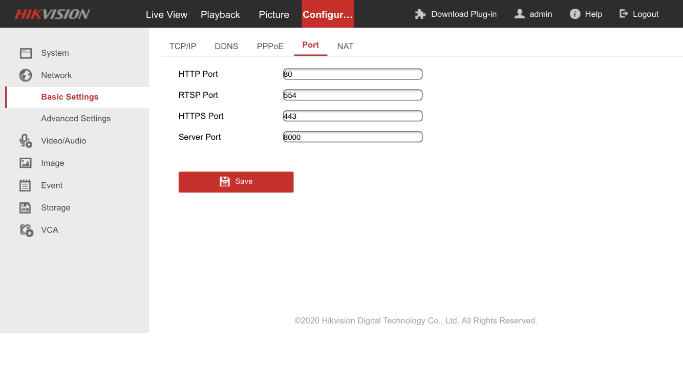

Perhaps the following might help shed some light. I'm hoping to get it back up and running on Tuesday when I'm due back at my mothers. Any ideas as to why this happened - presumably when the power went out - and how to stop it recurring? Many Thanks all.

A couple of things to note:
You should never need to re add the device to Hik Connect - you registered it once and have had it online so that’s it.
You have DynDNS enabled - you can disable it as you’ve no account details in there. It won’t do any harm but is not doing anything.
You have NAT enabled but the port mapping is showing as “not valid” This is the problem.
You have your IP address for the NVR set as DHCP so the NVR obtains an address automatically assigned by the router. This is an issue as if your router reboots or powers down it may get assigned a new/different address. Probably what happened during your power blip.
Your best bet is to assign the network details manually and switch from manual to auto in the NAT section (as the standard ports in use by the NVR clash with default services in the BT router)
I can see that your on BT internet so manually set the NVR IP to 192.168.1.250, Subnet to 255.255.255.000, Gateway to 192.168.1.254, DNS to 8.8.8.8 and 8.8.4.4

So I just switch port mapping mode from manual to auto then change IPv4 address, ipv4 subnet mask and default gateway to the values above and it should work?
Apologies for all the questions, I just want to be armed with all the knowledge before I go next week! Do I/can I change the IP addresses through the NVR network settings menus in my last post or does it need to be done through the Bt router settings somehow? I’m guessing I just uncheck DHCP and then I can manually input? Thanks again

Hopefully that should do it and it will sort itself out via UPnP. I don’t usually use UPnP and prefer port forwarding but that’s a whole different setup and would require creating a custom service in the router for the three ports and forwarding that service to the address of the NVR.
The network settings are just changed in the NVR and match those required for the BT setup - no need to do anything with the router for this setup. The BT router will normally assign IP addresses from a pool (group) of addresses when it receives a DHCP request from a device on the network and it will assign those addresses in ascending order. The reason for using the 192.168.1.250 address on the NVR is that it makes it very unlikely that it will ever clash with an address that the router assigns to another device (unless your mother has another 249 network devices)
