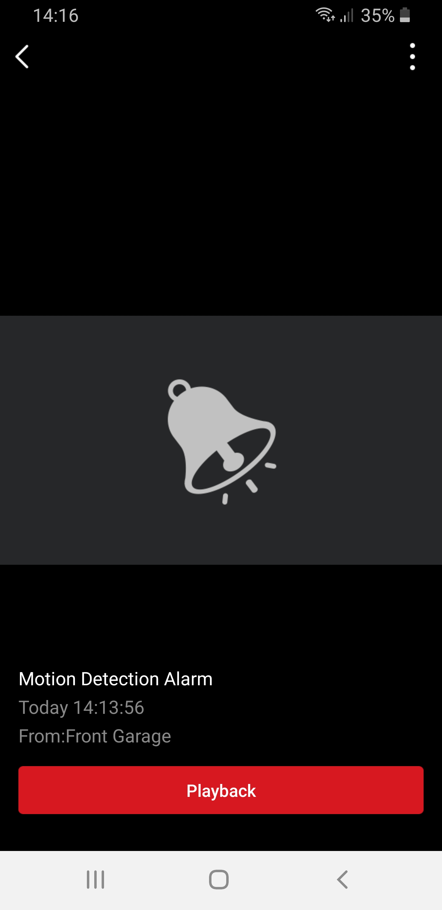

Hi, Can anyone help me with playback of my motion notifications?

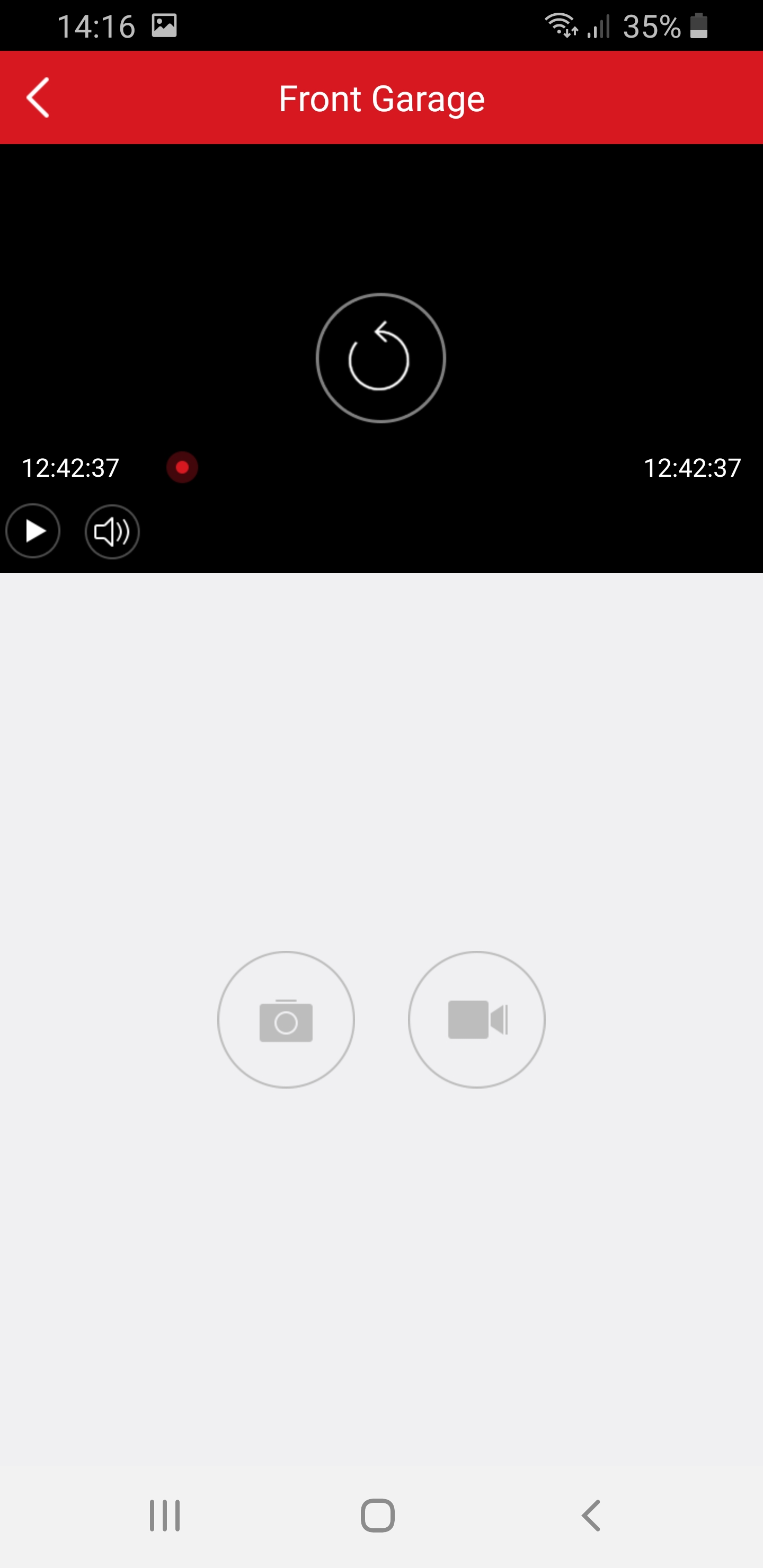

The hik-connect app pushes messages to me when motion detected but then when I try to view the video of the recorded motion it says 'no video found'. Yet my NVR is recording continuously and I can view the video if i search manually using the cameras every router ip address.

Hi, using android on samsung S9. It works as in I get notified but clicking through that notification to view the video it says no video found yet I can view that same time stamp through the same app but using my ip address? Any ideas

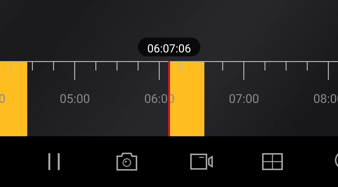

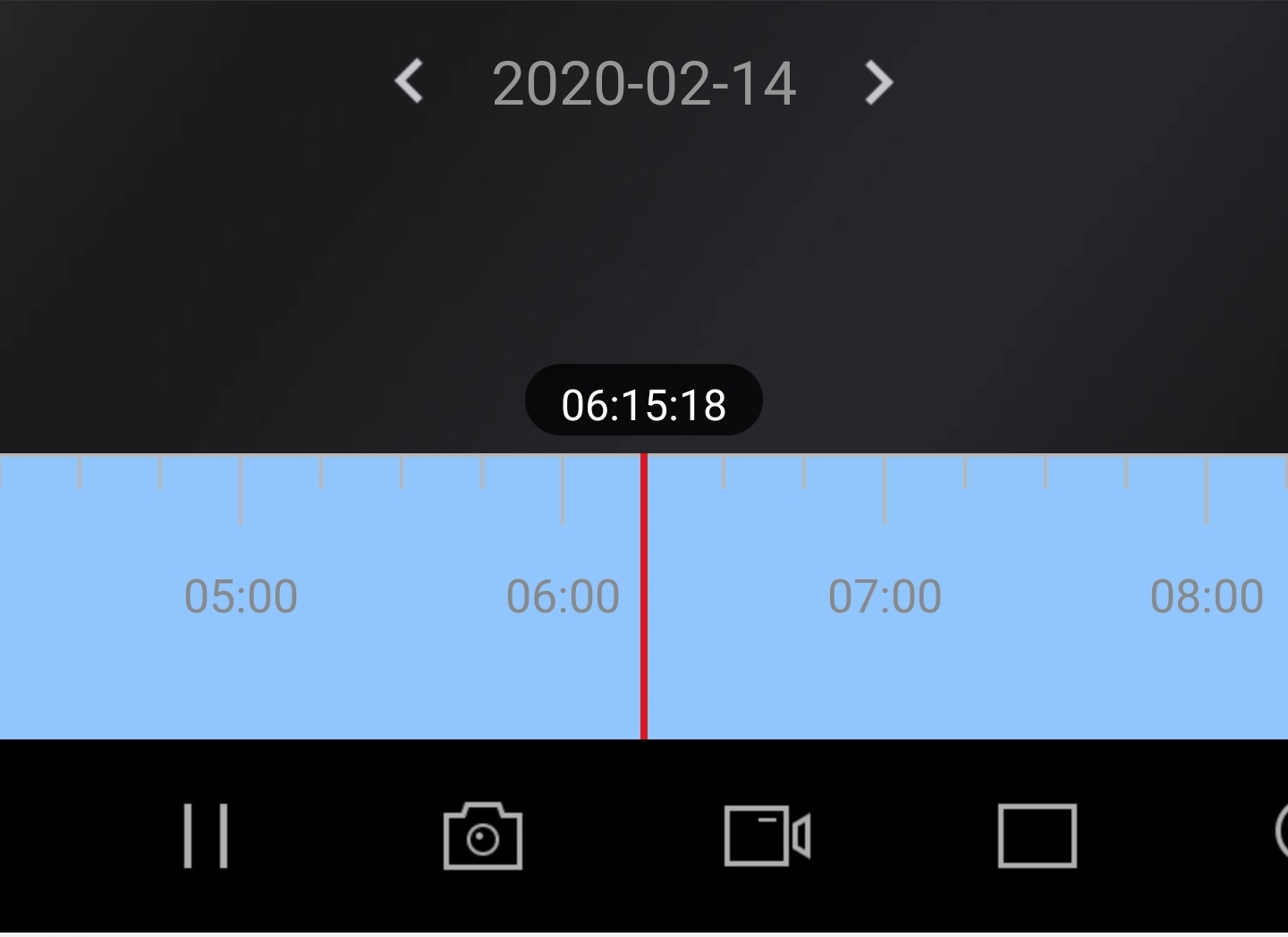

I'm using the Hik-connect app. It's as if when I'm lucky enough that a motion is detected during the yellow/orange segment in the pics above I can view the motion but outside of those recordings i cant. Yet I'm continuously recording and can view any time stamp through my ip.
