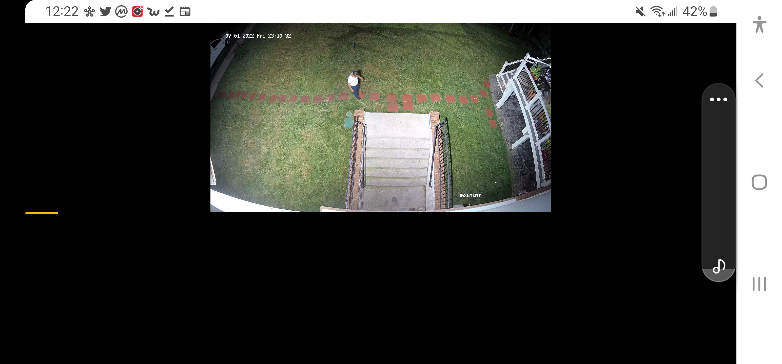

Next, I go into Notifications and mark them all as read. I then scroll through the small number of notifications that may have occurred during the night and for each one I click on the Playback icon. When holding the mobile normally, playback plays in a small window at the top of the "portrait" window, so I rotate my phone to landscape and the video image changes to landscape and fills the phone screen. However, this morning for the first time, I noticed it did not fill the full screen, but still shows the small "portrait" sized video image at the top of the landscape screen.
Anyone any idea why this is happening? It isn't very good and makes it difficult to see what is happening given the small image.
Viewing live images still uses the full screen size when viewing in landscape mode!

I have the same problem, in playback if you rotate your phone the picture did not fill up the screen.

Yes I have the latest version, problem started with this version.

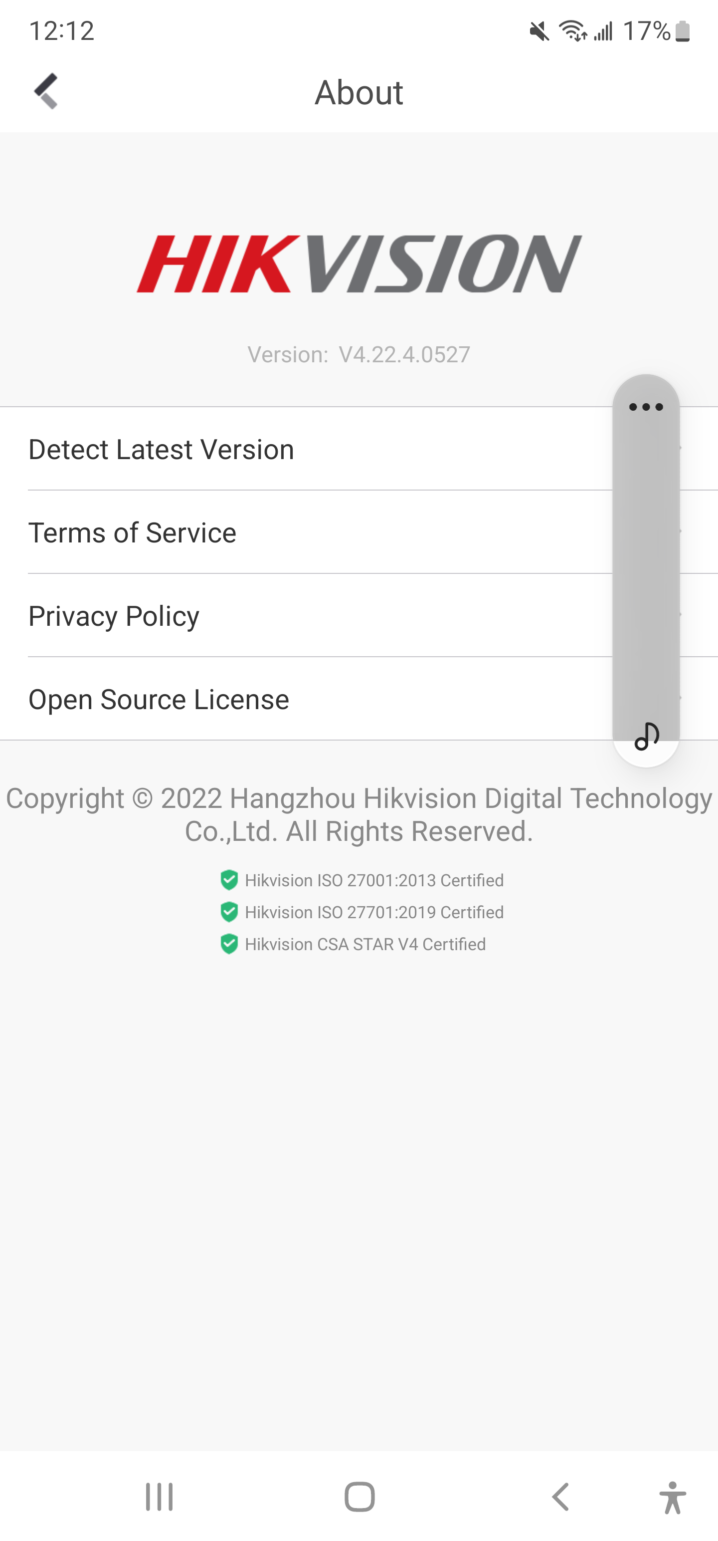

Where I can find previous version?
This is the previous version, and it works just fine.

Did you de-install the old version first or simply install the older version? Did it remember all the existing settings?
