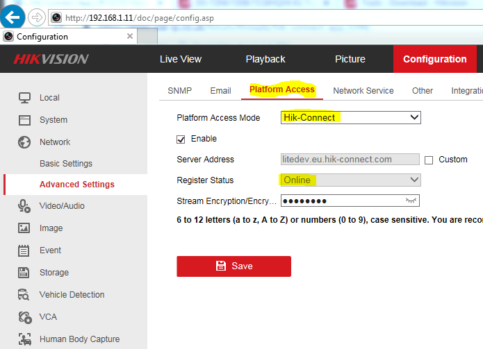

If you are using Hikvision's Platform Access (Hik-Connect) you don't need to configure port forwarding. Cloud P2P can include third party services, it's not clear from the above if you are using one.

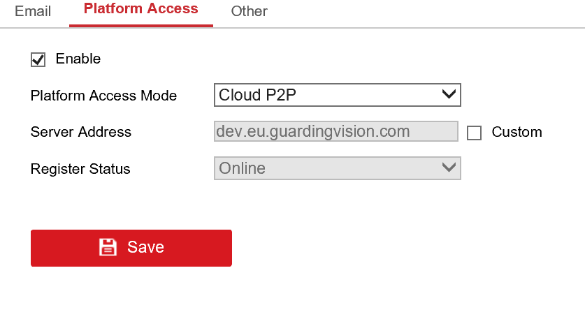

Thanks for coming back to me - I will look at upgrading the firmware - I have a HiWatch so this is a little confusing as the Systems says I have - NVR-108-A / 8P model and the manual left after installation says the model is DS-7100NI-E1.
With regards the platform access mine is set as per the below.
