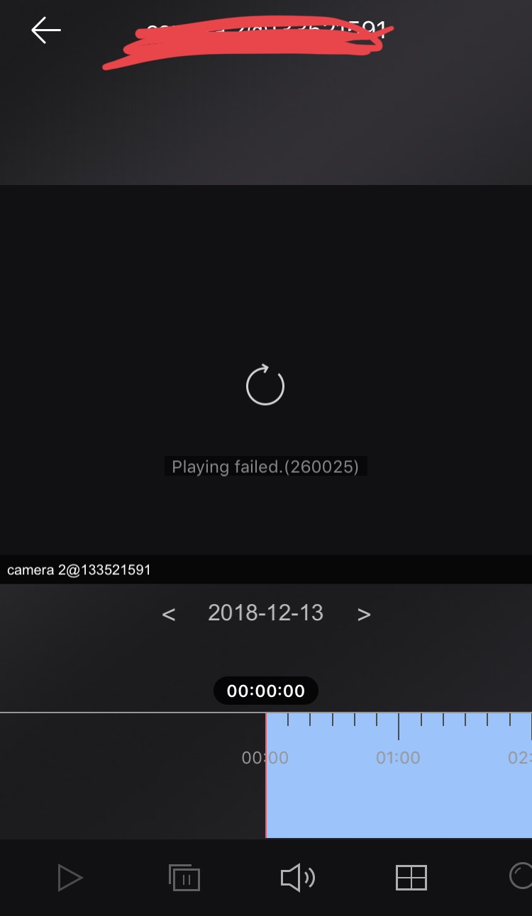

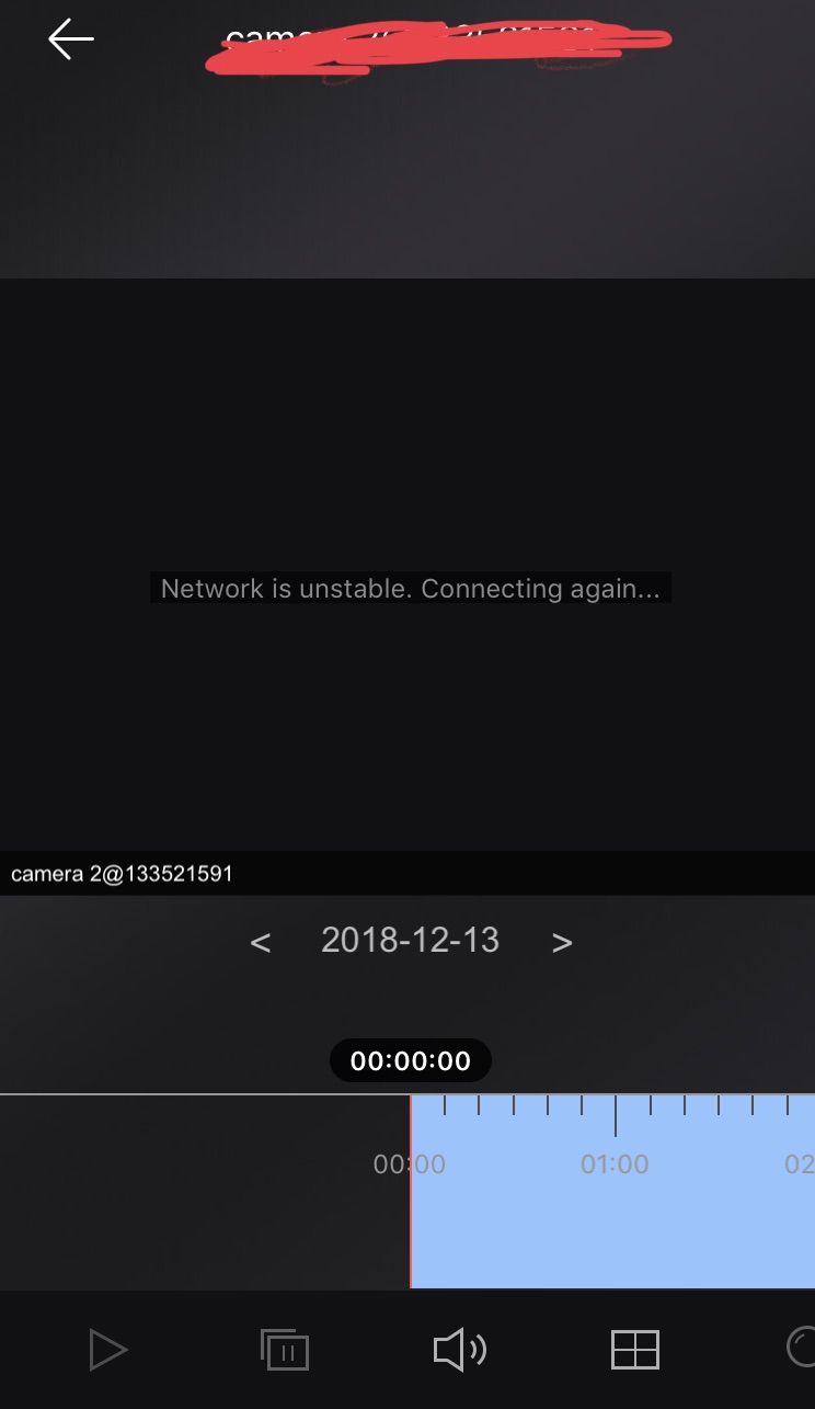

I have exactly the same issue. Just out of curiosity are you able to try it on an Android device. I have been told that it specific to iPhone. There have been two updates since this issue first started and still hasn't cured it for me. Occasionally i will get playback to work but normally I get the following error :-
  • Network is unstable. Connecting again (This happens about 85-92%) (Attachment 1)
  • Then after trying again, I get
  • Playing Failed. (260025) (Attachment 1)

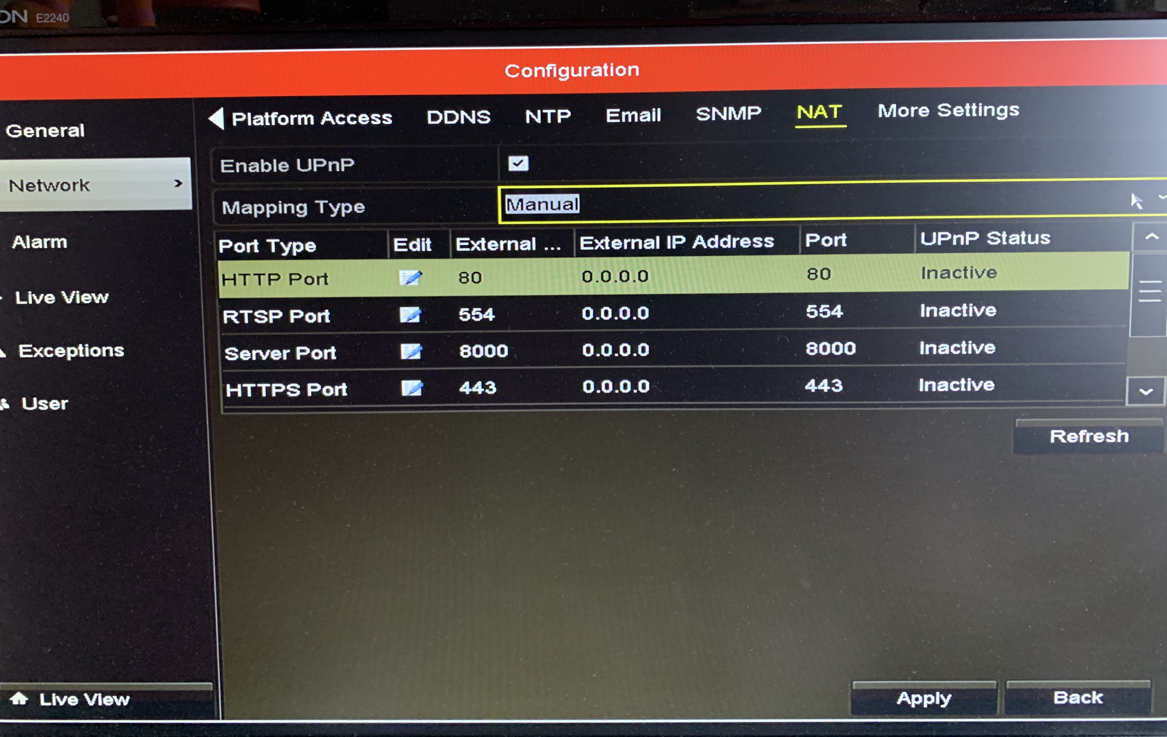

Found the issue. On the NVR
In network, UPNP
Ports are set to 80. 8000 etc on the incoming. but then they were set to really high values on the outgoing.
So I changed the drop down box from automatic to manual and the ports changed from high values to the standard 80. 8000, 443, 32404 and 45885
Which is what I have setup in my ubiquity gateway. So I can get to my Hikvision NVR from a web browser now
Found the issue.
In network, UPNP
So I changed the drop down box from automatic to manual and the forward ports changed from high values to the standard 80. 8000, 443, 32404 and

I found there are some extra hik connect command ports that have to be opened in the 9000 range can find them on the nvr or dvr(found on nvr under nat settings). Also on apple devices only had to turn on the remote ddns option in the hikconnect app and put your login details in with your server port and http port number. Worked fine after that
