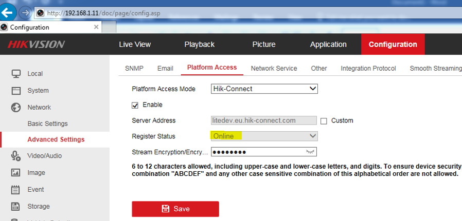

Platform Access enabled? Does the Register Status show Online?

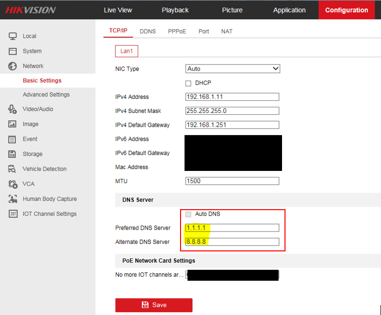

If not, go to Network>Basic Settings on the NVR.
Check the DNS settings. Try disabling Auto DNS if it’s checked and enter 1.1.1.1 (CloudFlare’s DNS) and 8.8.8.8 (Google’s).

Go back to Platform Access and check if the Register Status has changed. It may require a reboot of the NVR or force a refresh of the browser cache by pressing Ctrl+F5.

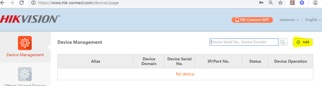

Instead of using the mobile app to register the device try this route.
Go to and create or log into your account. Click Add.

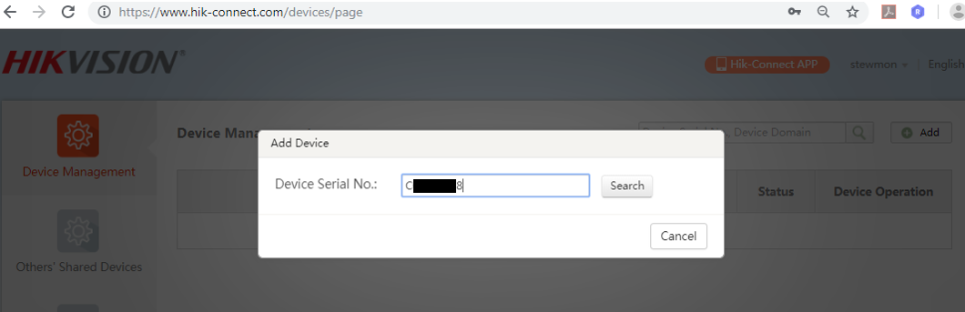

The serial number required is the 9 digit one found on a sticker on the side of your NVR box. If you don't have the box on hand, you can get it from the NVR's webGUI under System Settings>Basic Information. It will look something like:
DS-7616NI-K2 / 16P1620171216CCRRC00335828WCVU
The 9 digits required are usually in the position I've highlighted in red.
Enter the nine digits and click search. Let me know if it finds your NVR.

I accessed 'Platform Access' and 'Enable' was unchecked - so I checked and was asked for 'Verification Code'. I don't know what that is? The register status shows 'Offline'.
Basic Settings does not seem to appear on the HiLook interface but I found the DNS unchecked the 'auto' and input 1.1.1.1 and 8.8.8.8 Apply. Went back to Platform Access and status is still 'offline'.
Also checked into my account and Device Management on Hikvision and still get a negative when I try 'Add' for my serial number. The serial number is quite clearly marked on the base of the HiLook NVR's.

Bingo - added a verification code and 2 QR codes appeared which added the 'Blue' HiLook App (not red HikConnect) and then the camera so I have a picture. However I now have concerns.
