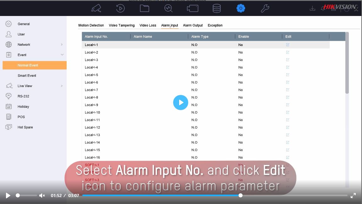

Hi Kyle,
On the Hikvision site there is a video , I have a snapshot of it, see attachment.
I don't know what the firmware is of the snapshot but "Adam access" is missing in the menu.
The latest firmware version for the i-series NVR is 5.1. How can I be sure that the "Adam access" option is available in the menu?
Gr. Johannes

You have to go to download Portal hikvision FM2466 Alarm Module. Download the firmware. Series acusense, I, and M series. after firmware update in your nvr you see the alarm extension in the nvr additional in event.
