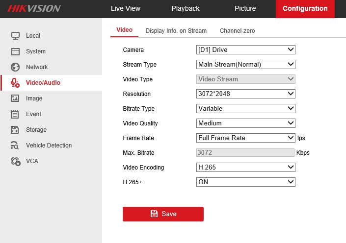

I have my DS-2CD2355FWD-I 's recording at a high quality. When I go to Playback under the web interface (IE11) the video seems to be fairly low quality, for example, I cannot identify a person's face about 2m in front of the camera at 8pm (dark). Does anyone know what i'm doing wrong? I presume there is only 1 video saved so I can't just flick to HD?

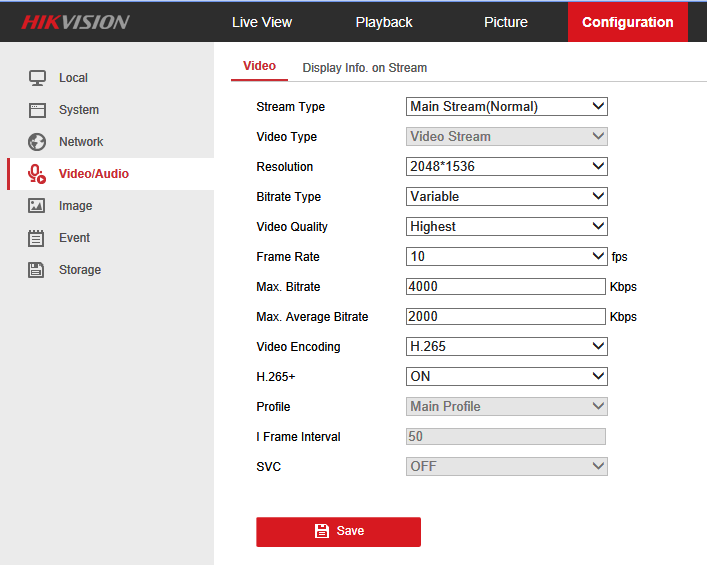

Perhaps share the image and your video settings:
(these are for a 3MP camera)
You'll see that my Video Quality is set to Highest, and yours is set to Medium.

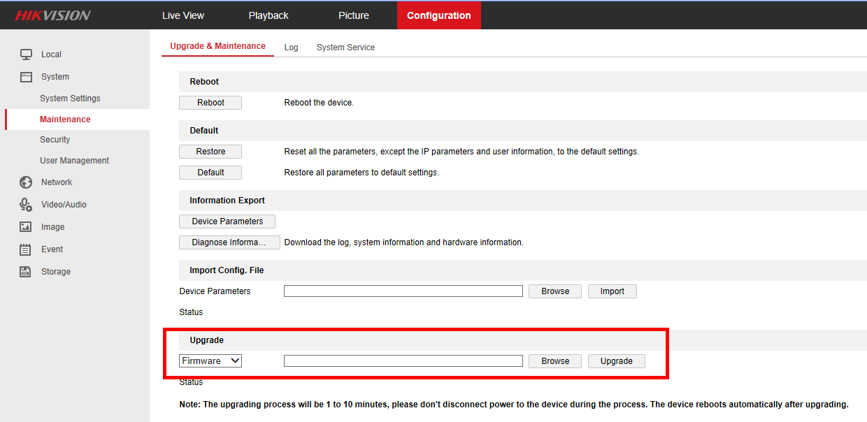

I've been reading your guide on updating firmware, am I right in saying you update camera and nvr firmware on the same page?
You need to access the Maintenance page for each camera and the NVR to upgrade its firmware:
Ah, so each camera has it's own web UI too, i've been accessing everything through the NVR web UI. I'll try that tonight
Yeah they are, and I can't access them directly via IP address, i'll give that a go
Cams were all on 5.5.3, all updated now.
Thanks for your help!
