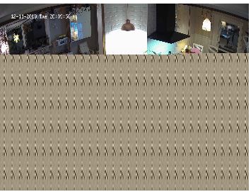

I have a DS-2CD2155FWD-I.
When I choose anything higher than 1280*720P I get picture error on the sub-stream, see my picture. Since I bought a 5 MP camera I want to use the highest resolution 3072*2048 but I also need the sub-stream for my alarm detection/verification system. If I choose 1920*1080P there is a smaller error, and then higher than that it is the same fault on all levels. I have tested to change Video quality with no luck. I just updated with latest firmware 5.5.80 but no difference.
Are my camera to weak for its own specs? I was just on my way to order a couple of more but seems like I need to rethink that...

I think I found one problem… the path "102" I gave does not seem too look at sub-stream anymore, it looks at the main stream!
I have noticed that no matter what channel I use I always look at the main stream. The reason for the crappy picture I attached is because the alarm only support 640*480.
