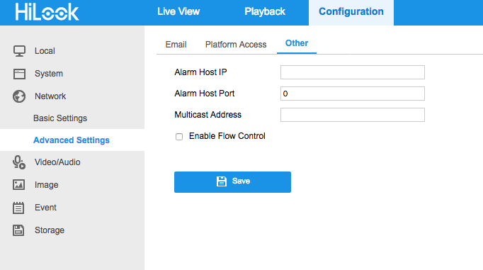

- I would like to enable the ability to connect to the PoE powered cameras but this virtual host option is not available via the web interface

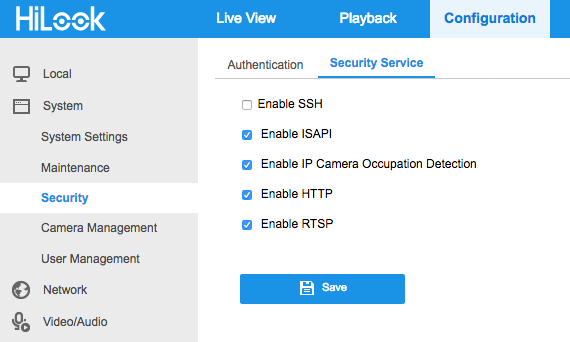

- I need to take a live snapshot from any of the connected cameras - I cannot configure the second stream to be MJPEG and all attempts using various /Streaming/channels/102/snapshot or httpPreview or picture don't work.

Just to clarify, on the NVRs webGUI in Network>Advanced Settings>Other do you see a option to enable Virtual host? A screen capture might help. Perhaps the webcomponents plugin is not properly installed.
What error do you receive when trying to take a snapshot? I suspect you need CGI enabled under integration protocol to remedy this. Which browser are you using?
Thank you Stewart - yes although I don't have access to a Windows PC I am able to run the GUI (and the live and playback video is visible) on a Mac with the Seamonkey browser - here are screenshots.
Even if I provide admin:<password>@ before it
Returns the following
Access Error: 404 -- Not Found
Can't open URL
<ResponseStatus version="1.0">
<requestURL>/ISAPI/Streaming/channels/202/snapshot</requestURL>
<statusCode>4</statusCode>
<statusString>Invalid Operation</statusString>
<subStatusCode>invalidOperation</subStatusCode>
</ResponseStatus>
I tried channel 201 also and capital C for channel.
Finally the suggested option to set the sub stream to MJPEG doesn't appear as an option - it is greyed out
Appreciate any help
Best regards
Ian
