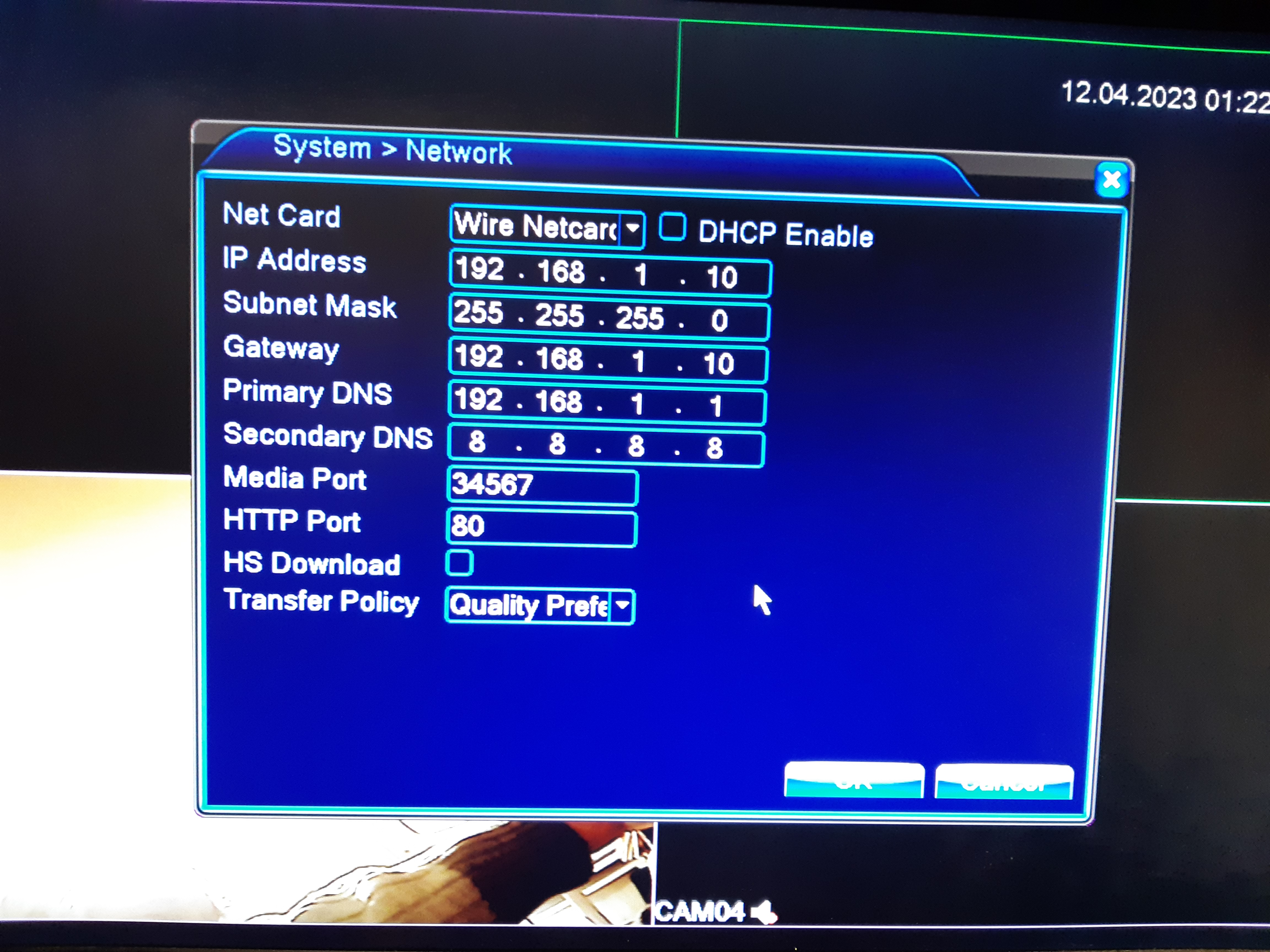

The virgin hub default IP address is 192.168.100.1 so your DVR needs to join that network. Your software guide says the DVR IP address is 192.168.1.10 so is isolated from your current network.
From the monitor connected to the DVR goto network setup, send a screenshot of what that screen shows.

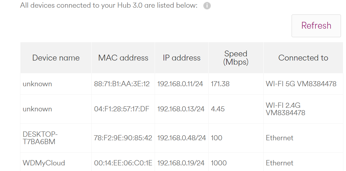

To get the Virgin hub details I enter 192.168.0.1, enter my password and get the virgin pages one of which is
Even with the DVR on or off?
It shows the desktop which is my other computer but that is also off (though I have seen motherboards with a light on when switched off but still connected to the network).
I have been altering the ip addresses in the following shot so they may not be defaults.
This is the shot you asked for
I did try altering the ip address in the second line above to 192.168.100.1 but my opera browser (the one I am using to send this) says it can't connect to that.

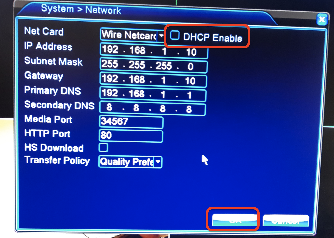

Hi Bob,
see my attached image and enable DHCP, click ok. You may have to restart the DVR. post another screenshot of the network page.

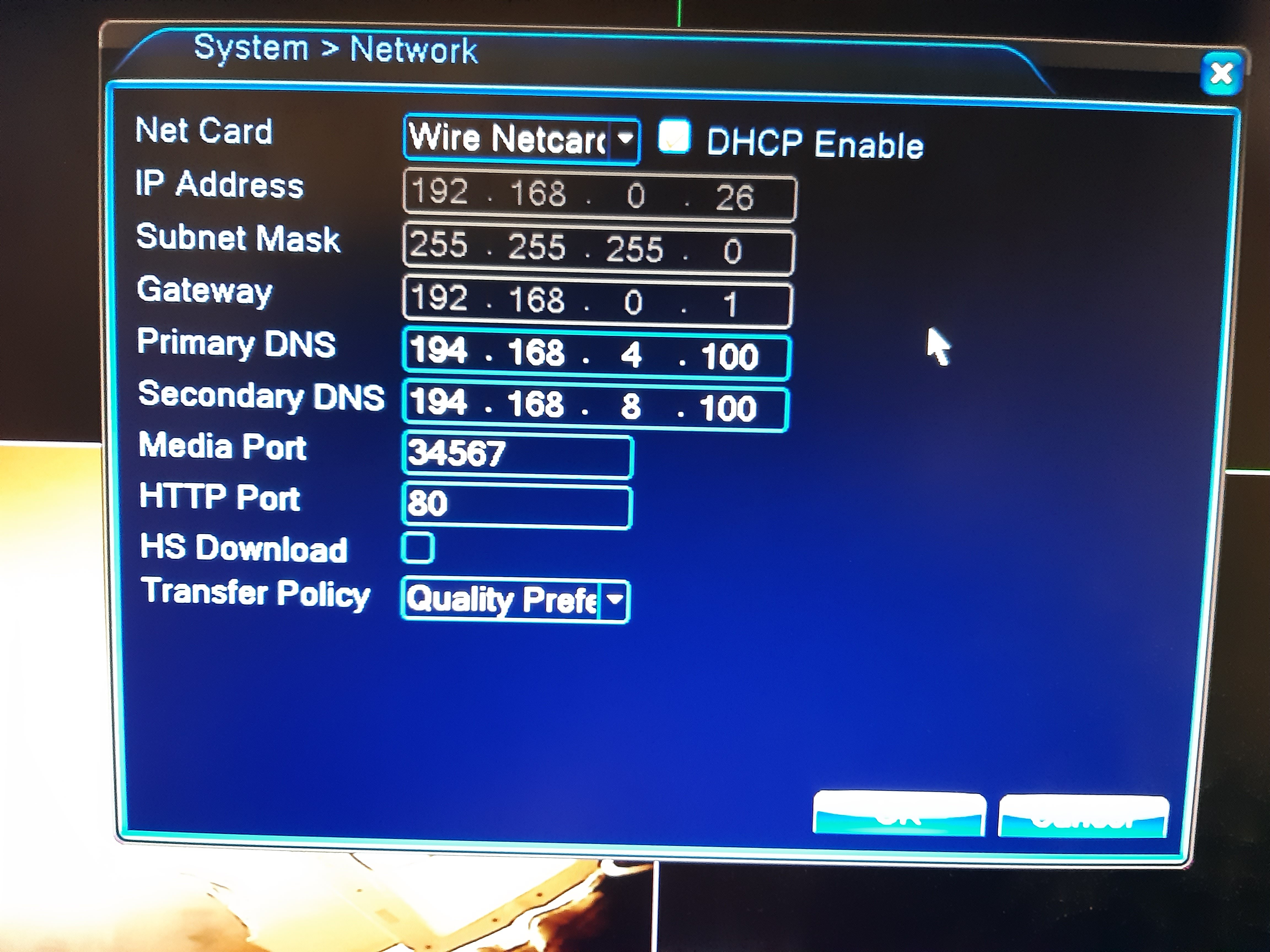

Is this the shot you want? I notice the DNS box numbers changed when I restarted the unit.
Bob

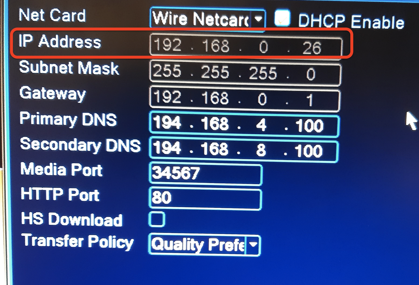

perfect.
From your computer browser you should be able to access the DVR web page via 19.168.0.26.
The DNS addresses are probably coming from your ISP.
David
